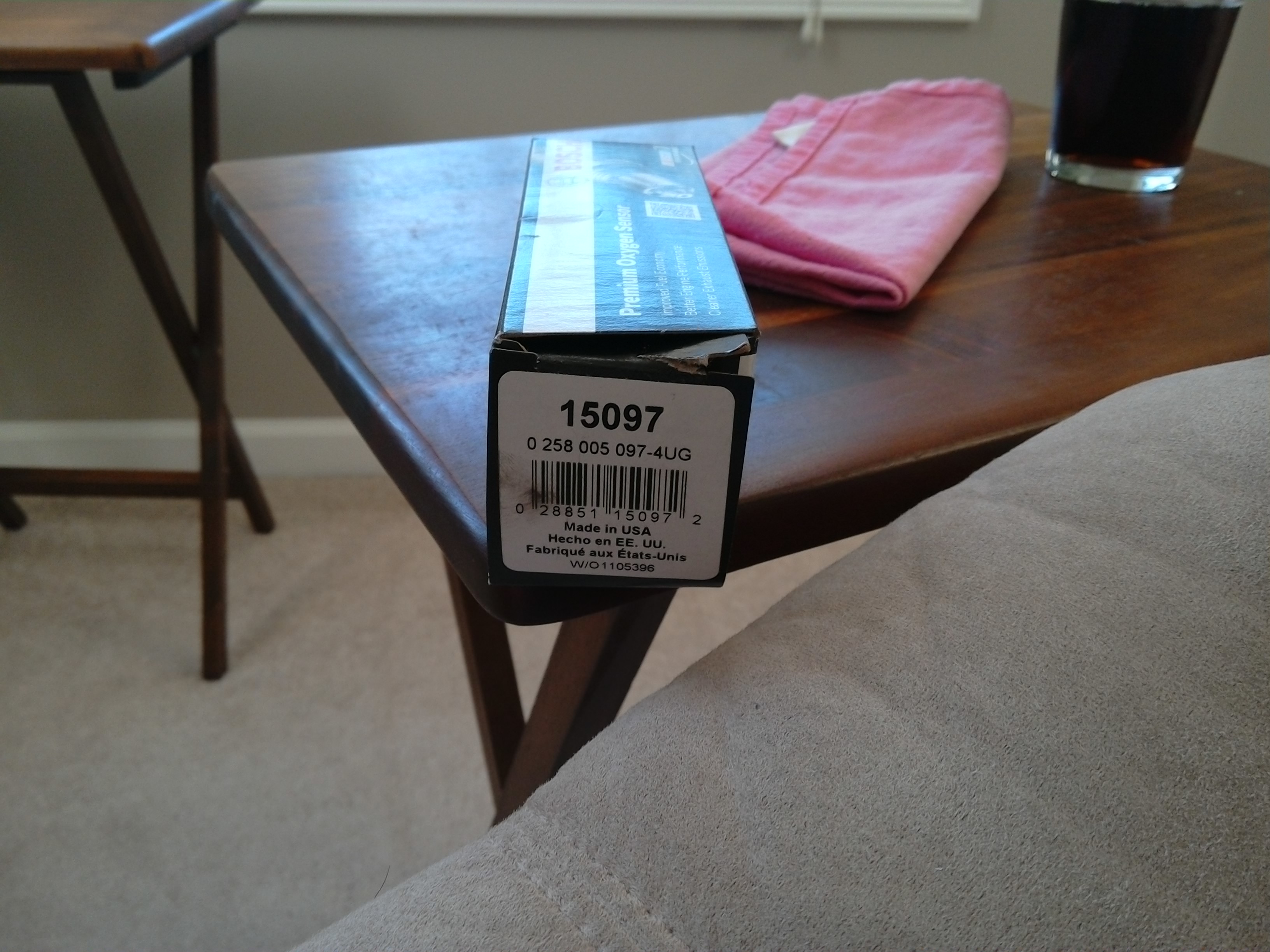

Got an O2 code, don't remember what it was, I think it was for the rear. Replaced front O2 sensor with Bosch from FCP as I read that is typically the one to fail. Now getting P0133. Should I replace the rear as well or is there something else going on?

Did you get a 15097 for the front O2, the direct fit one?
If so, time to start looking at some of the other causes of O2 codes: wires and connectors to the sensor, vacuum leak (intake), exhaust leak, fuel pressure (I think pressure too low will give p0133, check the FPR).

Yes it was the Bosch from FCP. So the code is for sure for the front sensor? Hmm.
