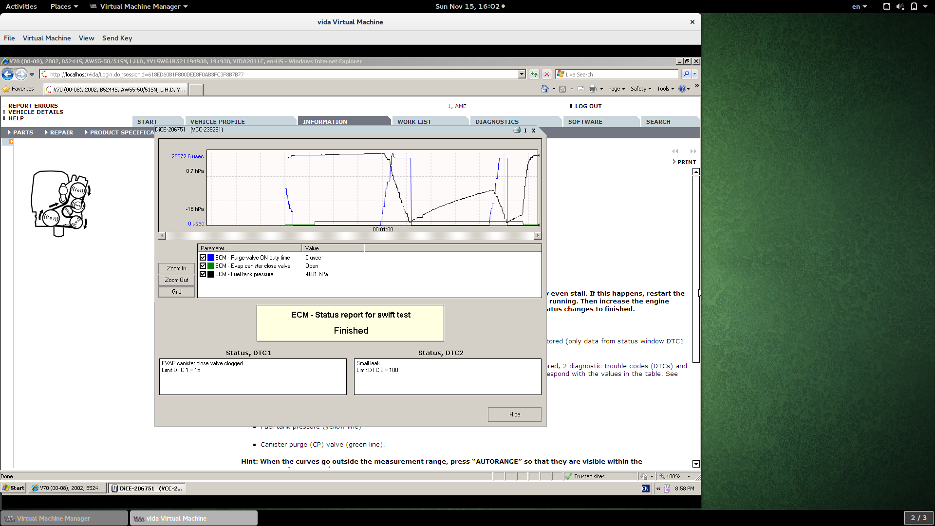

So, first time in life, failed inspection :) VIDA showed "evap monitor not ready". I did a "quick fuel tank test", and it showed a small leak:
Engine had difficulties with idling through the test when the pressure in a tank was dropped the most.
No I'm trying to figure out what needs to be replaced...

So how I understand the situation:
- the purge valve works, because pressure in a fuel tank drops when it works
- J hose was previously replaced and does not have cracks in usual place
- canister is not generally known for cracks (?)
- the pressure drops slowly with the shut-off valve off (green line is high) and drops much quicker with the valve on
So, looks like the purge valve is the culprit?

Found one leak...
Ran the test with 10-years old fuel tank cap from 2005 XC70, and it showed "20" instead of "100" (whatever this number means). Accordingly, the tank was dropping vacuum much slower. Two new caps put on order.
