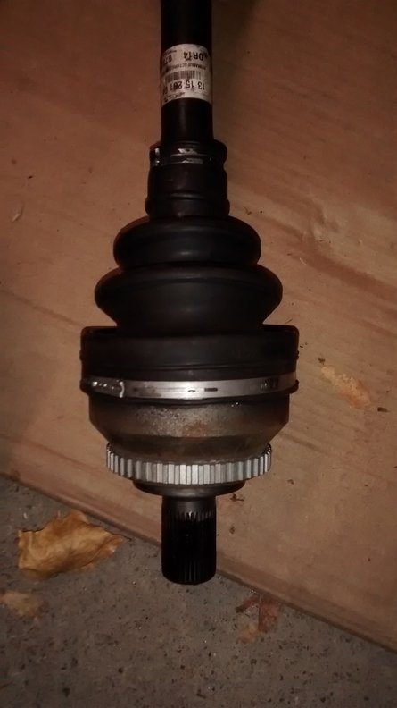

Sourced through FCP 2 months and 4k miles ago:
CV boot is pinched. It has a thickness of condom, maybe two condoms (low quality parts used), so I was not surprised at all. Previous rebuilt axle had a snapped bolt inside (no quality assurance). Then they sent a new $59 worth Chinese axle, because they didn't have a rebuilt OE axle in stock, but still priced it at full cost, including core charge (fraud and no respect to customers). The very first axle I've got from them is still alive and it has GKN or some other higher quality boots, so apparently they cut production costs (effective management).
Dry CV joint is all I need a few days before 1400 miles trip.
Two lessons learned: avoid non-OES/OEM aftermarket parts, and Tasca has a greater variety of OE parts, lower prices and same fast shipping.
USA Industries axles are unworthy

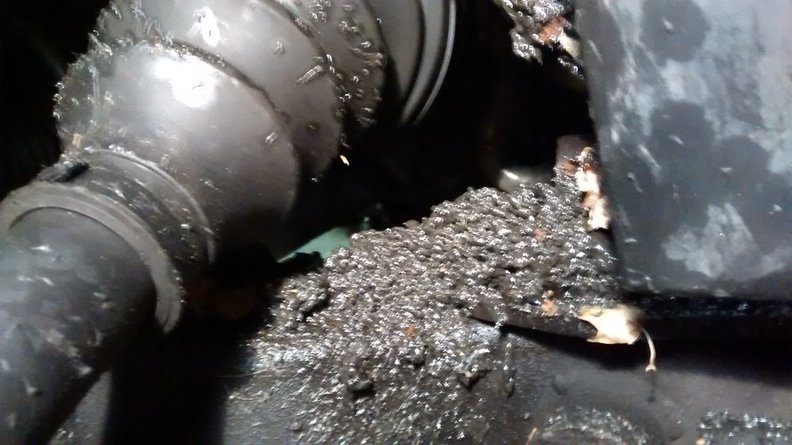

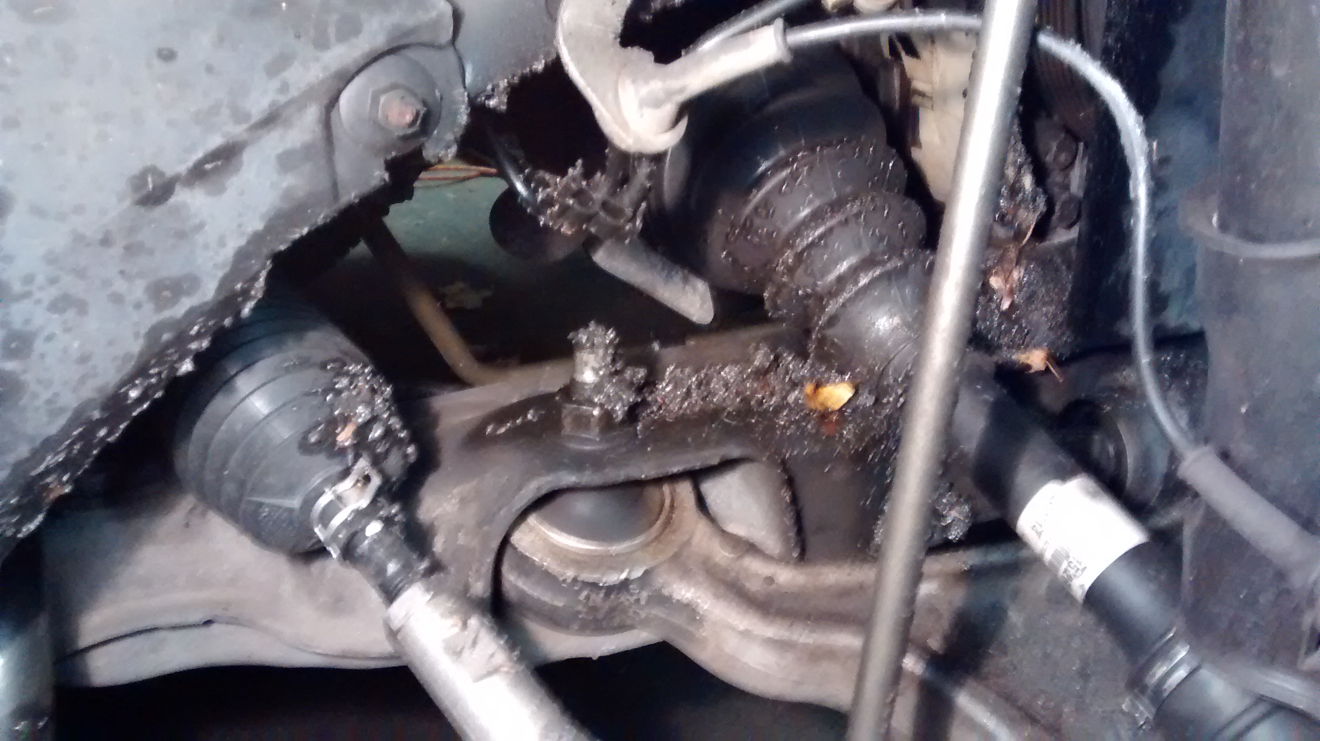

Just curious about the pictures, is that grease spewing or metal bits?

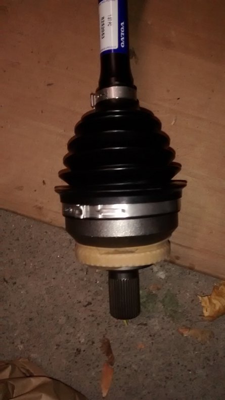

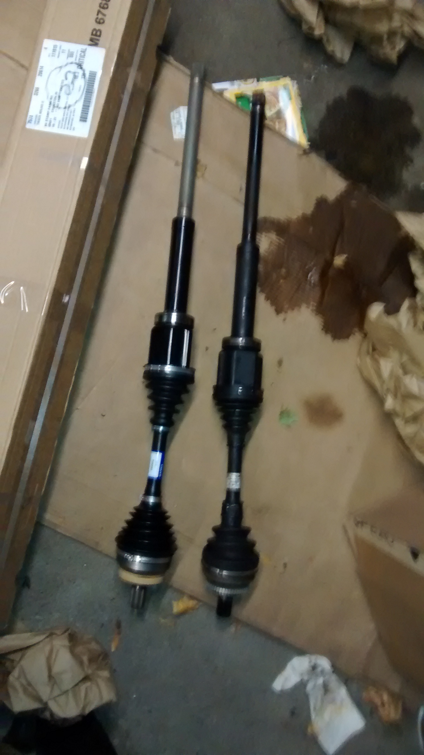

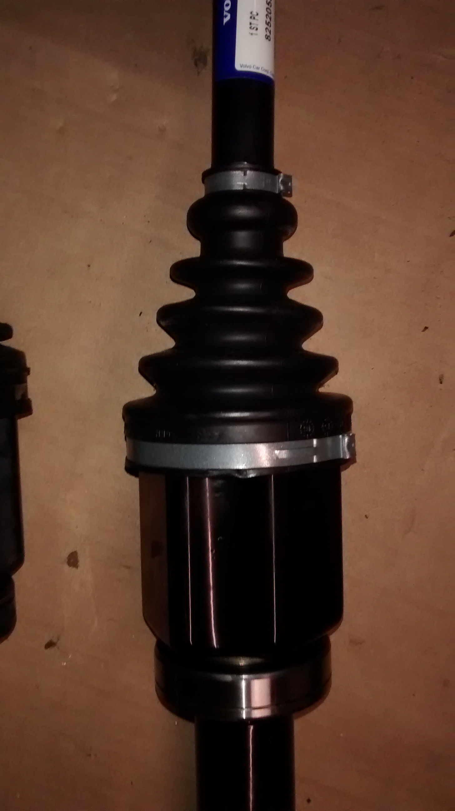

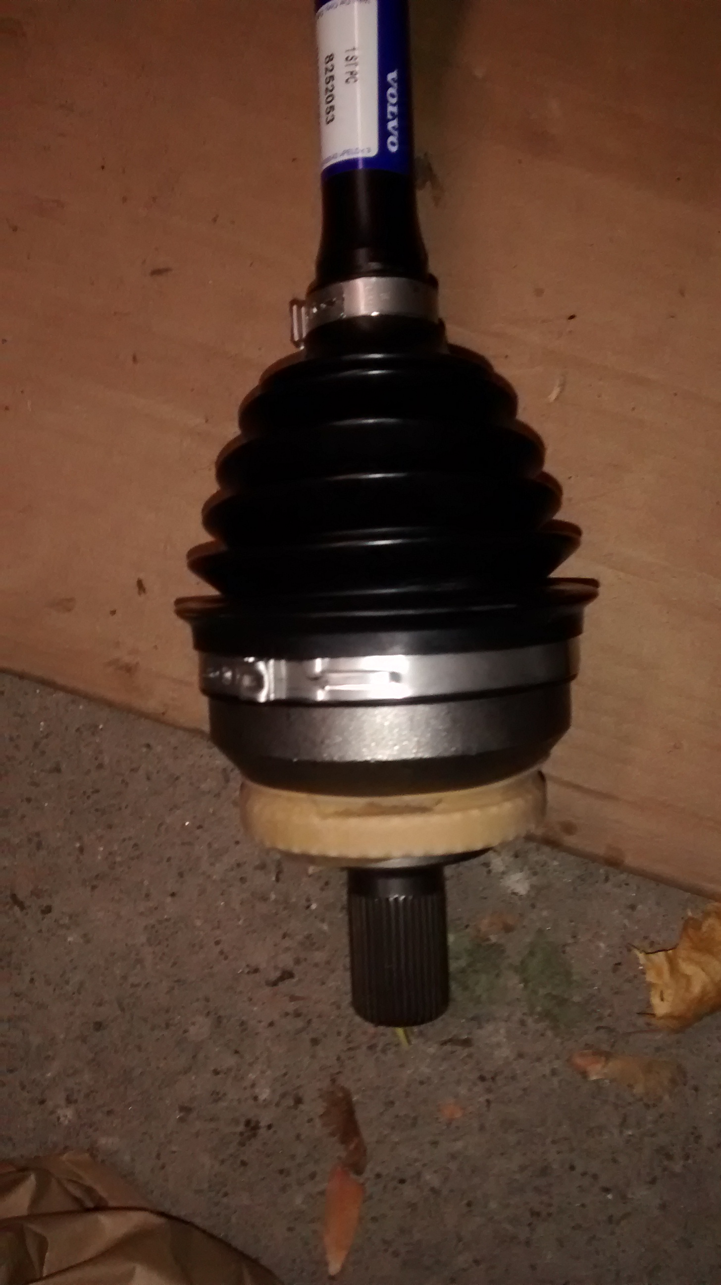

Replaced... One hour to take old axle out and clean all the mess it did, and another 30 minutes to put new axle in. I did a few pictures:
Rebuilt by USA Industries vs Volvo rebuilt:
Volvo has GKN Lobro boots and thick clamps:

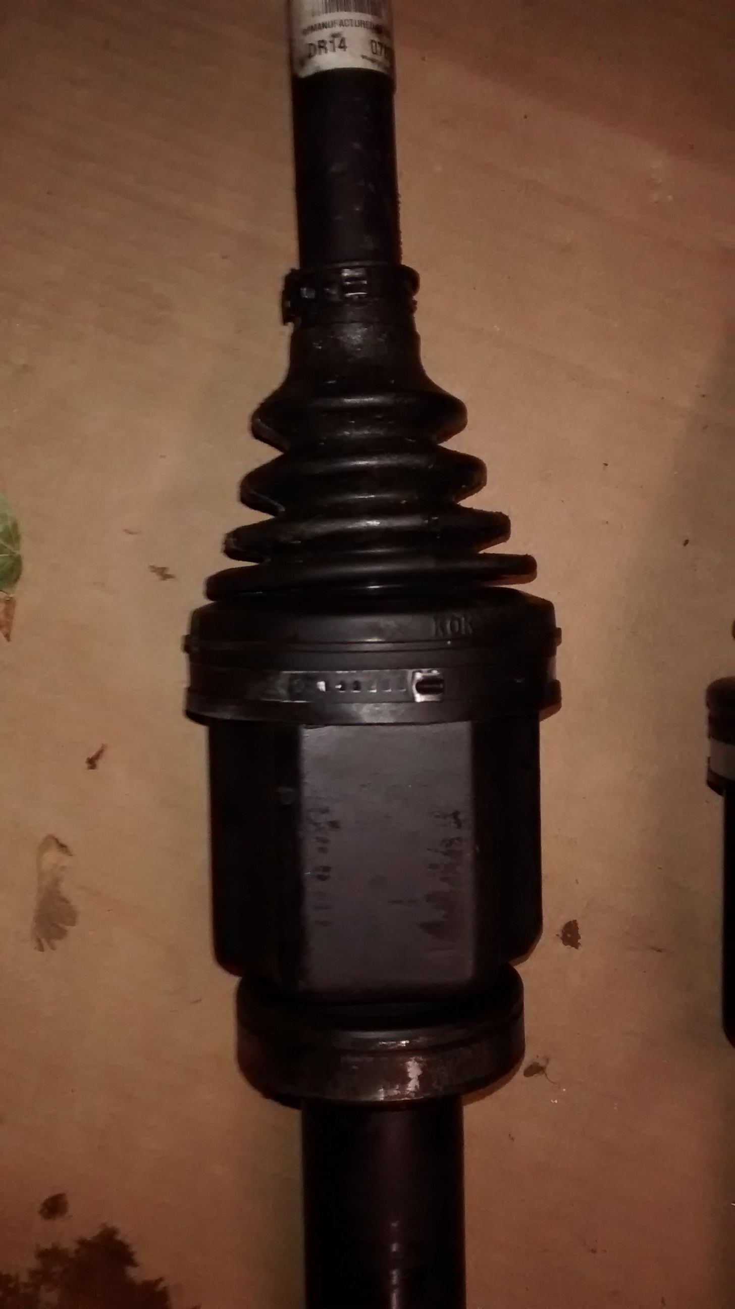

USA Industries - KOK boots and thin clamps. I actually didn't see a hole in the boot, it could be that the grease just escaped the clamp.

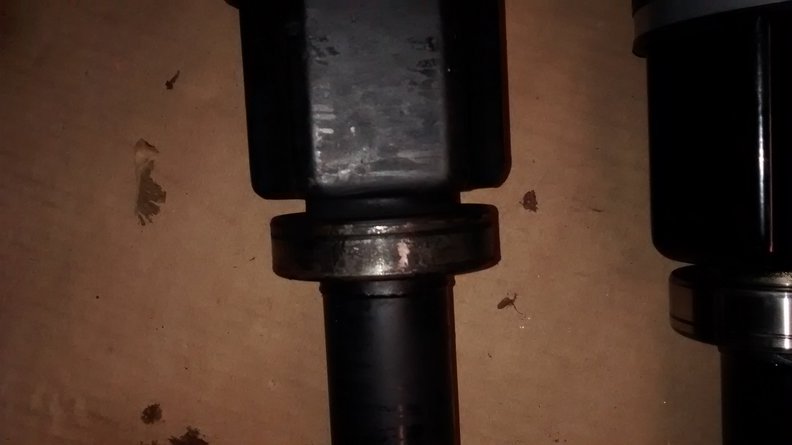

Carrier bearing is already dry, only two months in the car! When I replaced bearing in my wife's car with cheap $15 bearing, it was more tight than this when I took axle out after two years. Also notice it was installed upside down...
Volvo axle was carefully packed, ABS ring and axle's end were covered and protected. USA Industries sends axle alone in the empty box, it is flying free over every bump. Box always arrived crashed and partly open.
