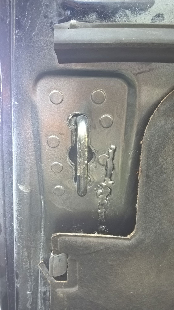

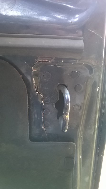

Hey all, was wondering if I could get some advice from you all.
The hood on my wife's S70 is "broken." The hood closes and locks down. But when you pull the cable release from inside the car, the hood clicks open from the right and the middle hood releases, but the left (or driver's side) doesn't release. So I read up on how to open the hood (have someone else hold it while you pull the lever or use a wedge of cardboard to apply pressure on the hood while you pull the release cable) and I can usually open the hood. However, I think the previous owner used to open the hood by yanking on the hood as hard as he could.
This is what it looks like...
So my question is, how do I fix this? Anyone have any experiences getting someone to weld this? (And if so, where does one go to have something like this welded?) Or is the only solution to get another hood somewhere? (Those are expensive, no?) Please tell me I can use something simple like JBWeld! Thanks everyone!

Look in the Yellow Pages under welding, or better yet, auto body repair. Get someone who can heat sink it so the paint isn't toasted where this structural part meets the hood skin. Also lubricate and adjust that latch.

Go to muffler shop, they weld it for $10-15...

Wetted towel on hood outer surface and MIG weld the inside in 1/2 long sections with a couple of minutes cool time between 1/2 welds.
NO NO NO to JB Weld. If you do that it will not work and then welding may not adhere and you'll need a hood.

Thanks everyone. I'll search around for a muffler shop and see what they say. I doubt they'll do it for $10-15. (No one does anything for $10-15 around here!) I'll post an update when I get it!

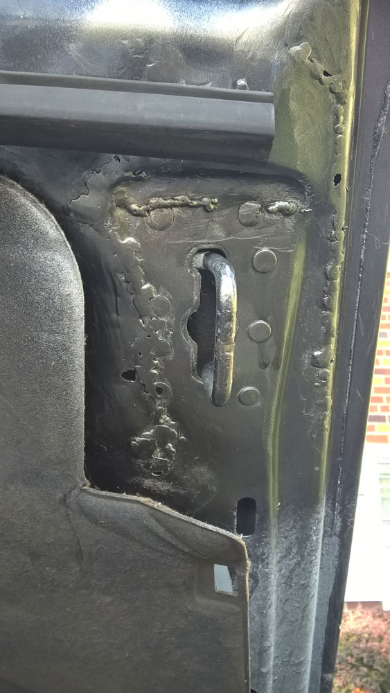

RESOLVED!
So I finally got this taken care of. (Yes, only a year later...) The welds are ugly... But at least the paint wasn't burned in any way on the top of the hood. And, the hood closes with certainty now! Except it still doesn't open easily... The driver's side gets stuck and you need two people to open it. Is this a community building feature built into our P80s?
I suppose I need a new cable and need to adjust it no? Here are the final pictures.

It needs to be adjusted before you buy a new cable.
The ghetto trick is as follows:
The hood needs upwards pressure to pop open so get some of those large (at least 1" in diameter) furniture leg stick on's.
Stick a couple on top of each other (2-4 depending on how think they are), then stick it on the radiator support where it's closest to the hood. That should give it just enough force for the hood to pop open when the cable is pulled!
