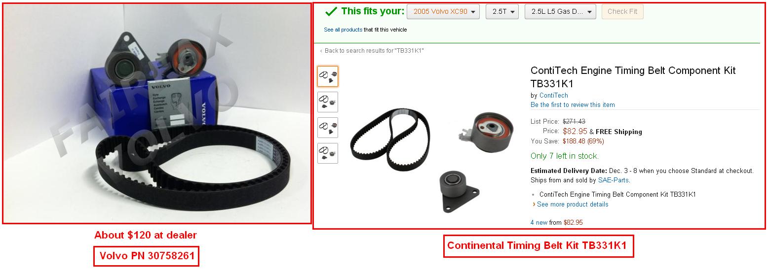

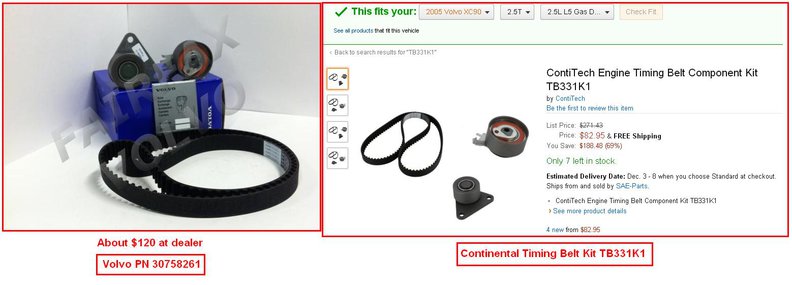

Hi guys,
For my 1998 Volvo S70, I use Conti timing belt for the last 15 years without any issues b/c Conti makes the TB for Volvo.
For my 2005 XC90 2.5T or any Volvo model out with 2.5T engines, has anyone here used Continental CRP TB331K1 ($82)?
For comparison purpose: Volvo PN is 30758261 ($120 at dealer).
I assume these 2 kits are identical, obviously the money is less for Continental CRP TB331K1 ($82).
