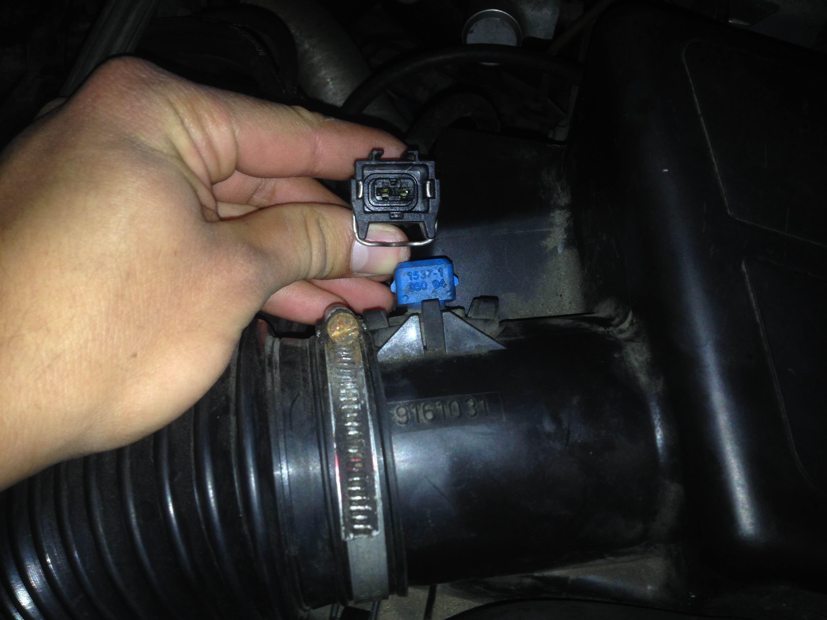

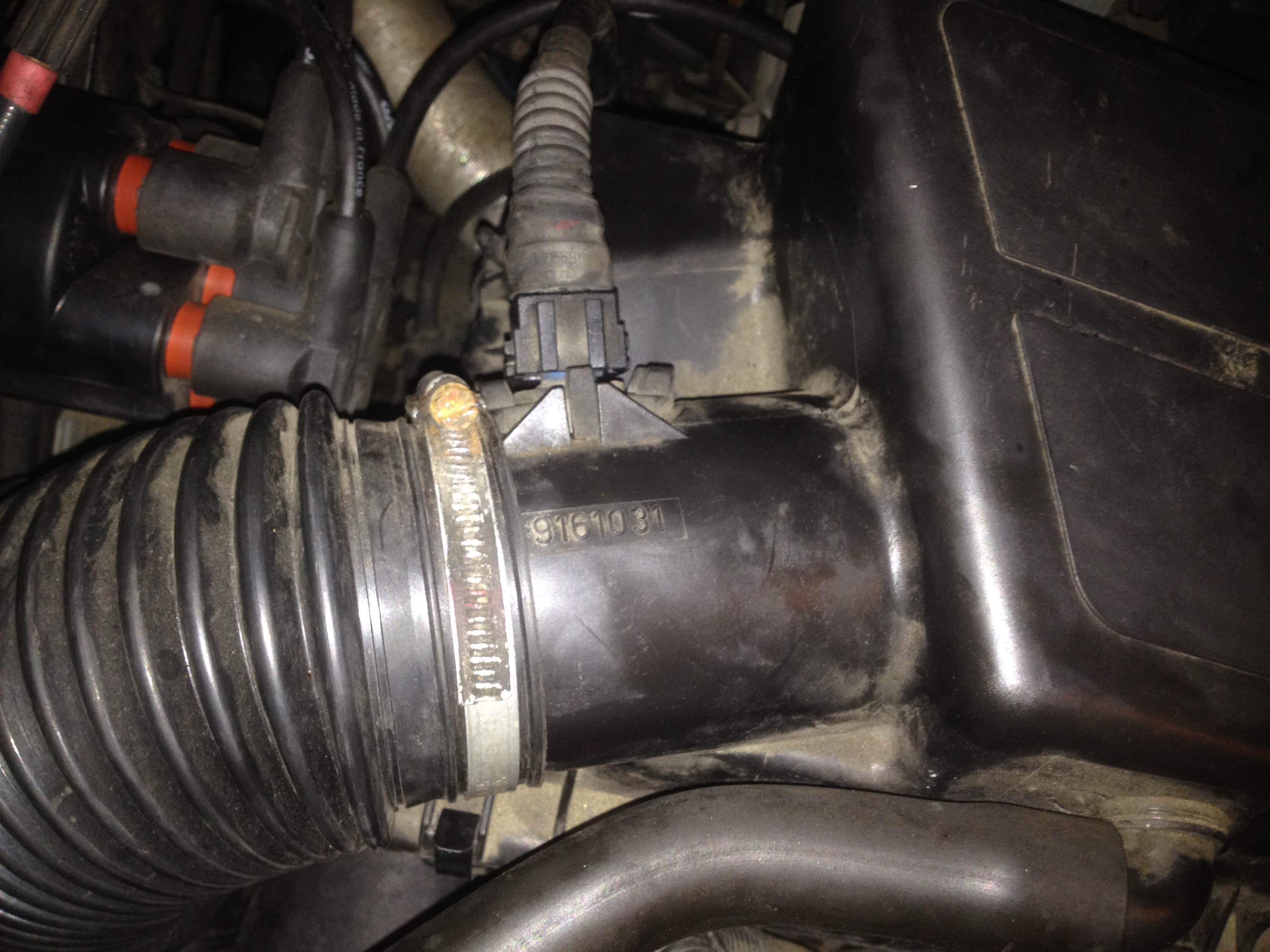

NEW UPDATE:
After driving the vehicle for this way for two weeks, I have come to the following conclusion; the car seems two driving modes.
Normal- The car has good acceleration, idle speed, good fuel economy, and runs essentially normally.
Yuck mode- The car has sometimes good / sometimes bad (misfires, kicks in and out) acceleration, high idle speed (1150 rpms), bad fuel economy, runs rich (smells like gas when running).
I have visibly inspected what I assume to be the MAF sensor (refer to photos) and cleaned the sensor and plug with electrical contact cleaner. This made 0 difference. I also unplugged and plugged it back in while the car was running. No difference in idle speed and CEL did not come on.
I also inspected the CPS wiring and it runs away from the distributor and is clear of any wiring obstructions (its not tangled or mangled or anything).
I'd also like to point out that the car underwent a tune up before I purchased it. It was performed by a used car dealership that specializes in older Volvos and Subarus. The car still has a 3 month warranty on it so I might just have to take it back for them to look at. That being said, it may be hard for them to diagnose as the issue only happens sometimes and the car doesn't have the CEL on :/
