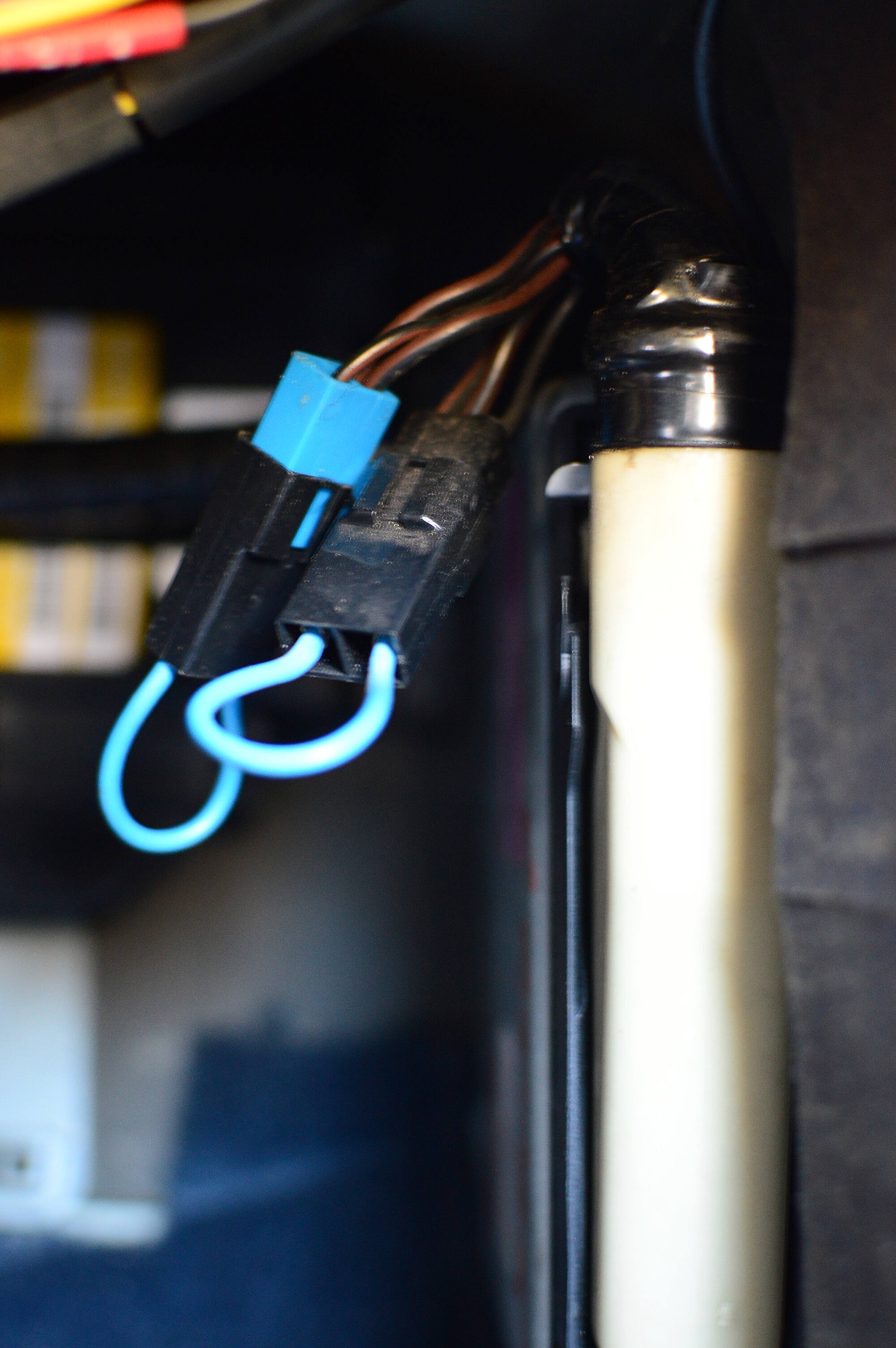

The only thing that I haven't thought about doing is taking the computer out and sending it out to be rebuilt for a tune of $450.00 USD. I guess the question is that in the picture below, do the two blue-looped wires attached to the computer show that it has been jumped?

does this pic show a jumped jetronic ECU?

Notice that the wires at the connector running into and out of the loop are of the same color. Try checking the wiring diagram.
http://www.volvowiringdiagrams.com
Edit: wiring diagram shows the black/brown wires all going to chassis ground. The looped wires should be there. Try to find a compatible used ECU. Don't throw a lot of money at new parts before doing a little detective work. That is my advice.

The wrong coolant temp sensor can cause your symptoms and may not set codes.
The jumpers are normal.
The correct engine coolant sensor will check resistance to sensor body on both pins (and the sum of the two readings between the pins) and the wrong one will be open to sensor body but read resistance between pins.
