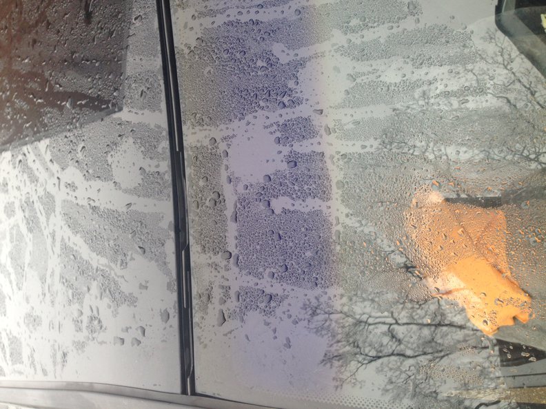

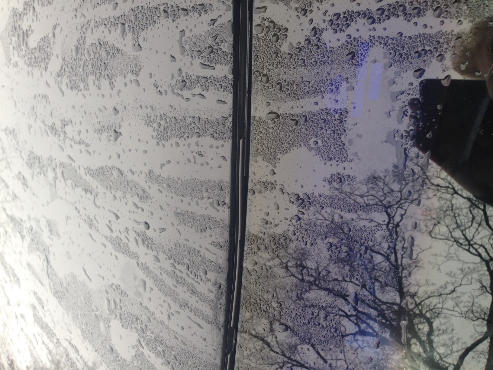

Hello all. I have a 1997 850 that has a very wet floor on the passenger side. The liquid is definitely not antifreeze. The windshield vent hoses are clear and completely free of debris as are the rear vent hoses. The floor is soaked and after picking the mat and carpet up, it is clear that the foam padding os soaked. I checked the vent hole for the a/c and that is clear too.Is it possible that the windshield seals have failed that badly? I will post a pic of the upper seal, which could be suspect If you click on the photos, they should rotate to the correct position. Any suggestions on this are appreciated!

Also, it is super common for that windshield trim piece to be missing, one of my 850s has been missing it for years with no leaking. Can cause noise on the highway, I know some people put electrical tape over it.

Re: windshield trim piece that sits btw the glass and the roof: it is mostly cosmetic. The actual sealing is btw the polyurethane sealant and the glass itself. You can't see the poly sealant once the glass is installed.
