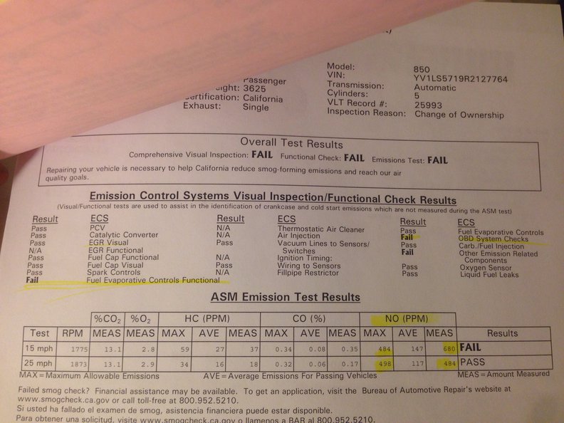

Well, my model has a OBD2 under the coin cover but the smog testing guy still did the tail pipe test.Ozark Lee wrote:What part of the smog test did it fail? With a '94 you typically don't have OBD-II so they must have tail pipe tested it.
I failed in:
- Fuel Evaporate Controls Functional
- OBD System Checks
- Other Emission Related Components
I will upload a photo of the test sheet asap.

- Posts: 36154
- Been thanked: 4071 times
Welcome to MVS !
The good news is you are really close on your emissions test, just slightly over max on NOx, which usually is a vacuum leak running lean mixture. Replacing missing vacuum hoses will probably fix that.
It would be good to readout the OBD codes if that plug works

I'd fix all the vacuum leaks, make sure an OBD II reader can read the codes from your car and run the car until the catalytic converter is HOT then test. Idle will only cool off the catalytic converter.

Thank you! At least some good newsabscate wrote:Welcome to MVS !
Indeed I had two vacuum pipe leaks. One was the vacum line to the fuel pressure regulator, and the other one was the black connector piece which was attached on the same vacuum tree then the first line. I found this overview of the vacumm hoses in the T5. I guess these are all of them?
https://www.matthewsvolvosite.com/forums ... php?t=6941
As I said I'm a complete noob when it comes to fixing/analyse cars. Therefor I just want to double check on my approach on the next steps to get that car up and running.
Next steps:
- check all vacuum hoses (replace if needed)
- check the evap of leaks (it smeels constantly like gas in the car so there might be a leak somewhere - > will open a new thread for this)
- check OBD Codes (Does the OBD1 interface provide me with the same codes?)
- do an oil change to Mobile1 HM 10W40 (incl. oil filter)
--> run another smog check or replace PCV first? (even if the test results of the smog check said it is ok?
Please let me know if that order makes sense so I can start making my hands dirty
All the best!

Makes a lot of sense.
Also check your IC hoses and replace them. Ideally, they should probably be changed if they're still the originals. Remember that leaks can be hard to see/feel, so pressure check them if you can. If any of your vacuum or IC hoses are mushy, or bulging anywhere near clamps and stuff, change them.
If you have the time, and you're sure it's needed, change your PCV. Don't forget to clean out or replace the PTC as well.
Your OBD I boxes in the engine compartment will give you the same codes as the OBD II interface, or more. In your case, I would be surprised if your can get the car to tell you anything of any use through the OBD II w/o Volvo's own equipment, so stick with the under hood boxes.
