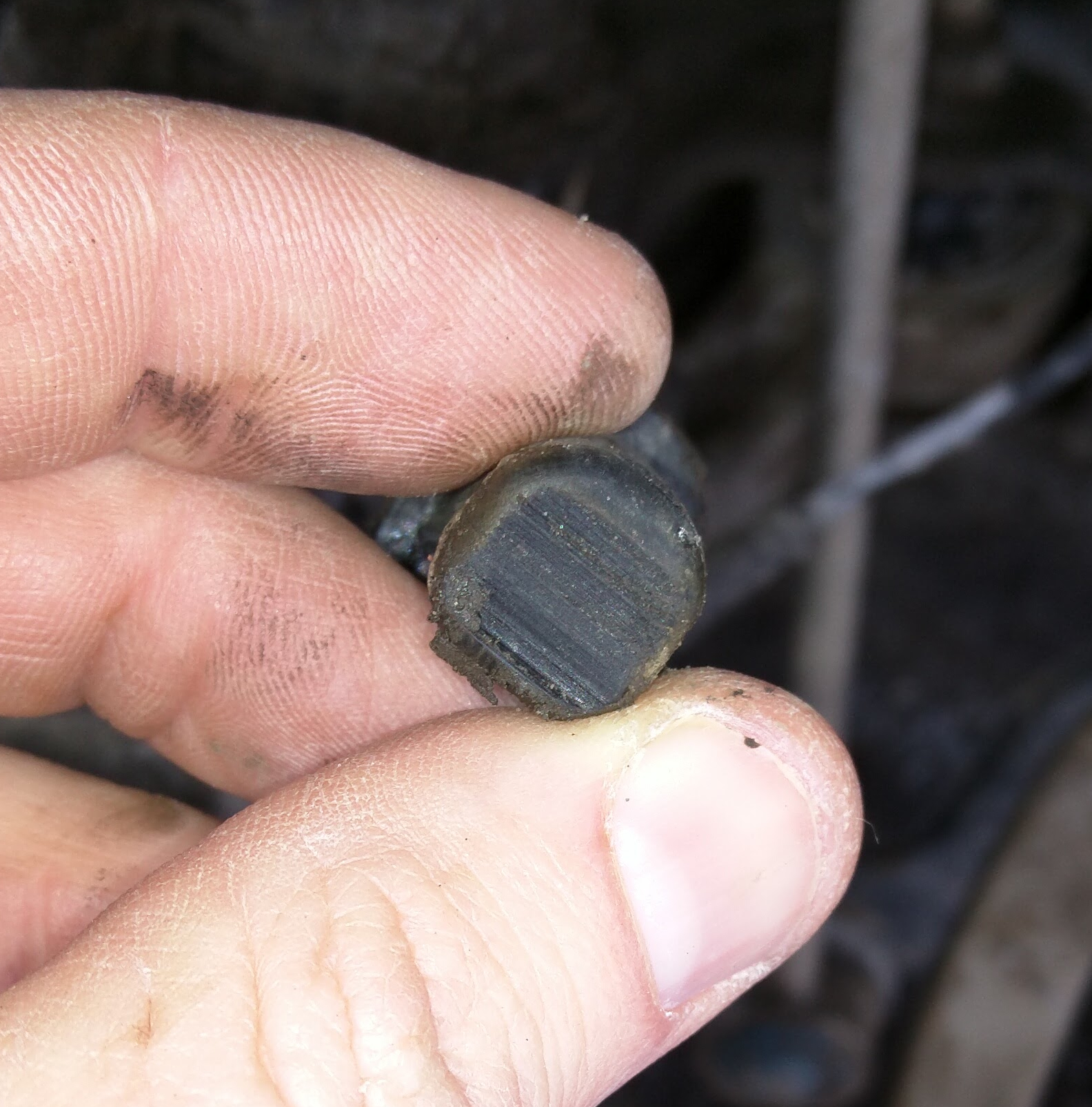

Hi All,
I'm still working on this issue. I'm pretty sure it's the LH Front sensor.
I inspected the sensors and cables yesterday. The cabling all looked to be in good shape. No cracks, kinks or anything. The end of the Left Front sensor seems to be ground down. The ABS ring looked ok. Not much corrosion. I've attached a pic of the sensor.
Finally found someone with a DICE box in town. The relevant codes in the system were:
BCM-0011 Wheel sensor, Left Front Faulty Signal
BCM-0012 Wheel sensor, left front mechanical error
CEM-1A5F Communication with BCM control module signal missing (We looked into this one. It happened once, and never again since the fault initially happened)
Cleared all the codes, drove around, got the same "ABS/Traction control service required" / Yellow warning / ABS light on. Read the codes, and the only one to reappear was BCM-0011.
I'm planning on changing the sensor and cable, as well as the ABS ring (since it is cheap, and easy).
Is there a possibility this is all wheel bearing related? What would cause the sensor to wear down like that?
Thanks for the help!

Turns out it was the ABS ring. It was corroded, had split, and since it was larger in diameter, it ground away the ABS sensor. I replaced both items, and the problem is solved.
