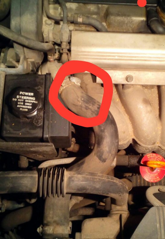

then i started looking for boost/vacum leaks with a diy smoker and found a huge hole on a hose on the passager side. do you guys know what is this hose used for?. pics bellow

Hi BlackD3vil and welcome to the site. The hose in the picture goes from the side of the intake manifold to the PTC valve, it's located on the large intake hose/snorkel that goes to the turbo. I think it's part of the PCV system.

+ 1 to what Matt says. You can sometimes get the hose bend by itself. This is very prone to failing with age, as can many of the rubber pipes at this age. It is worth removing the plastic pipe with the PTC nipple/valve, carefully remove the valve and check it is not blocked. Looking at the amount of gunk at the rotted pipe in your picture it could be blocked. It is part of the PCV/breather system. If you take the plastic turbo input pipe off to clean the PTC it is worth checking the turbo spindle play.
Also check the TCV (Turbo Control Valve). One the 850's it can either be a can or a plastic rectangular part near the intake airbox. There should be 3 pipes going to it. The TCV's start to fail with age and can become lazy to respond not allowing the turbo to spool up fully.
The pipes are very prone to rotting especially at the turbo end. Most folks replace with silicon piping (See IPD for example as a source).
There is a diaphragm on the turbo (CBV compressor bypass valve) which is rubber and can fail with age also. If you suck carefully on the pipe to the TCV that runs to it, if it won't hold a vacuum it is goosed. Good news is on your car you should be able to replace it without removing the turbo.
Fuel pressure should be >43psi at the Schraeder Valve on the fuel injector rail.

As explained, that hose end is part of the PCV system. Unfortunately, if you attempt to replace that end, the small plastic tube that it is connected to will likely break. Test the system and plan on replacing the PCV system.

so the pcv is likley gone and i will need a new one. the problem is i will need to order it online since where i live i prob. will not find it in a store.
i will try to remove the intake and the tubes, sensors and valves and clear them out with a compressor.

I noticed the plastic pipe that feeds air to your ECU has holes in it. Clean it with rubbing alcohol and seal it with black electrical tape, or buy a new one.

Yes the ecu pipe dose have holes in it. and i will be fixing them today. was hoping to find a used one at the jy but no luck.
