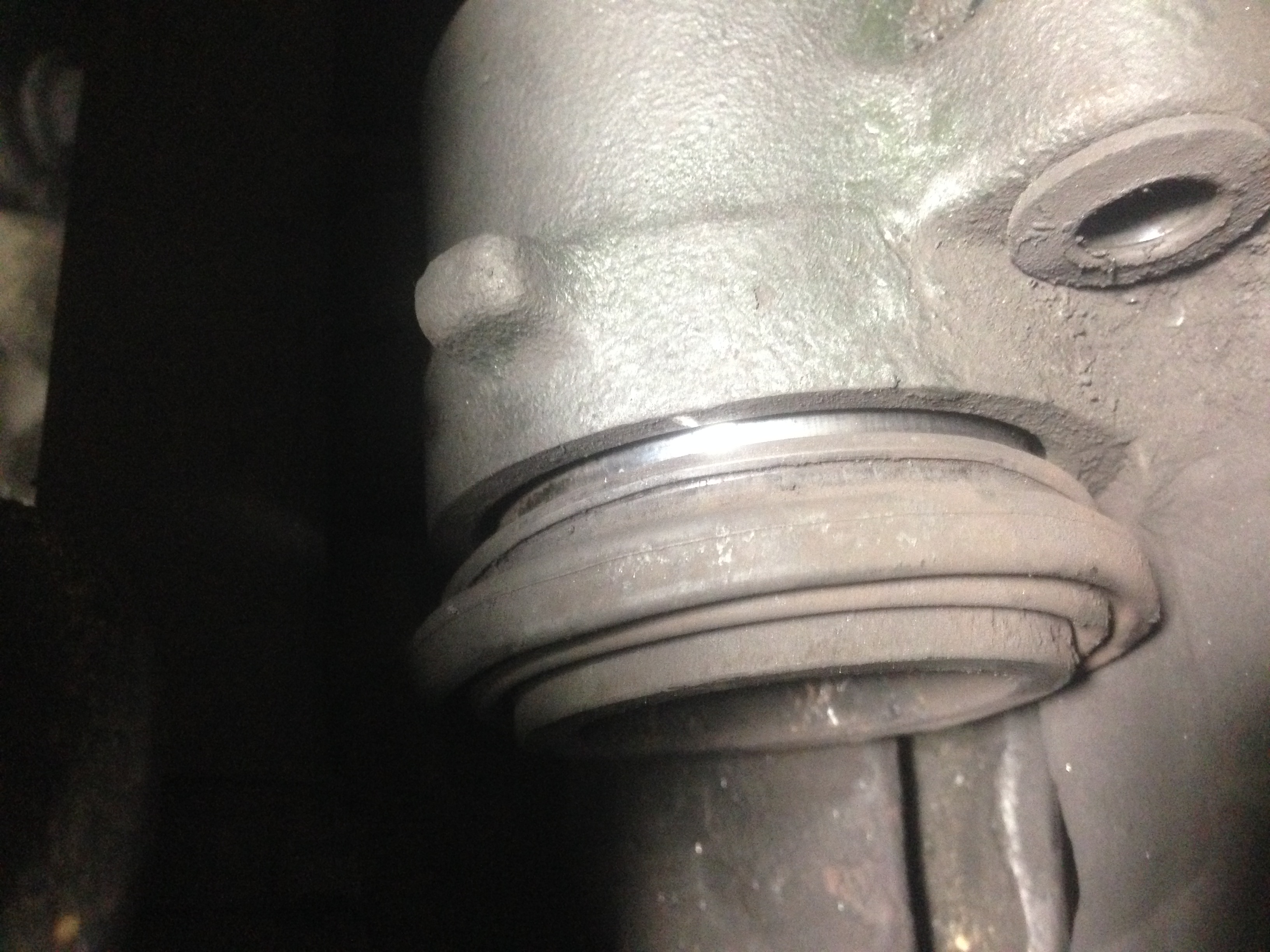

Ok, opened everything up and I could see that on the left side the dust boot came of the caliber. One side is still attached to the piston but the other side is completely out of the housing.
Tried to put it back into but for some reason it will not work. Any tips how to replace this dust cap? Thanks!

It is good practice to clean the caliper piston before you use a C-clamp to recess it back into its seat. It looks like what happened in your case is that when the piston was pressed back into its seat, the rubber boot caught on the dirt on the piston, and, when you pushed on the brakes, and the piston moved inward out of its seat, the boot came along with the piston and detached from the caliper.
I would remove the rubber boot entirely,clean the boot with silicone spray, clean the piston well, and then recess the piston back into the caliper using your C clamp. Then very gently move a blunt wide screwdriver around the back edge of the boot to press it back into the caliper.
That being said, I doubt if this extracted boot had anything to do with the vibration you felt.
Make sure to use copper/hi temp grease on the upper and lower pins so that they slide easily. Also make sure the pins are fully compressing to the caliper... they have a rectangular tab that needs to be rotated properly to fit into the caliper securely.

I'd recommend replacing the boot, if it seems like the boot itself is torn or in rough shape.
https://www.fcpeuro.com/products/volvo- ... 850-271583
