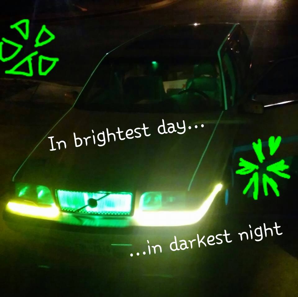

As far as the LED lights, I may hook them up after the capacitor, so I can run them while the car is off. I have 5 meter and may add up to 10 meters. I'm thinking that will be fine, aside from some possible flickering with the bass... anywho. Thanks in advance guys.
