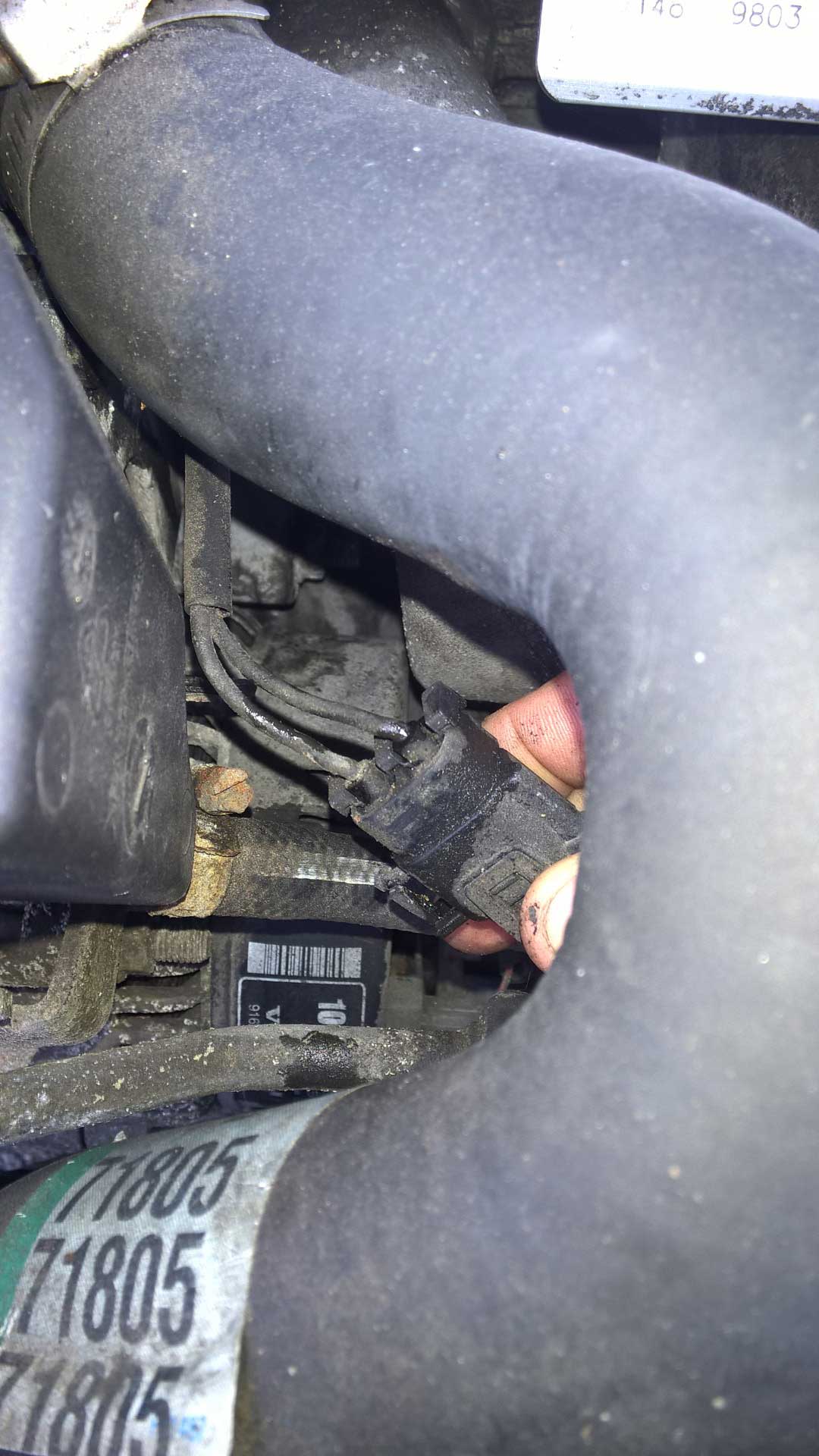

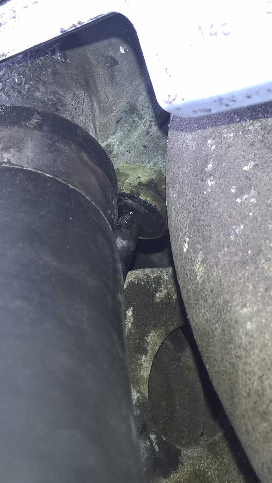

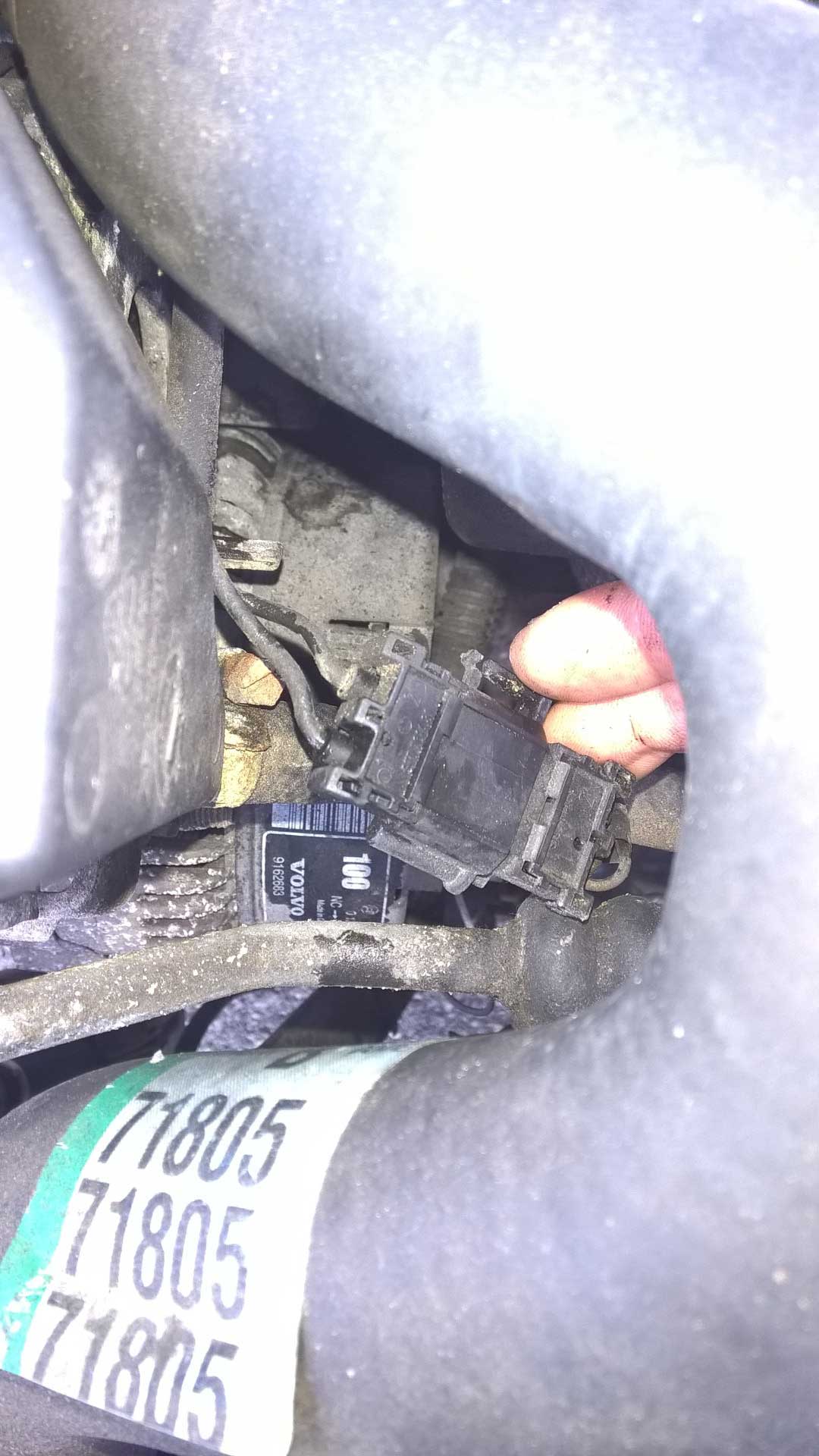

I crack open the hood to see what I can see. There seems to be coolant coming out of the engine temp sensor. :shock:
The coolant ran into and onto the wires. (Does this cause a short of some sort?) :?
I detached the clips and reattached them. Car still wouldn't turn over. :(

The engine temp sensor is, of course, a different thing. It was green, leaky, and one connector was green inside. By the way, using the 19mm wrench and connecting a screwdriver to it in order to screw it down was such a cool bit of physics. I read that somewhere here so thanks for that, too. I had ignorantly thought this would magically fix things, it did not. Car is still not starting.
