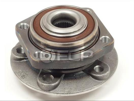

People note that this suits V/S/C70 up to 99 model year and not over as the newer design from 1999 on eliminated separate inner and outer and rear bearings as in pic below: So post is confusing as it mentions a 2000 V70
Kudos for ingenuity, though
- Hub.JPG (30.21 KiB) Viewed 1418 times
