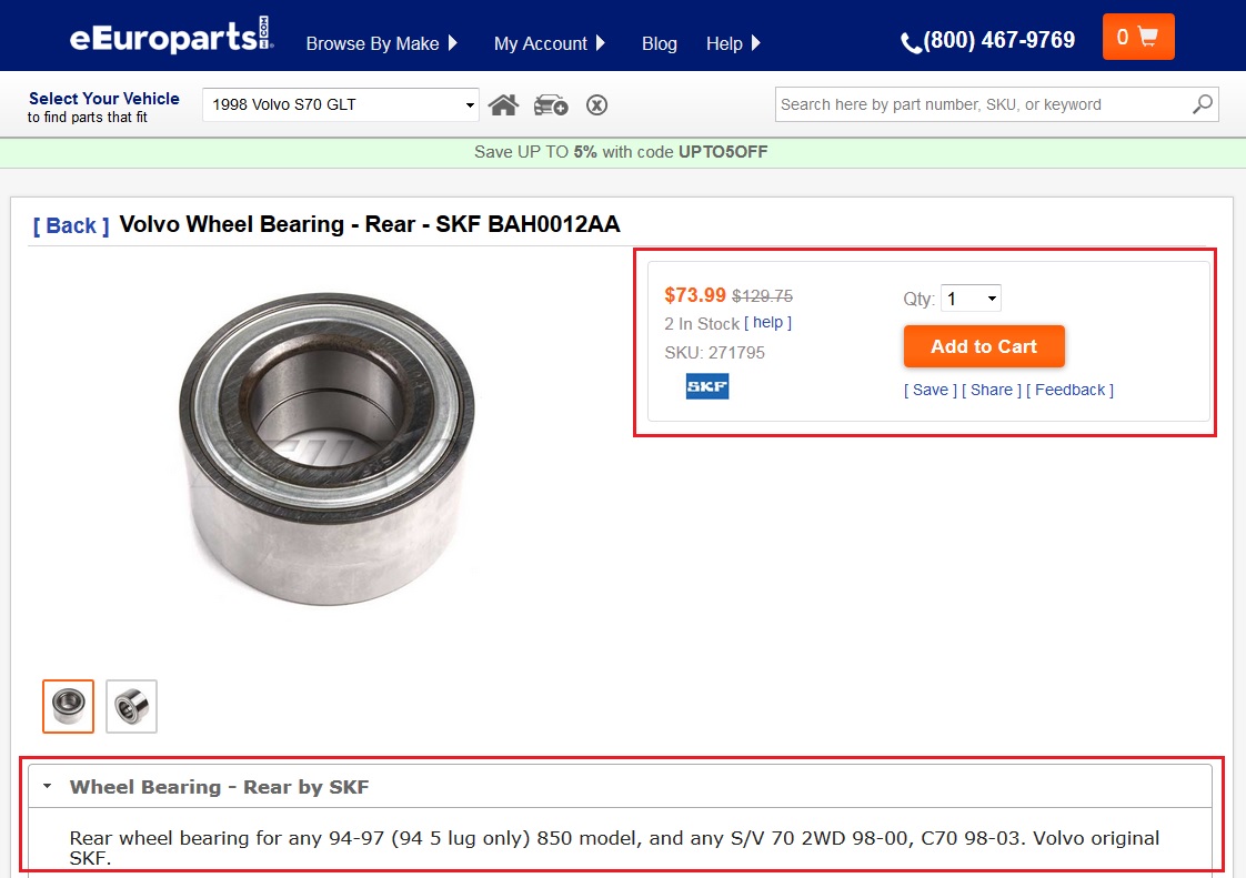

I understand that for the Rear Bearing (FWD models), it is most often sold as a complete unit (as a hub) for $110-$130 price range.
However, I have seen many websites (rmeuropean, eeuroparts dot com) list the stand-alone bearing as shown below.
Has anyone here replaced ONLY the bearing itself? Obviously, if you go this way, you need a press and appropriate adapters to remove the old bearing and install the new one.
