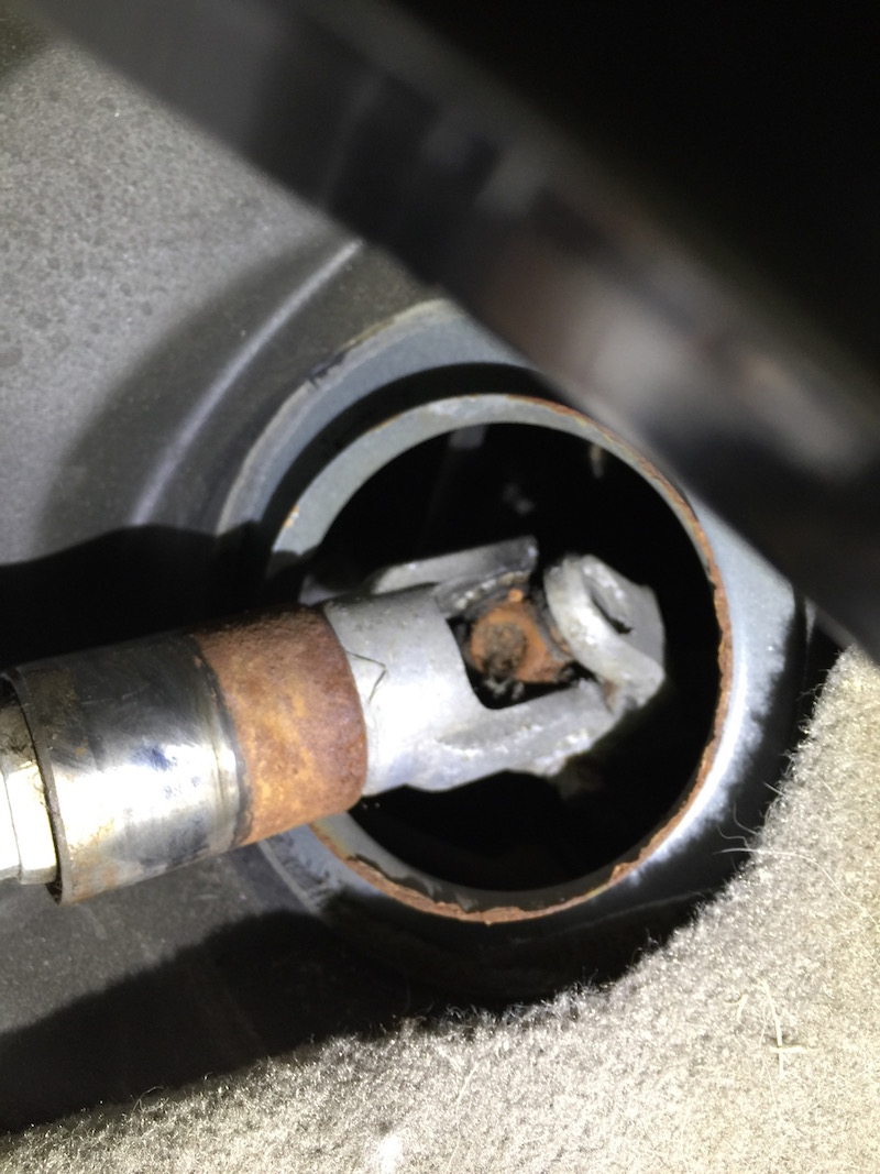

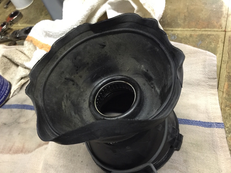

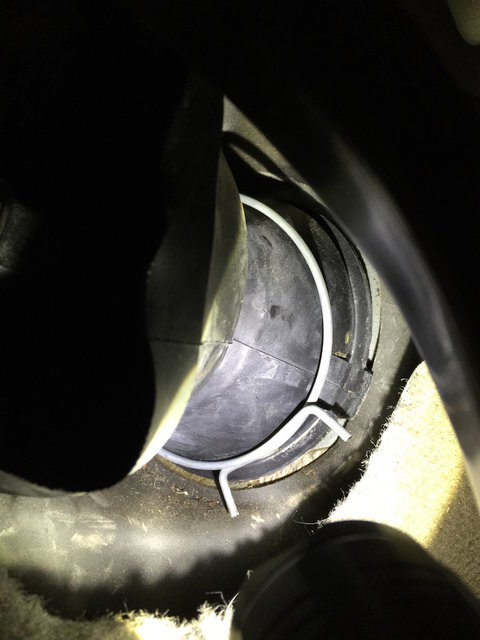

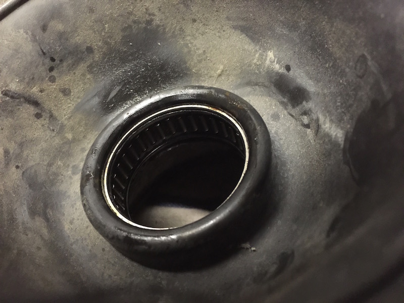

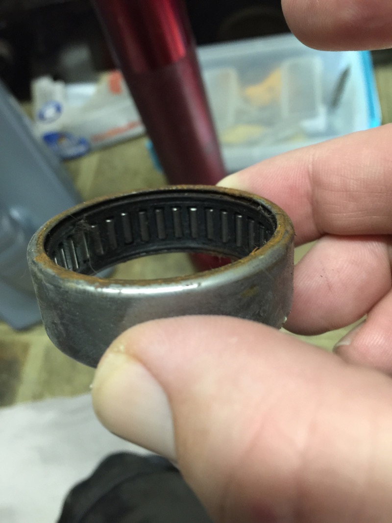

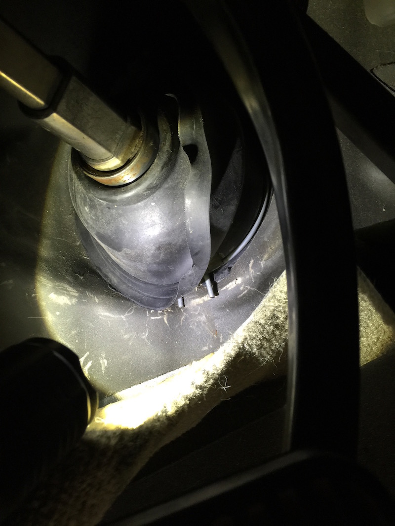

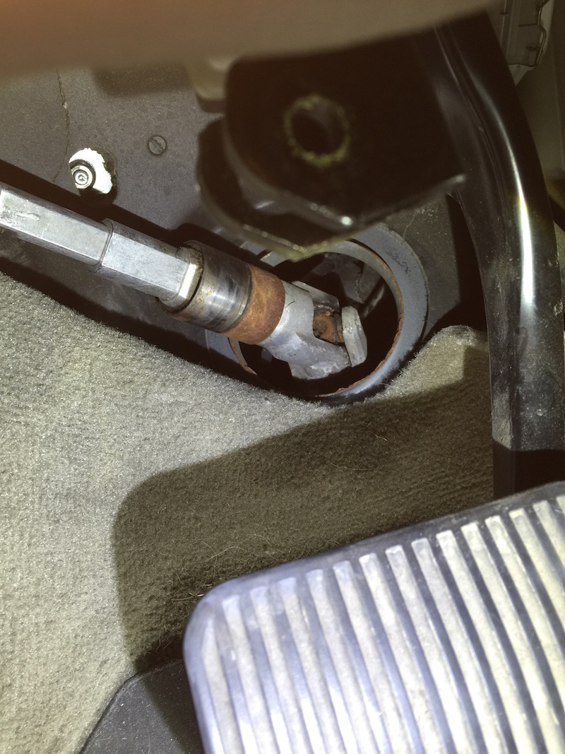

OK...
Looks like the bearing and the joint behind the rubber cover were to blame.
I took some photos and here is a quick procedure...
1. Take lower kick panel off to give you some more room
2. Peel back carpet
3. Boot is doubled over on itself. Peel the first layer back to expose big clip to remove.
4. Pull entire boot up.
5. Take that 13/14mm nut off the steering shaft and the lower part will swing away from the top that moves up and down.
6. You see the bearing in there. Mine was starting to get stiff and make have been a source of some sounds. Cleaned with brake cleaner, oiled and then greases. Good as new.
7. Exposed c/v joint was bad. Very stiff. Hit it with Kroil (sp?) penetrating oil and let is soak for half hour. Worked it up and down and left and right until my hand cramped...felt a bit better. More oil and more motions. Added some c/v grease, just some purple moly stuff I had from work for high temp use. Made a mess of the c/v joint and put back together.
8. Reverse of taking a part...went back together easily. Moves WAY more smoothly.
I'll include some photos below. I might still swap out fluid but I"m pretty sure the stuff I got is good enough...will report back this week after commuting.

Nice job and pix Shane. Strange that joint developed stiffness, it doesn't see too. Much grime does it?
The perils of old cars at 3x their life cycle .......
