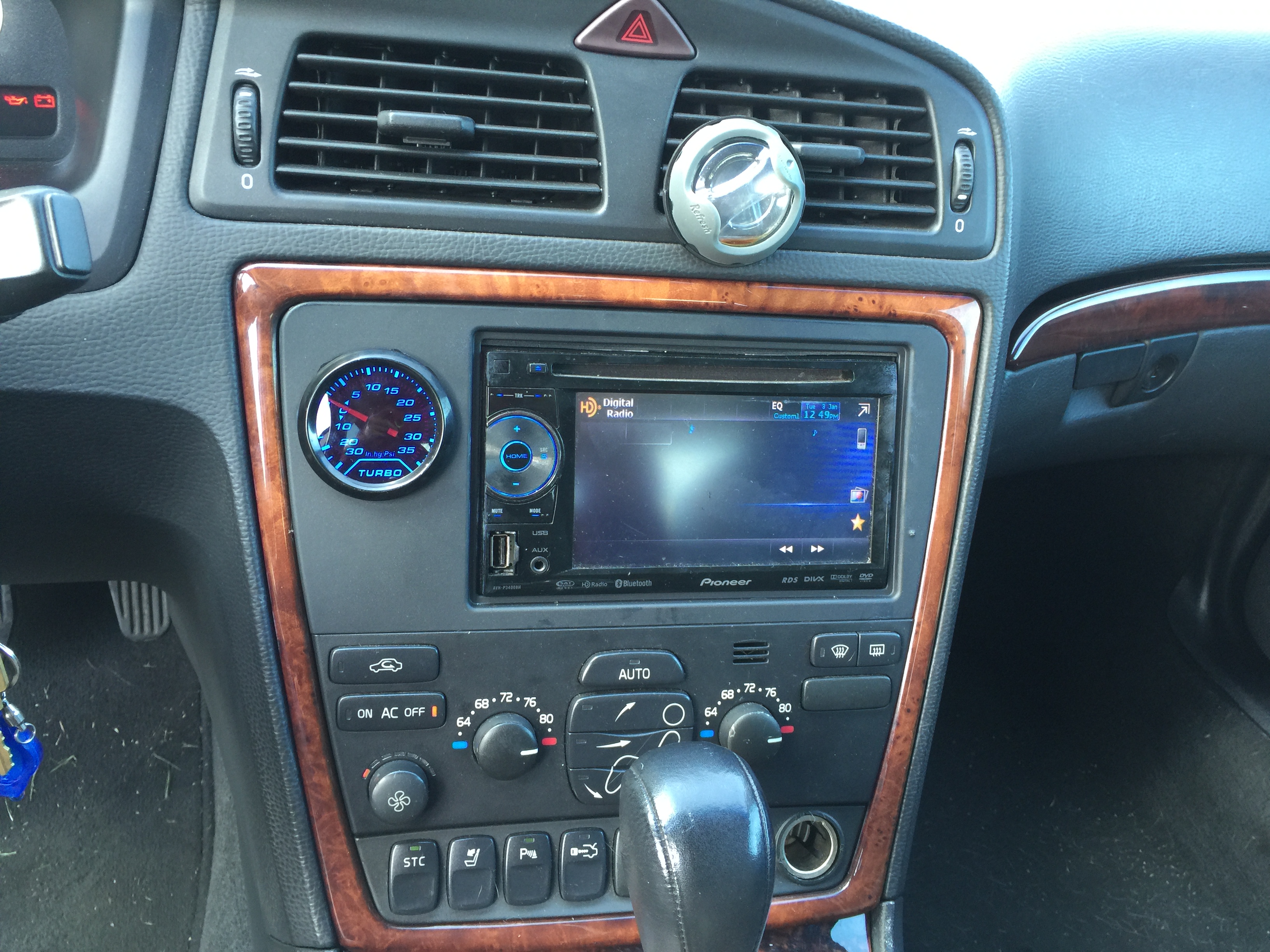

Funny enough, I did an oil change and used sea foam and 0-20 for the new oil and the problem went away. I cleared the code and it hasn't come back. There was a bit of metal debri. I'm thinking the oil treatment I used last time made the oil much too thick and it wasn't getting past the filter or something... But either way it's good thus far! I'm going to change the oil again in a week just to make sure there's no sludge or anything. On a side note check out the stereo and boost gauge!
