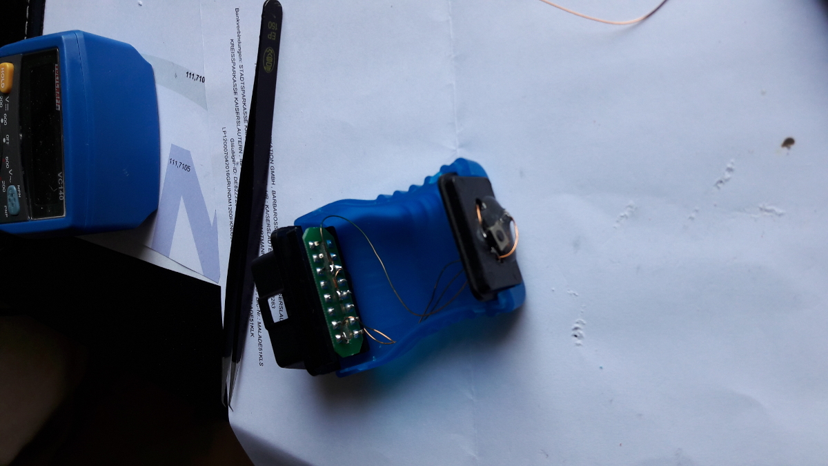

Next thing was a check engine light (the 'lambda light' for european model) and starting problems, the 3000 Euro (!) Bosch OBD2 reader from my Indy shop couldn't read the code. However, this Codes from the ecu without the dataconnector thingy worked perfectly, see attached photo for my version of it. Turns out it was a failed camshaft sensor, replaced and now everything is great since a few thousand km.
