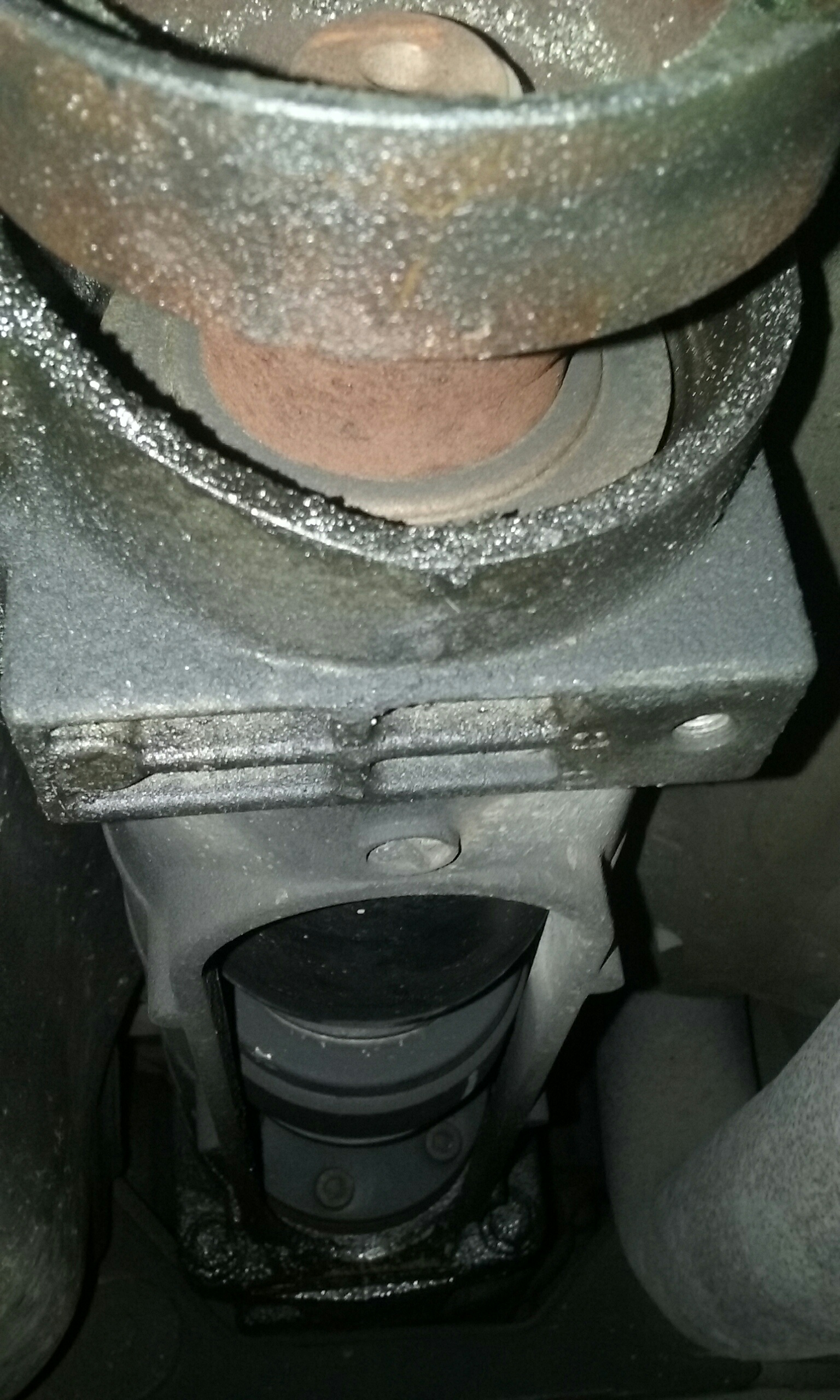

Is there a THIRD CV before that driveshaft inputs into the diff? I ask because there's a big wet spot that I'm beginning to suspect (please see attached photo). If not, what is that I'm looking at?

(driveline disconnected at the top of the picture, wet spot at the bottom near the diff. Sorry)

What you are looking at is the viscous coupling casing. Clean the oil off at the back of the housing and check if there is oil leaking from the rear axle seals in the rear differential.
The prop-shaft has 3 points that can fail. but the usual 2 are the front CV joint due to proximity to the cat/turbo, and the rubber ring around the center bearing support on the prop.
What you can also check is the bearings at the nose of the VC (top of your picture) and also check the support bush at the front RH of the housing.
The first of these issues is more likely to be the issue.
Lastly check the parking brake shoes have not de-laminated or the parking brake cables have snapped and may be rubbing somewhere at the back.
If there is a lot of oil actually coming from the VC unit itself it may have failed.
Many of the guys here would suggest pulling the prop-shaft and seeing if the noise goes away.

Thanks man. I cleaned up the viscous coupling but didn't see any obvious leaks at the diff. I'm going to let it ride a while and reinspect that one.
The front CV joint on the prop shaft was the one that was "a little dry" (think slightly wet graphite). I re-packed it with some generic CV grease, I'll have to drive it tomorrow to see what changes, or if the fault returns. It'd be nice if the bearing was in good enough shape that the grease shut it up for good.
I checked the VC bearings like you suggested. I don't feel any feedback when I spin it, and there doesn't seem to be any play. I completely forgot to look at the park brake cables, but the park brake works so I think I can safely say the park brake cables aren't snapped.
