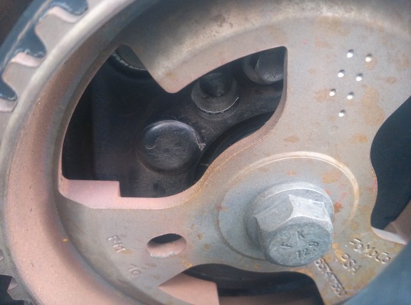

I was curious if you know if it is normal for the cam sprocket to stop in different locations every time you turn the engine off?
If I remember right before having the timing belt, pulley and tensioner changed the cam sprocket always seemed to stop at a position where two holes lined up (one was through the sprocket and the other hole was in the engine). It was as if you could put a pin in there and now after the job the cam stops at different places.
Is it possible that something was not done right?
Do you know of a way to confirm if the timing is correct?
First picture is before and second one is after the change.
I decided to go to a mechanic to have it done. I thought maybe it was within my comfort zone but I decided to play the safe card.
