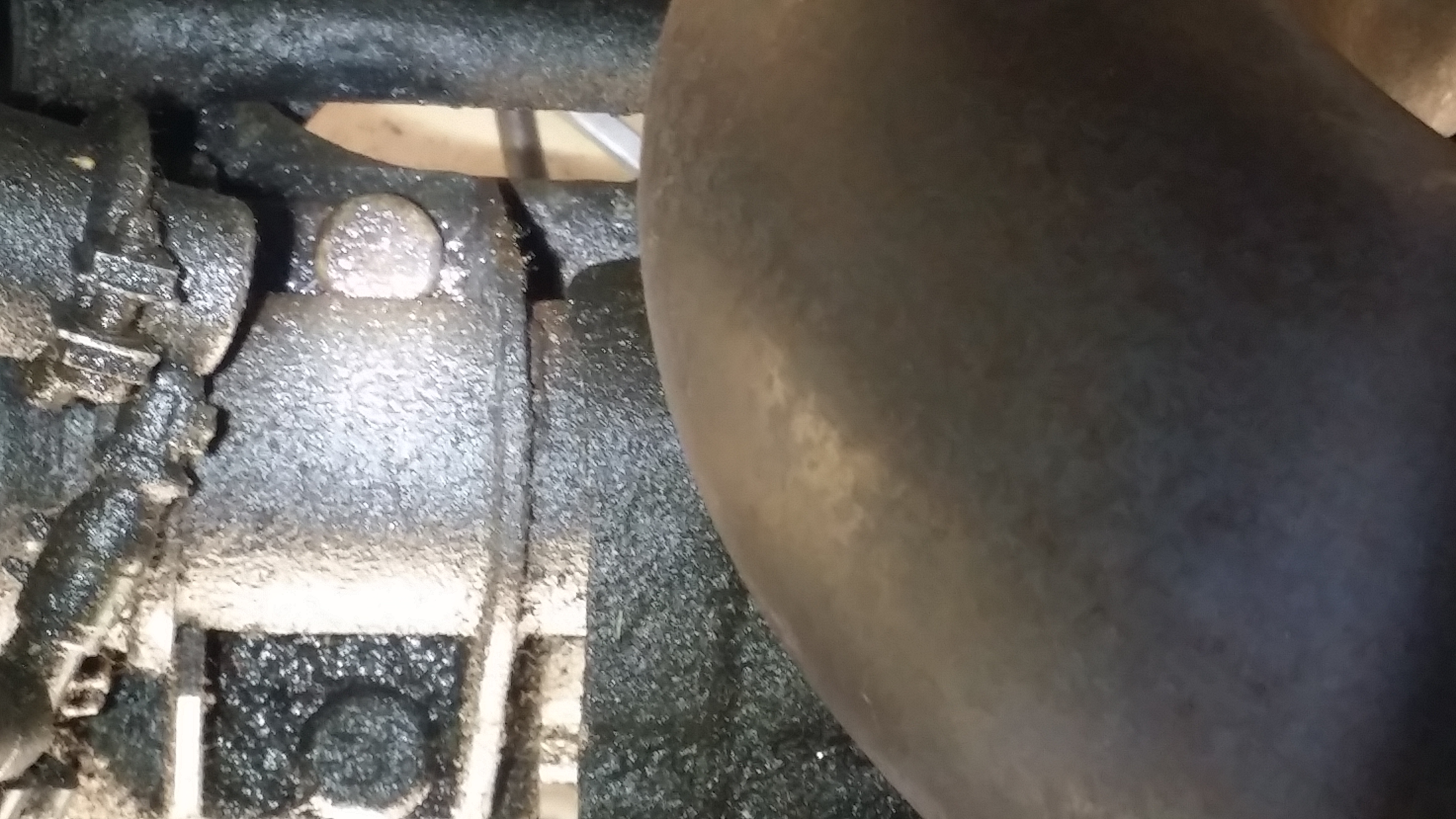

No access to a torch, unfortunately. An angle grinder would be too big. I've attached a pic of the bolt. The right side of the pic is the downpipe. The bar running along the top is the sway bar, which is very close to the rack. As you can see, the top of the bolt is surrounded by a sort of stiffening bracket which makes the angle grinder impossible.

Well I was able to figure it out - after a lot of swearing and attempts. I ran out and purchased a 30" pry bar, then I jacked my car up as high as I could in order to get the right angle to jam the bar on top of the bolt and under the sway bar. Pushing up on the bar (with the sway bar as my fulcrum) with one hand gave me enough leverage to hit the nut with my impact driver in my other hand. It took me about an hour to work it all out, and ignore my fear of jacking up my car as high as my jack stands would allow - No way am I getting crushed!
I'm sure if I had the car on a lift, it'd be done in 2 minutes. Oh, to win the lottery and buy a proper garage!
I wish I could post a picture of the setup but it would have been impossible to do. Thanks for all the suggestions.
