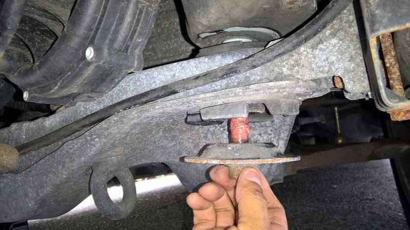

Bolt came off without any incident. Wondering though, should it be lubed up like this? This means the subframe has been dropped for some reason or another, no? (It sucks not having the previous work history done on a car.) But, grease doesn't have loctite-like qualities! I don't have any red Loctite. Blue is alright for this job, right?
This bushing wasn't in horrible condition. But the washer was all warped and all the space!

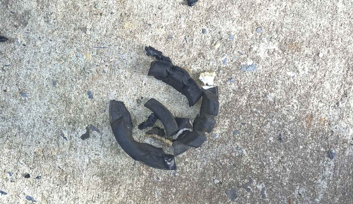

Finally got ONE bushing out. And ONE bushing in. Holy smokes, it takes a lot of elbow grease.
Steps I took:
1. Hammered off the top.
2. Drilled out the center metal piece. (I used a Dremel with a cutting attachment and a small cordless drill to make holes all around.)
3. Shoved a small screwdriver in between the frame and the bushing and cracked the plastic.
4. Removed the remnants...
First one took two days. The second one took an hour! :D

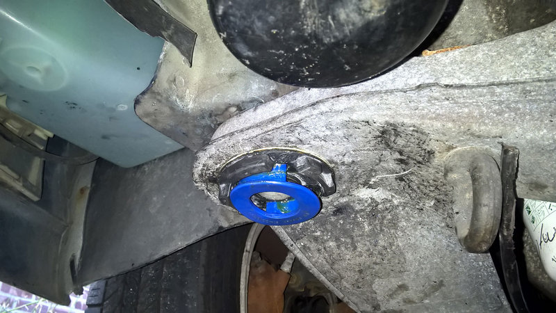

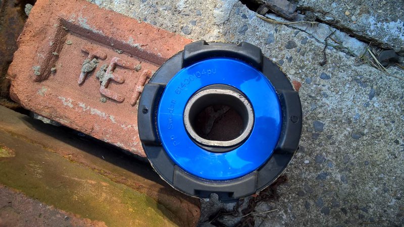

Here's the bushing I installed on the front right. Double the Proparts, double the fun! NOTE: If you are going to double-up your bushings... make sure you install the insert before you install the bushing into the subframe. It should look beautiful, like this. See below for what happens if you do not do this. EDIT: You will not be able to get a Proparts insert into the new Proparts bushing, the ones with a circular hole rather than the oval hole. I tried. I lubed it up. I wailed on it. I shaved it down. I stabbed it. I tried to squeeze it in there with a jacks. I cut it apart. Nothing...

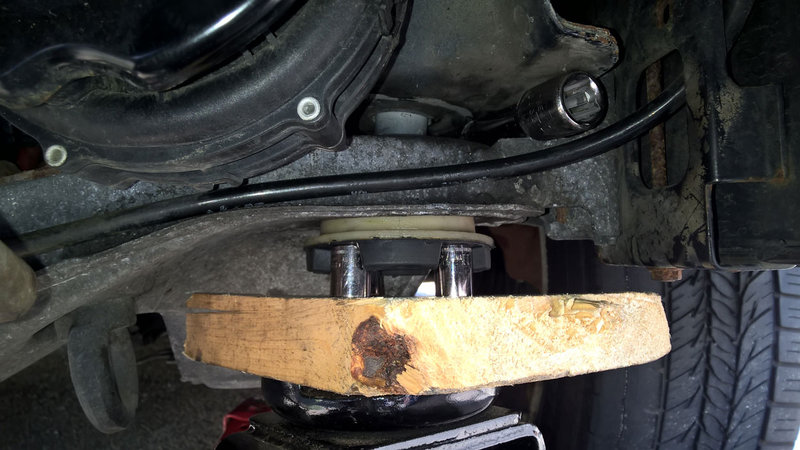

I lightly lubed the bushing (Motul synthentic grease) and tapped it with a mallet to get it started. Then I did the socket trick. I didn't think it worked at first. I thought it would go in easily. But you really have to crank that jack up, and let it do it's thing. If you're doing this on the ground, you'll have to jack it high enough to take the wheel off the ground two inches at least. Go slow, and make sure you reposition your jack and sockets so you don't break anything. I think you'd have to be really misaligned to break anything... These things are pretty strong.

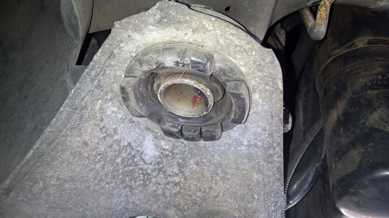

The passenger side bushing. Not in horrible condition. But the washer was all warped and if you look closely, many, many cracks in the rubber! Like I mentioned above. I was able to pop this one out in less than an hour.

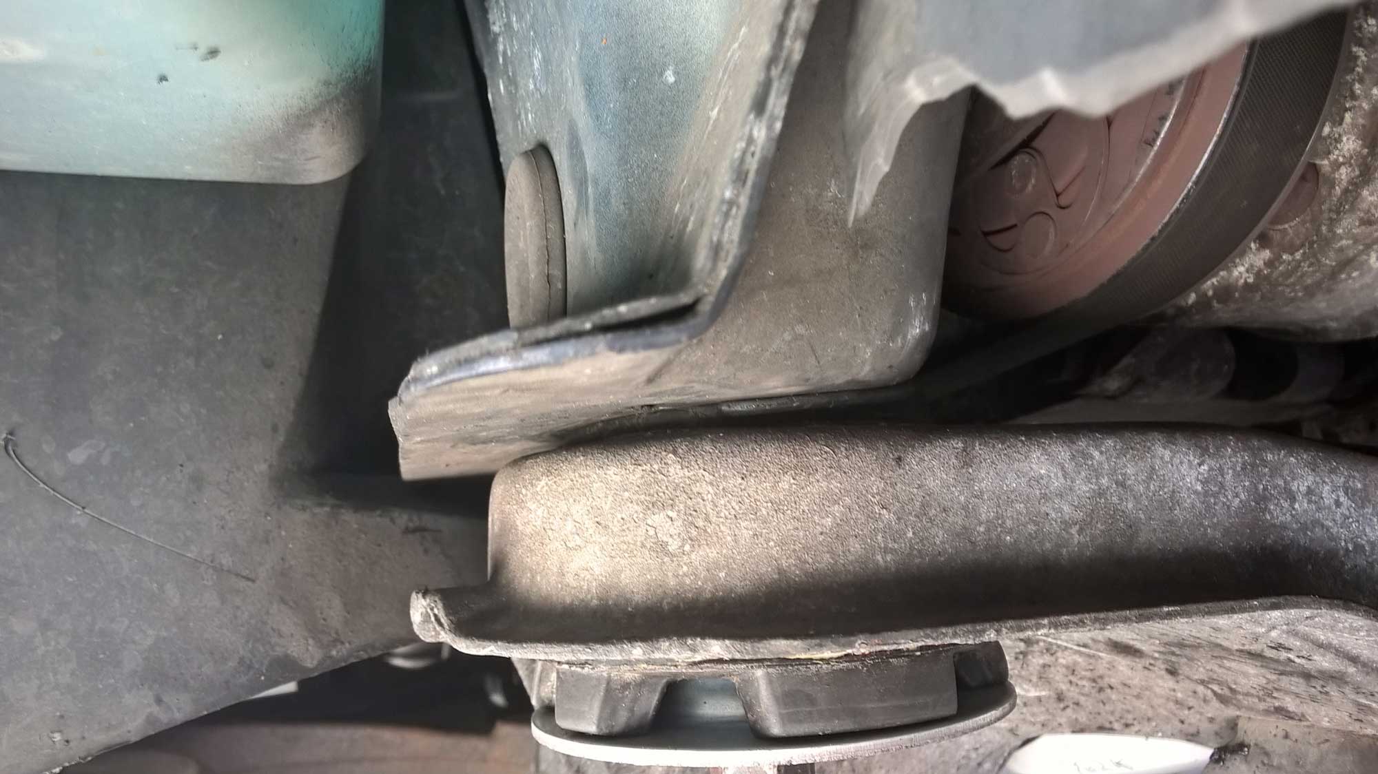

Double the Proparts FAIL I don't know how to get this freaking thing in... I know, I know, I know. It's not designed for new bushings. But it did go in the other and it looks great. Doesn't anyone know how to get this in. I spent the day wailing on it with an hammer, trying to run it up with the washer, with my piece of wood with sockets, nothing works. I even tried saying, "F this," and just started to run the washer down. But then it started bumping up against the teeth and deforming them! :evil:
I'm thinking if I can't get it up there. I'll just cut it off and caulk it up to idiocy on my part. But at least I can move along. Any ideas guys?

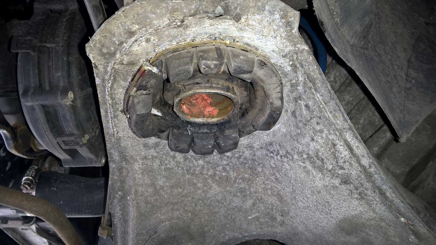

So, clunks haven't disappeared... I know my sway bar (or bushings) need replacing.
But this, what the heck is this?!?!@#
My subframe bushings need to be replaced after less than a 1k? Look at how they compressed against the frame? I put the right torque on them. I used Loctite... :cry: Approximately $60 for Proparts Bushings + Proparts Inserts (of which only one fit)... What a way to throw money down the tubes.
Do not install these.
The oldest, most rotted-out OEM bushing would be better than a new Proparts one. I need to get these replaced ASAP before I end up deforming the engine cradle. What a way to waste hours...
I should've listened to the wise...

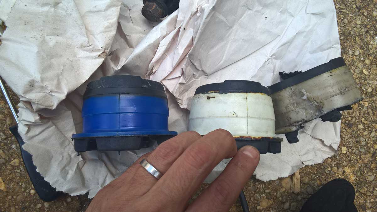

Here is a new XC90 subframe bushing up against a new Proparts one and the one I ripped out today. The XC90 one seems a hell of a lot taller. (Especially considering bushings are all about their mm...) Just to reiterate: I hate Proparts, here's some proof as to why you shouldn't buy their subframe bushings.
