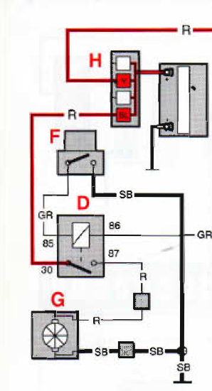

Item "F" is the high pressure AC switch that activates cooling fan, and is located on passenger side engine compartment, below lower radiator hose. "D" is the relay, and "G" is the AC-fan.Skymaster wrote:diagram
On relay pin 86, there is voltage there when your AC-switch is flipped on inside vehicle, and pin 85 is used as a ground to energize relay so fan works.
So, if your AC-switch is flipped on, grounding pin 85 will activate fan. But, if your AC-switch is not turned on, nothing will happen if you ground pin 85.
So, this setup only works if your AC is running...in my case, where AC is not working, I jumpered the high-pressure plug's terminal to complete its circuit; so when I flip the AC-switch inside vehicle, the AC fan will run within a minute...there is a time delay circuit, so when the AC-switch is flipped, nothing will happen until a minute or so has elapsed.
Only way to make AC-Fan run when you want it to run without AC running is to use a Bosch relay and get power via AC relay (terminal 30) or battery. My radiator fan is powered directly from battery, with a circuit breaker fuse on it. Someone suggested AC fan relay is located in LF of engine compartment, but I've never checked this out.
See this thread...lots of ideas.
Do note, this diagram is from late model 1993 240s, early diagram is a bit different in some ways. At the battery, do you have a fuse setup?
Thank you for the Schematic.
I want to rig it so I can turn the fan on and off independent of the ac.
So., I think that if connect the #30 and #87 with a fuse (25 amp) and bring the wires inside to a switch, If I close the circuit,
the fan should come on. if I don't throw the switch, the system operate normally.
Thanks a lot, I will let you know what happens!

Inside vehicle, I would ground one side of an installed switch, and run its other wire to terminal #85. Then at terminal #86 wire, I would install a diode, and place a hot-wire before it, via terminal #30's power.Skymaster wrote:independent of the ac
A diode allows current to flow in one direction...so if you understand this, you know how to hook up this circuit.
Using a ground circuit prevents any electrical issues...at worse, the fan runs, if relay is working.
Reporting my finds for today.
Replace the water pump with a oem (Volvo ) water pump., Vernet 82C thermostat, Very clean Radiator ( no dirt on the outside).
Temperature gage goes up into the red. Jump the electric Fan (at the connector by the lower radiator Hose.
Temperature gage goes into the red.
I also turned the heater inside the car on (it blows hot air),
No change in the Temperature gage stayed in the red.
In reference to your diagram.... switch inside the car one end to ground other end splice into no.85., splice from 30 thru a diode to 86?
