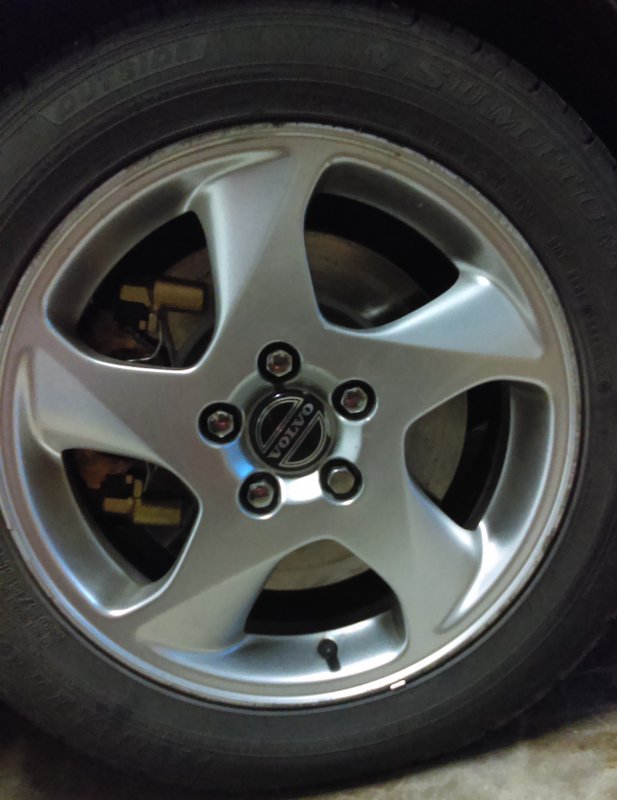

I made this upgrade recently (after ranting a few years back about what a not-useful upgrade it is). Needed new rotors, found the last pair of 302mm brackets at any dealer in the country, and grabbed everything I needed.
I have never experienced fade, and I don't plan to take this car to the track. I just thought the big brackets and discs looked cool inside a Perfo. I'll let you be the judge :]

Looks wicked good, but that's back when the brackets were cheap - like sub-$100 cheap for the set, right? At that price, heck yeah! At $132 for both...eh.j-dawg wrote:I made this upgrade recently (after ranting a few years back about what a not-useful upgrade it is). Needed new rotors, found the last pair of 302mm brackets at any dealer in the country, and grabbed everything I needed.

er, nope. paid something like 65 each from a dealer in Connecticut via a dealer in California. it wasn't a negligibly cheap upgrade. I also bought new longer hoses from FCP, but those were cheap.BackRoadSeeker wrote:
