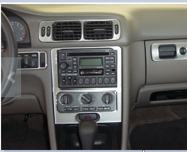

Is it possible to find any kit which will help me to replace location of AC controller and the stereo? I'd like to do something like in the photo..

raykan wrote:Is it possible to find any kit which will help me to replace location of AC controller and the stereo? I'd like to do something like in the photo..
No such kit exists.
You're in total custom territory.
