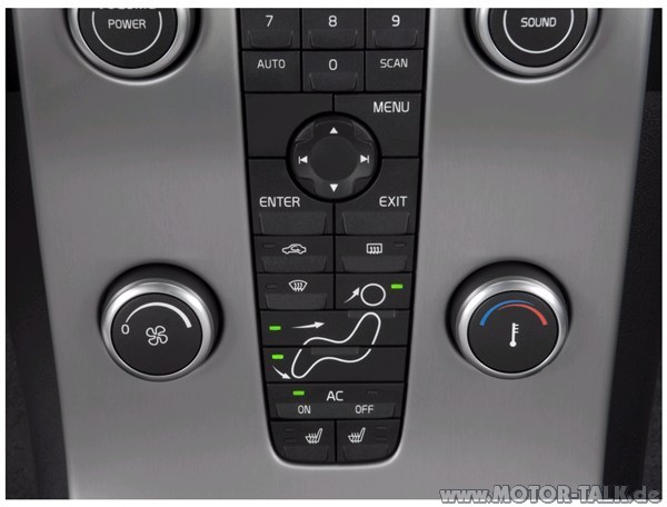

Car: Her name is Anya. She's a 2008 C30 2.5L T5 turbo, manual 6 speed transmission, 145k miles, bought certified pre-owned in Jan '09, climate control is manual with hotter/colder, higher/lower type dials, not "please make my passenger 70 degrees and me 73 degrees" electronic buttons, but there are electronic buttons that you push to determine where you want the fan to blow (head, feet, etc.) See photo.
History of Problem: Starting around 2013 the buttons on the waterfall dash that control where air was going were not consistently putting air in the right places. It seemed like a software glitch, but usually with some turning the blower off and back on and re-pressing the buttons it would get right. Around early 2015 it was getting harder to "work around" to make the air (hot or cold) blow in the correct location.
Current Problem: In July 2015 I took it in to the dealer (it's never been anywhere else and they have not jacked me around before...) and asked them to look at it. They said they tried to re-set it several times and it won't re-set and supposedly the software was up to date. When I brought it in, it would blow cool, just not in the right places and wouldn't change. By the time I left, it would only blow hot. And I mean engine heat level hot, not just warm. They could not get any of the buttons to change where air was coming from or to let cool air in. So for the last year I've driven with the vents closed to try to keep the hot air from coming in, and the windows down. The different buttons will light up, but will not change where air is going. The dealership said the doors that open and close inside the CCM to move air to different places are electronically controlled and are stuck closed and that I will need an entire new CCM or Climate Control Module. It is a giant box that houses the entire unit that controls where all heat and a/c go. I'm relatively certain this is different than the ECM, as other electronics are working just fine. They said the part is about $1500 and the labor will be between $1000-$1500. I was just going to live with it, but now because the defrost button doesn't turn on defrost (even though I can open the vents and defrost the windshield), it won't pass state inspection. So I can't drive my car until this is fixed.
