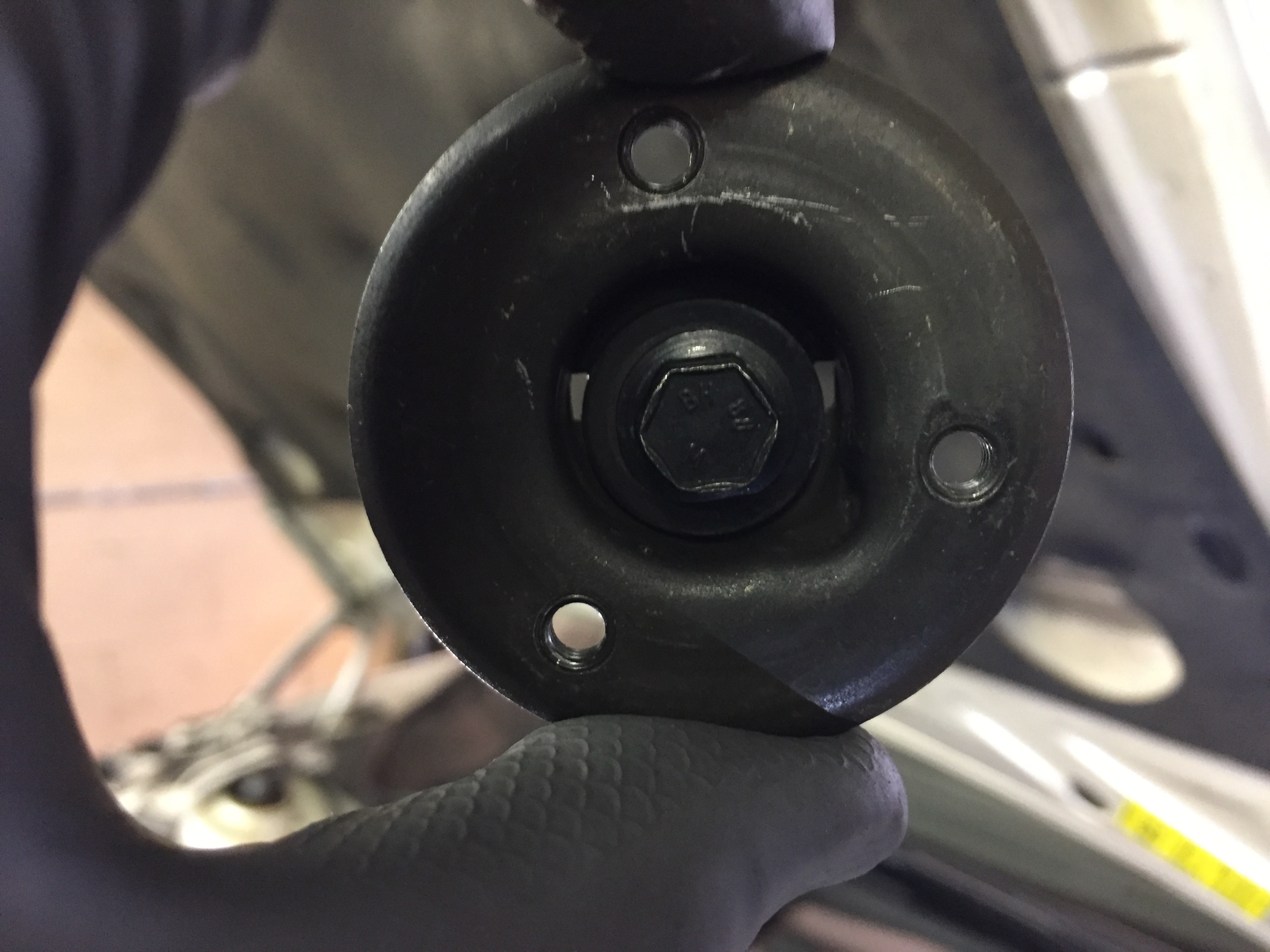

Ok, thanks. So how do I know if the camshaft adaptor is in correctly, since it is possible to put in backwards (the rotor is keyed so I know that will be correct).

Quick update and answer to my own question (and anybody else who may run into this problem): the adaptor on the intake cam is actually designed to go on one way, though you can accidentally install it 180 degrees backwards. If you look at the pic, there are 2 "keys" that fit into the cam groove. They are slightly above center, just as the notch in the cam is. I didn't notice this the first time...
