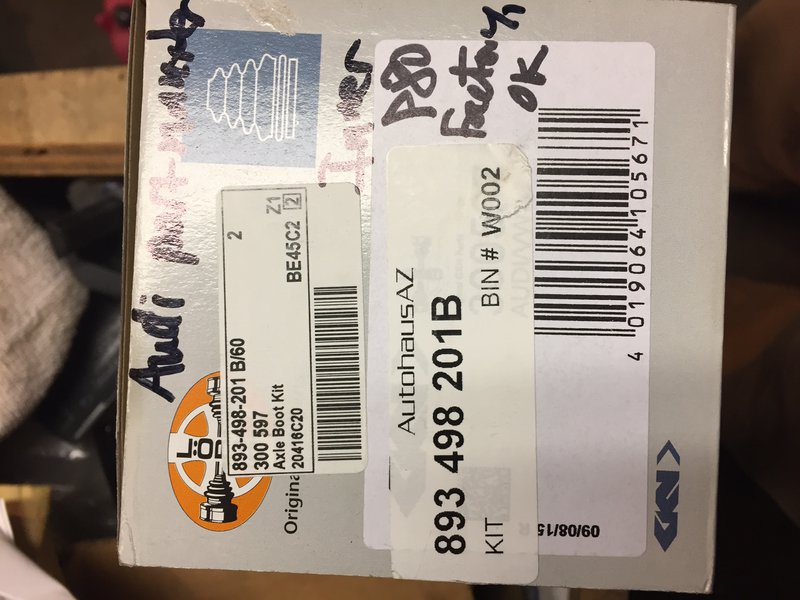

I did a turbo axle recently.
GKN 300439 outer
GKN 300597 inner (this is the "Audi boot" that is posted about elsewhere, however I think this is the same one recommended for NA axles?)
Both from AutoHausAZ

- Posts: 11803
- Joined: 25 July 2009
- Has thanked: 293 times
- Been thanked: 765 times
That's the one. Ignore the sharpie, that is just a reminder to me.

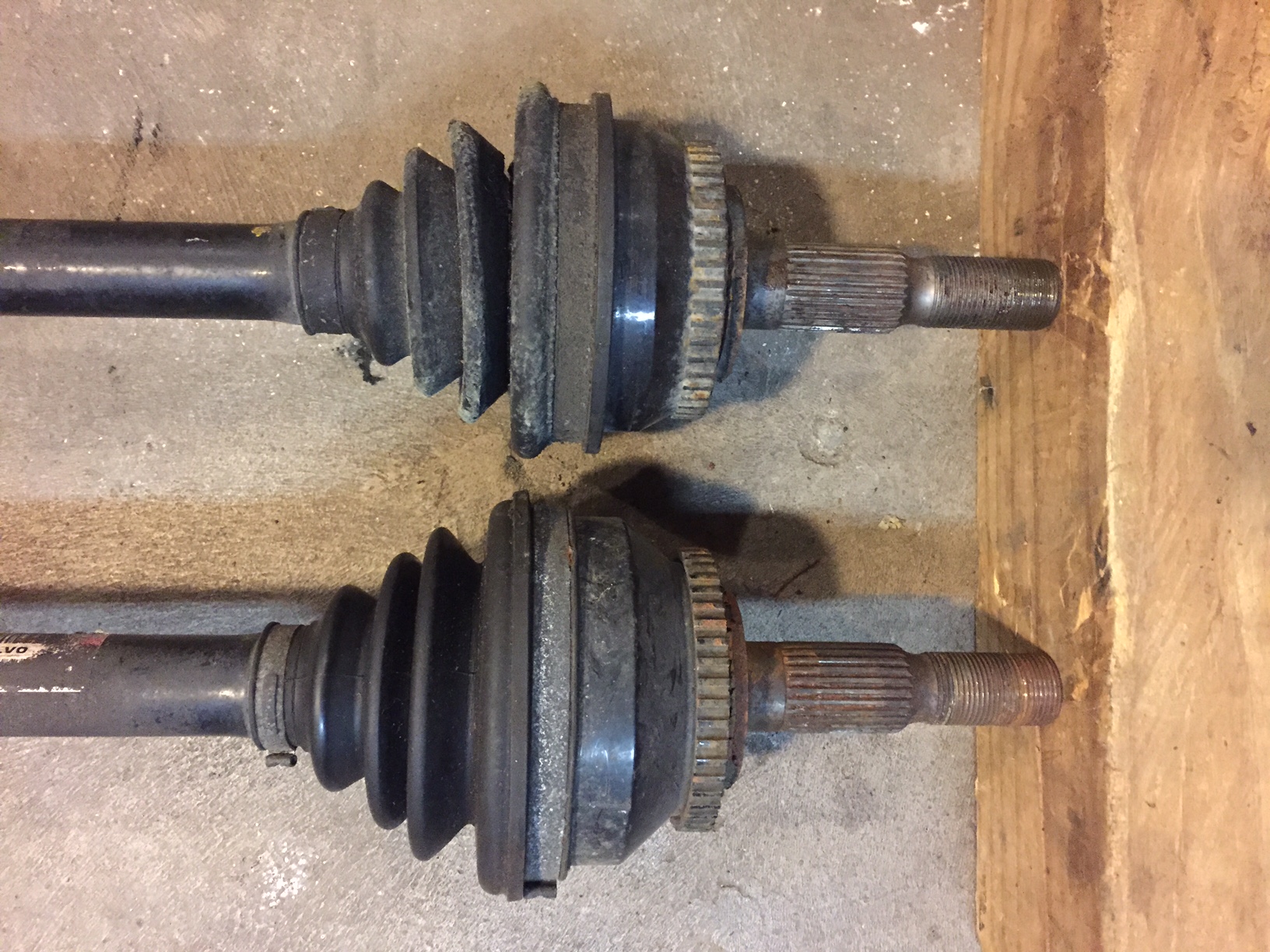

Here is a pic of the turbo and NA outer CV side by side. You can see how the NA is smaller diameter, smaller overall, with a slightly different shaped boot including the lip at the outer clamp. These are both factory Volvo axles.
