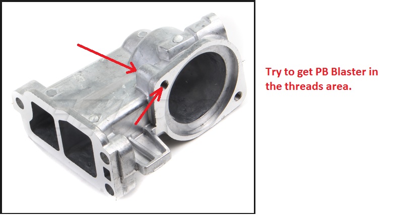

My favorite penetrating oil is PB Blaster. You can spray that on the bolts & let it seep in for 10 minutes or so. You can also do it a couple of times over a day to be sure.

These are my tricks:
1- Spray PB Blaster every day for a good week before the job.
You need to get PB Blaster.
2- Use Torx 40 as erik mentioned. The rear bolt requires a universal joint for best angle.
Whatever you do, the T40 tip needs to sit deeply inside the bolt.
BTW, clean any debris inside the bolt head first!
