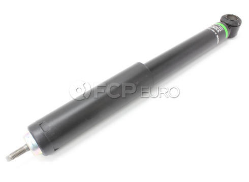

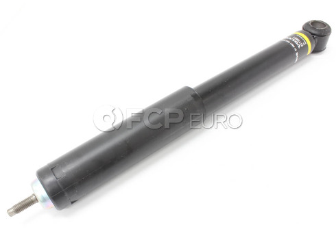

Don't know if this will help. But I saw on FCP that they had two different shocks for the V70. On the Volvo branded side of things one had a yellow stripe and one had a green stripe, each with its own part number. (And no, one of these wasn't a Nivomat!)I found it odd and had no idea why that was the case, but maybe one is taller than the other? I'm a "Gabriel" man and those don't come with any discrepancies like that.

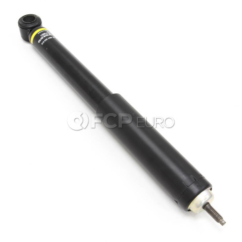

Wow, I didn't really know there were really that many options for OE Volvo shocks... I know you're supposed to check your vehicle identification plate. But since they're all probably interchangeable to a certain extent, vendors should rate them from stiffest to softest or something... I'm curious about that one that is longer for some reason... (Yes, even though I'm a Gabriel man!
Volvo Shock Absorber (S70 V70) - Genuine Volvo 9173317 $77.19
https://www.fcpeuro.com/products/volvo- ... 70-9173317
Volvo Shock Absorber (S70) - Genuine Volvo 9173318 $72.59
https://www.fcpeuro.com/products/volvo- ... 70-9173318
Volvo Shock Absorber (850 C70 S70 V70) - Genuine Volvo 9173851 $68.99
https://www.fcpeuro.com/products/volvo- ... 70-9173851

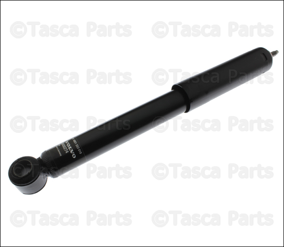

Volvo Shock Absorber - Genuine Volvo 8600274 $61.97
http://www.tascaparts.com/oe-volvo/8600274
