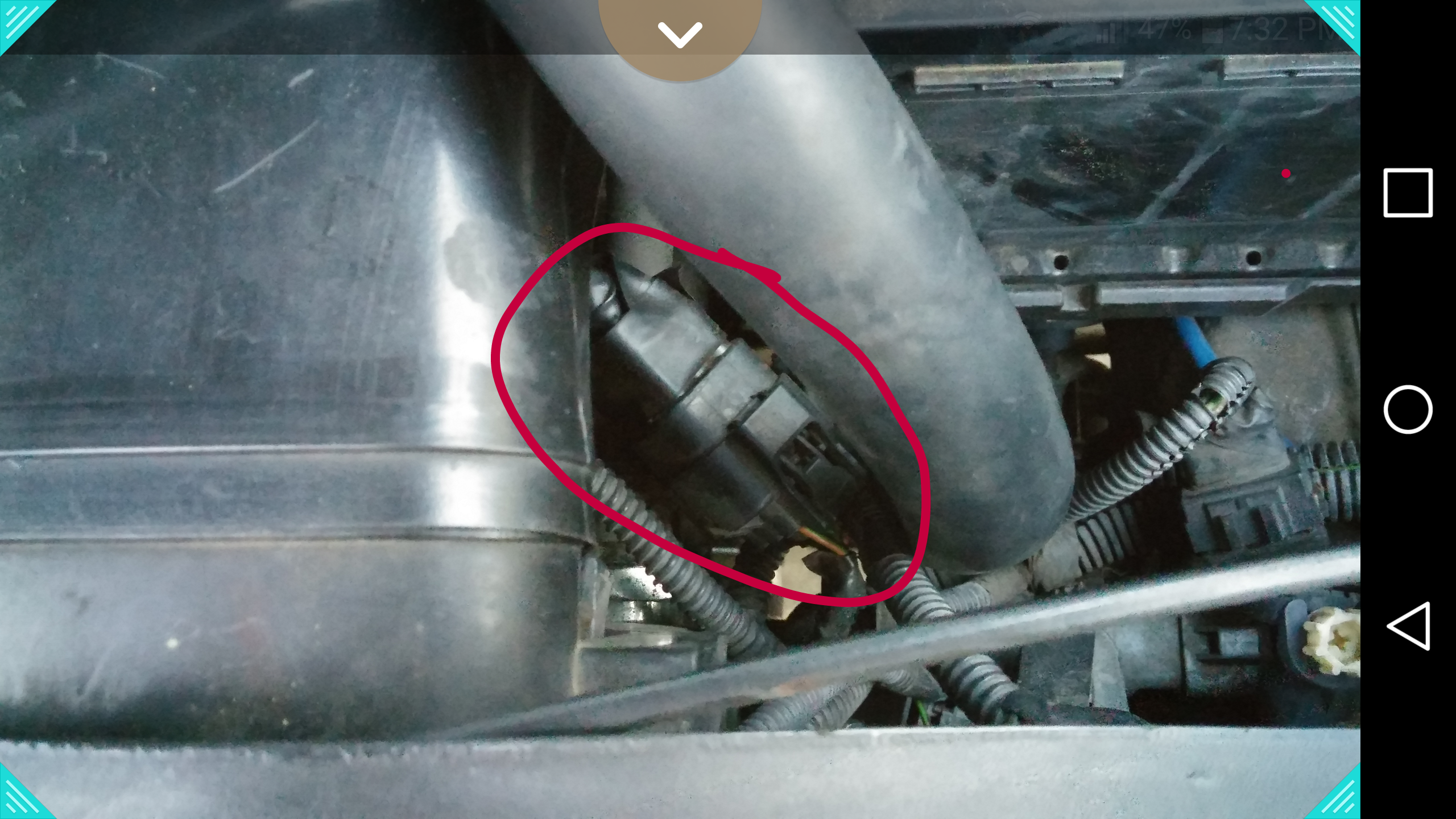

Back when my transmission was doing that, it turned out to be a smashed connector near the air box and fan. I'll post a picture later, couldn't hurt to check.

Those OBD codes definitely seem wiring related. I had P1618 when my connector was broken. I'll post a picture soon of the connector I'm referring to. I believe it somehow links the TCM to the transmission, but I'm not completely sure. Basically, it was interrupting communication between the ECU and TCU, therefore my transmission was stuck in its fail safe program. It sounds awfully similar to the issues you're having, except this seems to be on a larger scale.
You may want to check all visible connectors under the hood, and maybe pull off the wiring harness cover(s) near the ECU box and make sure all wires are in tact. It could be that a wire's coating has stripped down over time and is shorting out.

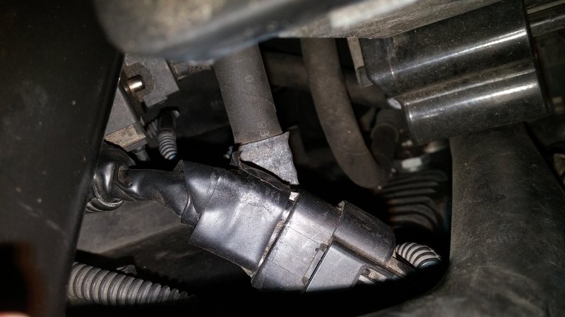

Pictures... the connector with the electrical tape on it is the one I repaired. These larger connectors tend to be quite important... make sure all of yours (that you can see) are in tact.
This is between the intake hose in front of the air box and the battery if it's hard to see.
