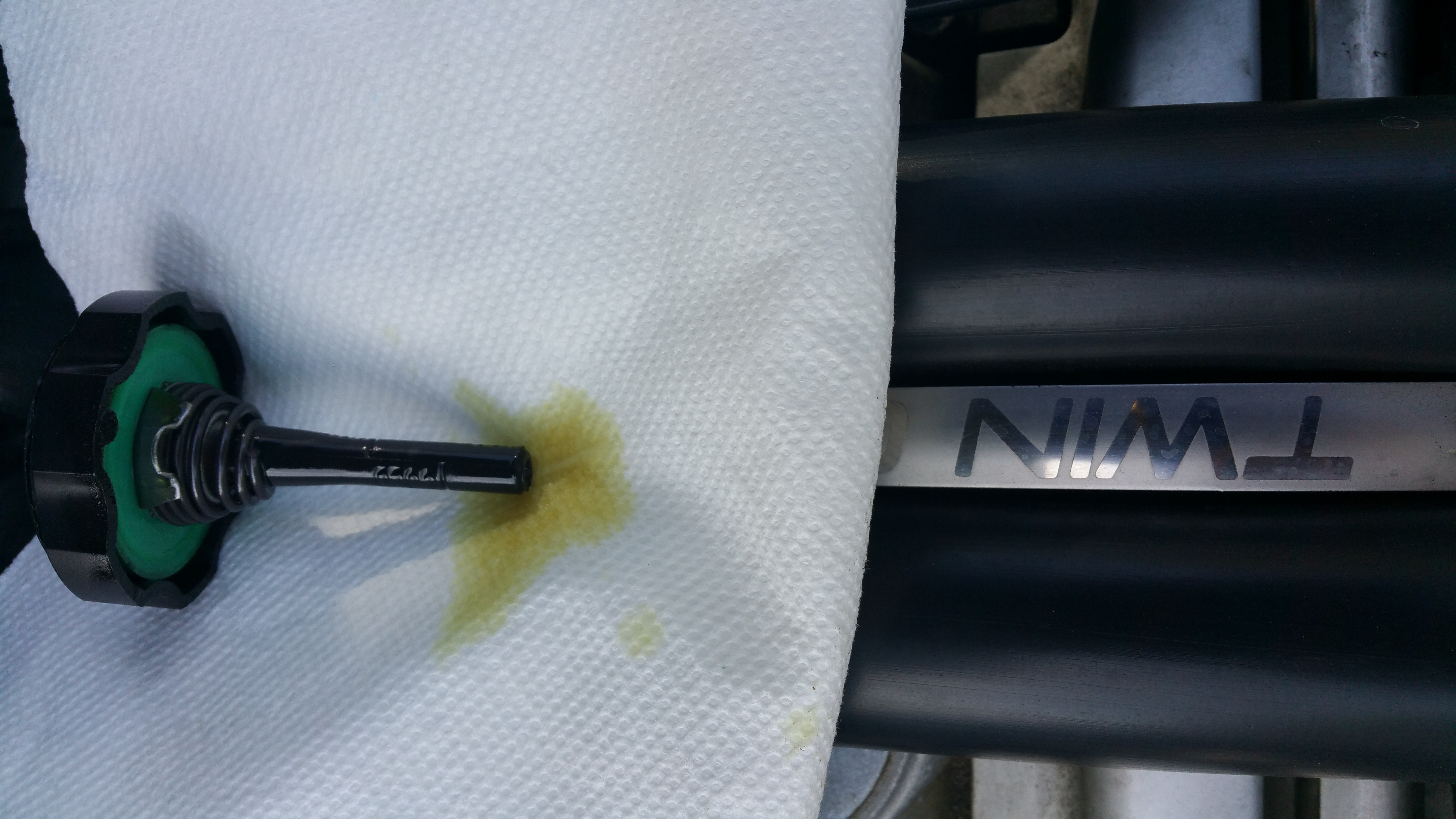

After getting a private message about the steering fluid I thought it best to add photos of what mine looks like and the portion bill for the replacement of the rack at my Volvo dealer who returned my car March 18, 2017. They definitely did not put red fluid in, the bill has a part number with a thirty something dollar charge for the fluid. I am lucky that Osteen Volvo Service is excellent as was Tampa Volvo when I lived down there because I am sure not all dealers are so careful like putting cheaper transmission fluid in the power steering rather than the correct clear oil. I assume there is a difference since the factory fill was clear. June
