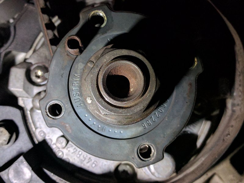

i think i found the problem it is the cvvt on the inlet camshaft.
i can turn it but it not comes back

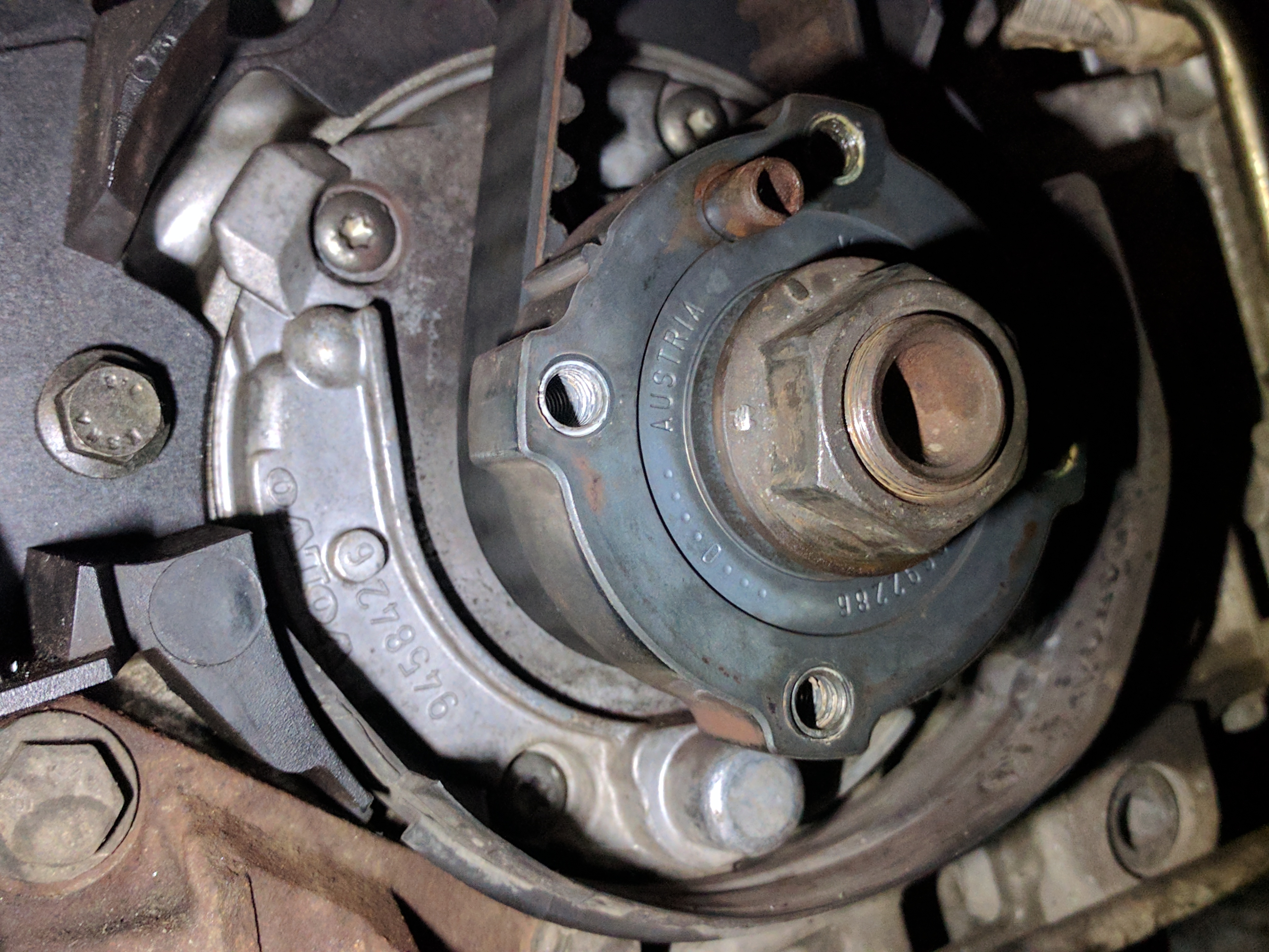

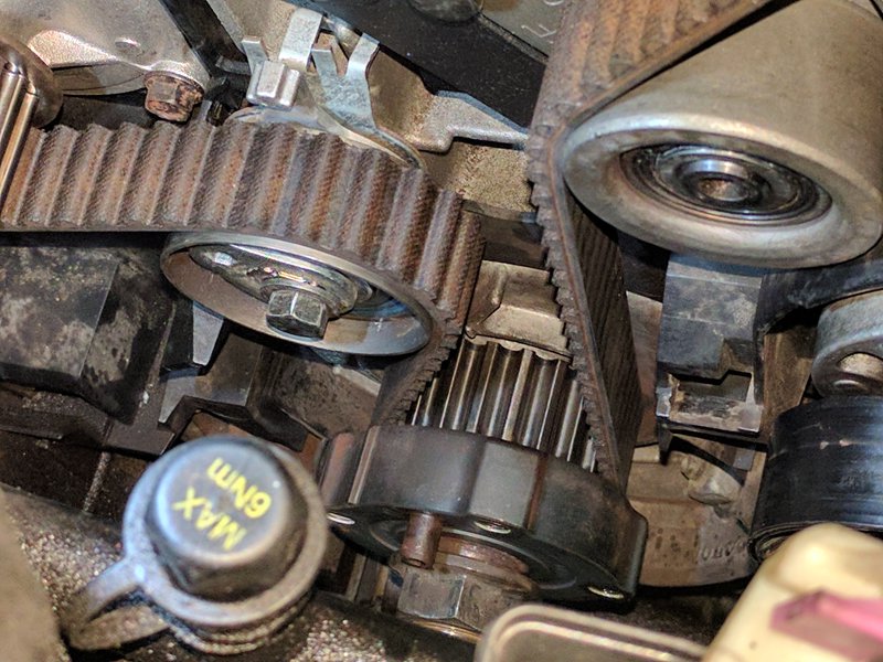

timing belt marks are ok, i also checked it on the other side of the cylinder head i can put in the special tool to lock the camshafts.
is it possible that the ccvt is damaged, is there a way how i can check it ?

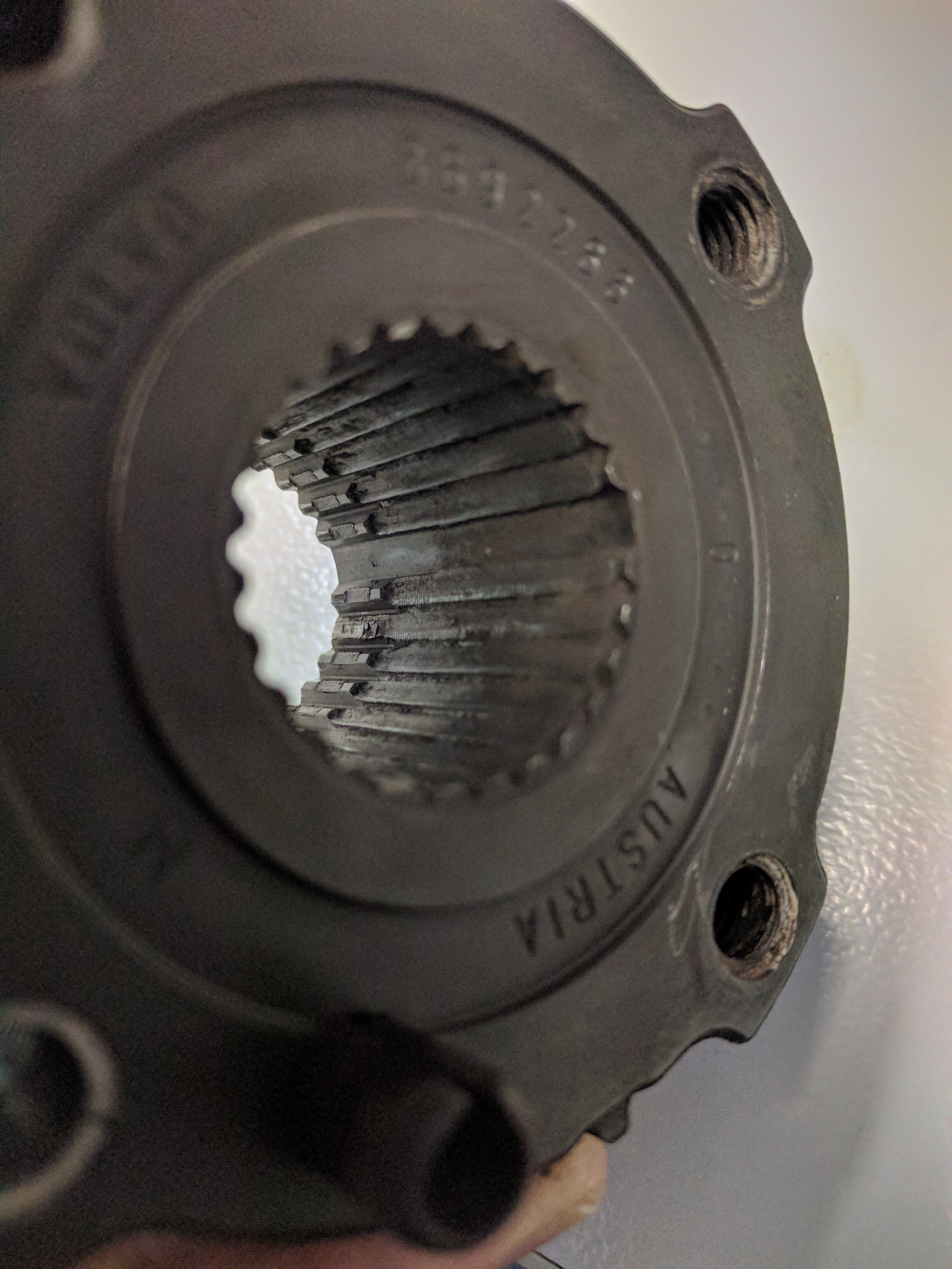

Yours is not the first stripped crankshaft pulley. Actually this is about the 4th one I've read about on Matthews but I've been around here for quite a while. You're pretty fortunate it was only 2 teeth and good work finding the culprit.
Great thing is you don't have to go far to get a new one!!
