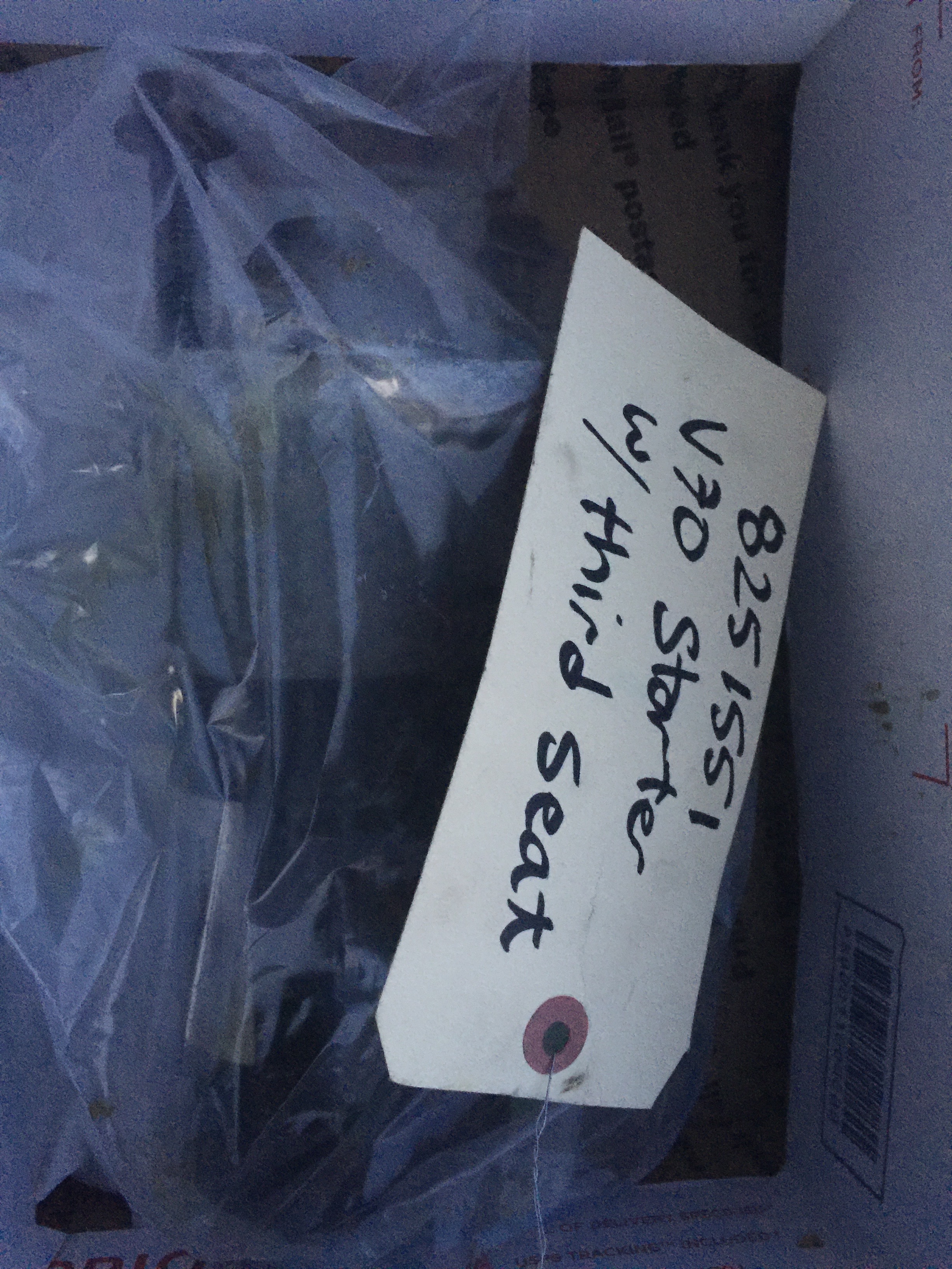

DrJ ..I pulled an almost brand new one off my parts car...
Snip...
Starter 8251551 Like New $108
Text to five one eight 368 five five eight six as I'm in part of the world where I can't use local wifi.
Snip...

Double checking before I ship - you do have third rear seat, Right??
