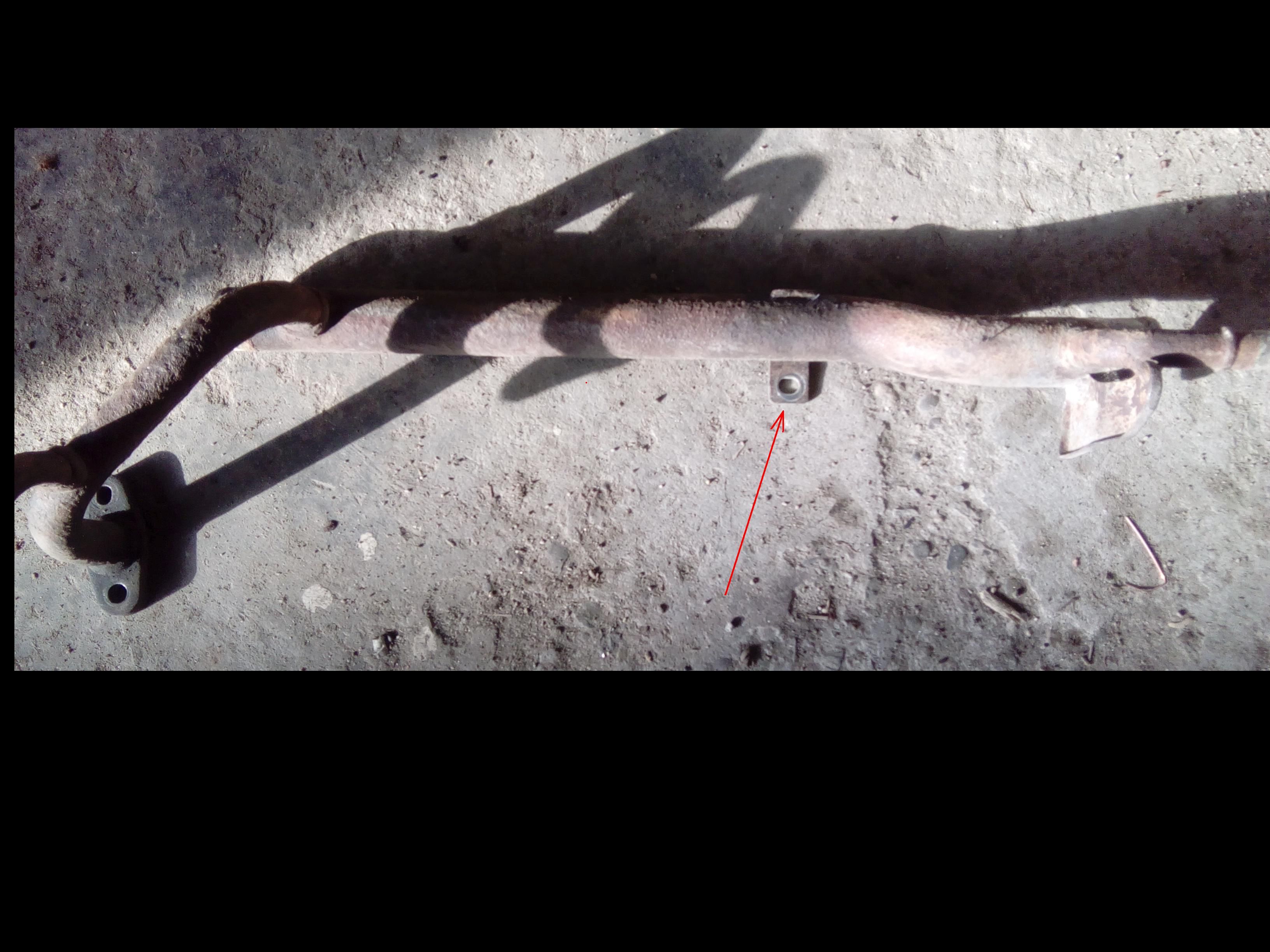

Didn't you forgot to remove this bolt?
Not pressed, just inserted using an O-ring. Not too difficult to replace it.rspi wrote: 09 May 2017, 19:53 That pipe is pressed into the back of the engine close to the water pump. I don't think I would try to replace one unless I had the engine out.

That bolt is the one I can't seem to find! Is it tucked behind the exhaust where it is inaccessible without pulling the manifold? Thanks so much for everyone's replies this really helps.
