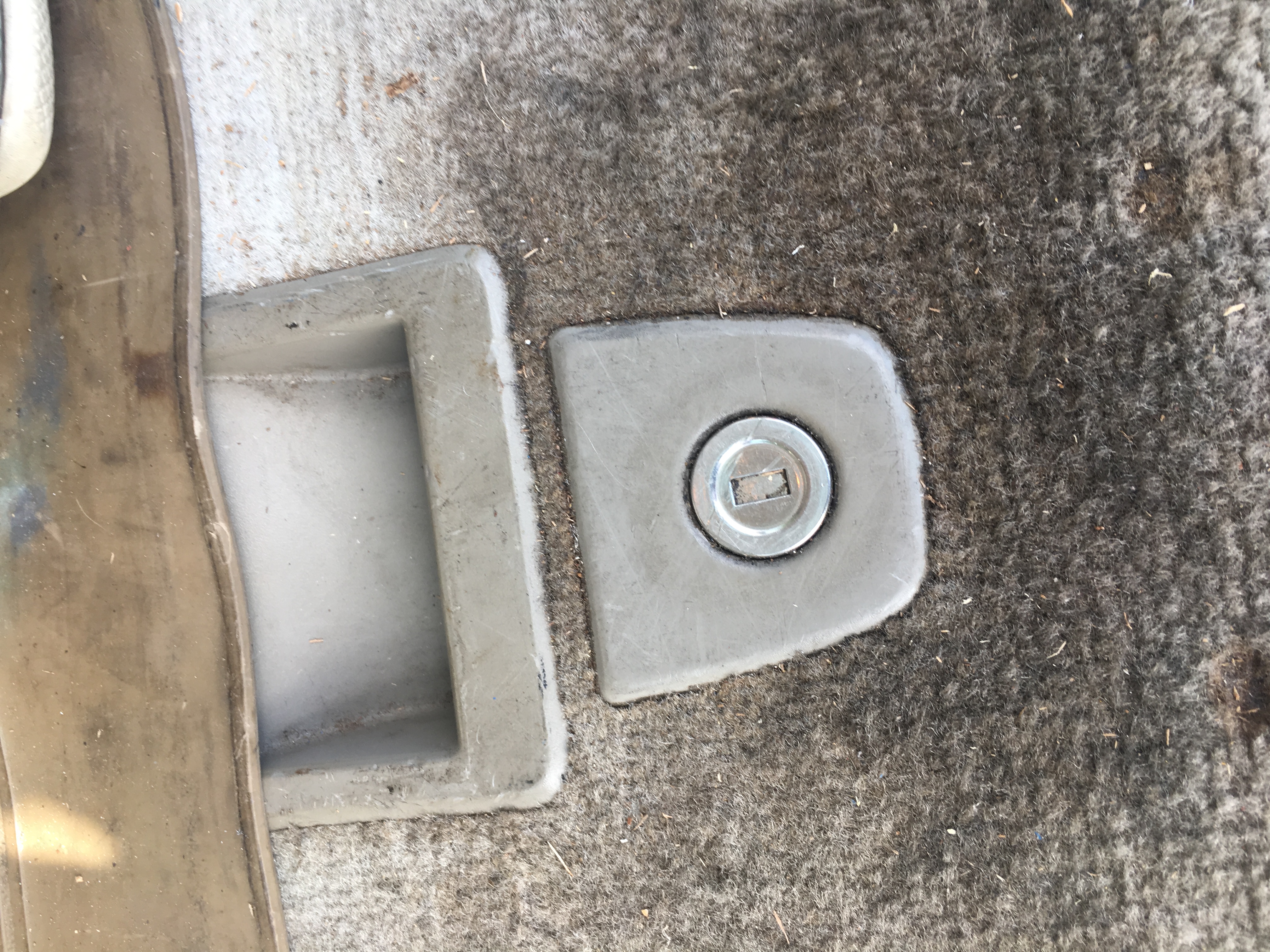

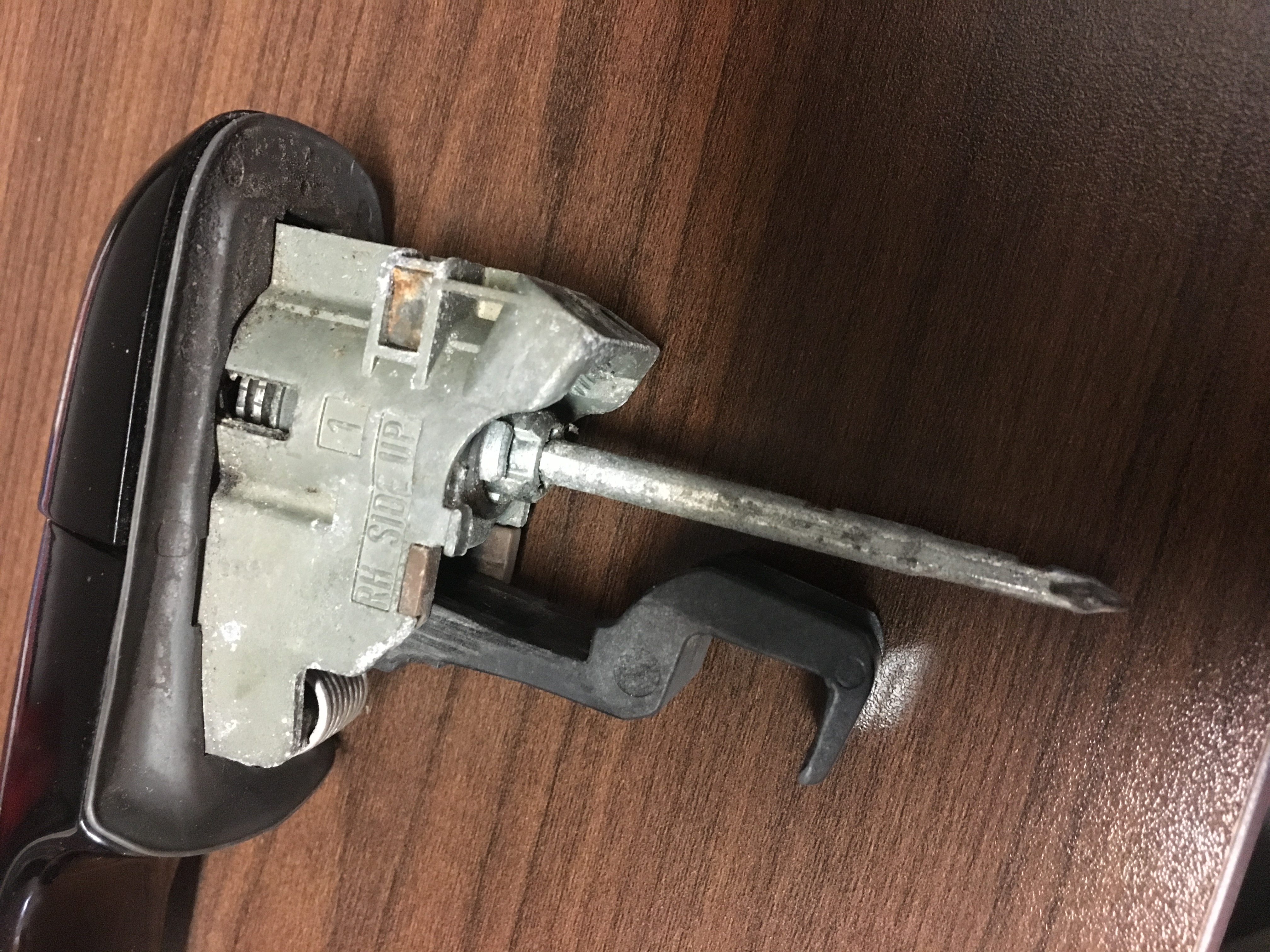

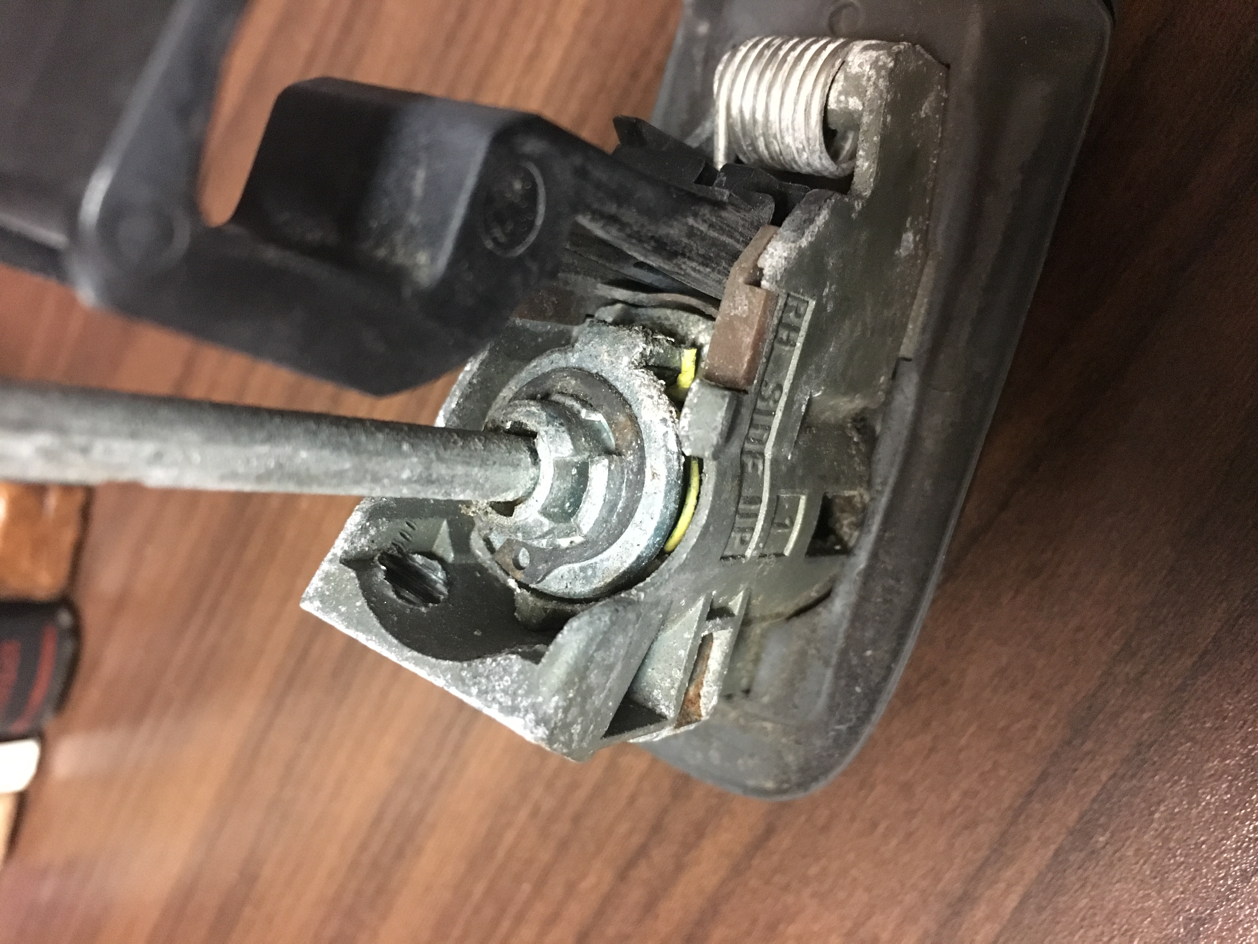

I bought a drivers door handle off another car at the junkyard today. The handle fits fine and I know there will be no problem there. My question is related to how can I re-key this handle to my current key? I noticed that in my cargo area my rearmost seat includes a lock mechanism why I do not know...could I repurpose this rear lock tumbler into the door handle?

The lock cylinder from the cargo hatch will not fit. It (the cargo hatch cylinder) might fit the glove box but that is about it. As I recall there is a plug in the lock cylinder hole on the passenger's side door handle on the 70 series and my guess is that the same style cylinder for the driver's side will fit the passenger's side. To do this correctly you would want to order a cylinder to match your existing set of keys but that is a pricey mistake if it doesn't work.
If I were dead set to do this rather than fix the keyless entry I would be inclined to buy a pick-n-pull cylinder with a key to try it. You need the key to remove the cylinder from the handle. If it works with the pick-n-pull version then and only then would I pay to have the correct cylinder made.

I'm also wondering - Do the passenger side 70 series latches even
have the latch rod attachment to connect the lock cylinder rod?

So...Ozark Lee wrote: 30 May 2017, 19:35 The lock cylinder from the cargo hatch will not fit. It (the cargo hatch cylinder) might fit the glove box but that is about it. As I recall there is a plug in the lock cylinder hole on the passenger's side door handle on the 70 series and my guess is that the same style cylinder for the driver's side will fit the passenger's side. To do this correctly you would want to order a cylinder to match your existing set of keys but that is a pricey mistake if it doesn't work.
...Lee
The door handles are totally interchangeable based on my experience. The little trim plate with the keyhole and the blank ones can be changed.
The thing I don't know is if all the lock mechanisms feature the female end of the lock cylinder rod...in other words the lock cylinder could be put in any of the handles, but do all the electronic door locks have the ability to be opened via the turning lock rod in the key operated driver door mechanism? I will have to look in my storage room tonight as I have an old passenger side lock system. Will report back on this.
Are you sure you need the key to remove the locking cylinder? That seems odd because wouldn't one of the main reasons for replacing the cylinder be because of things like a key broken off inside the mechanism or some other physical failure of the cylinder which would or may render the key unusable?
