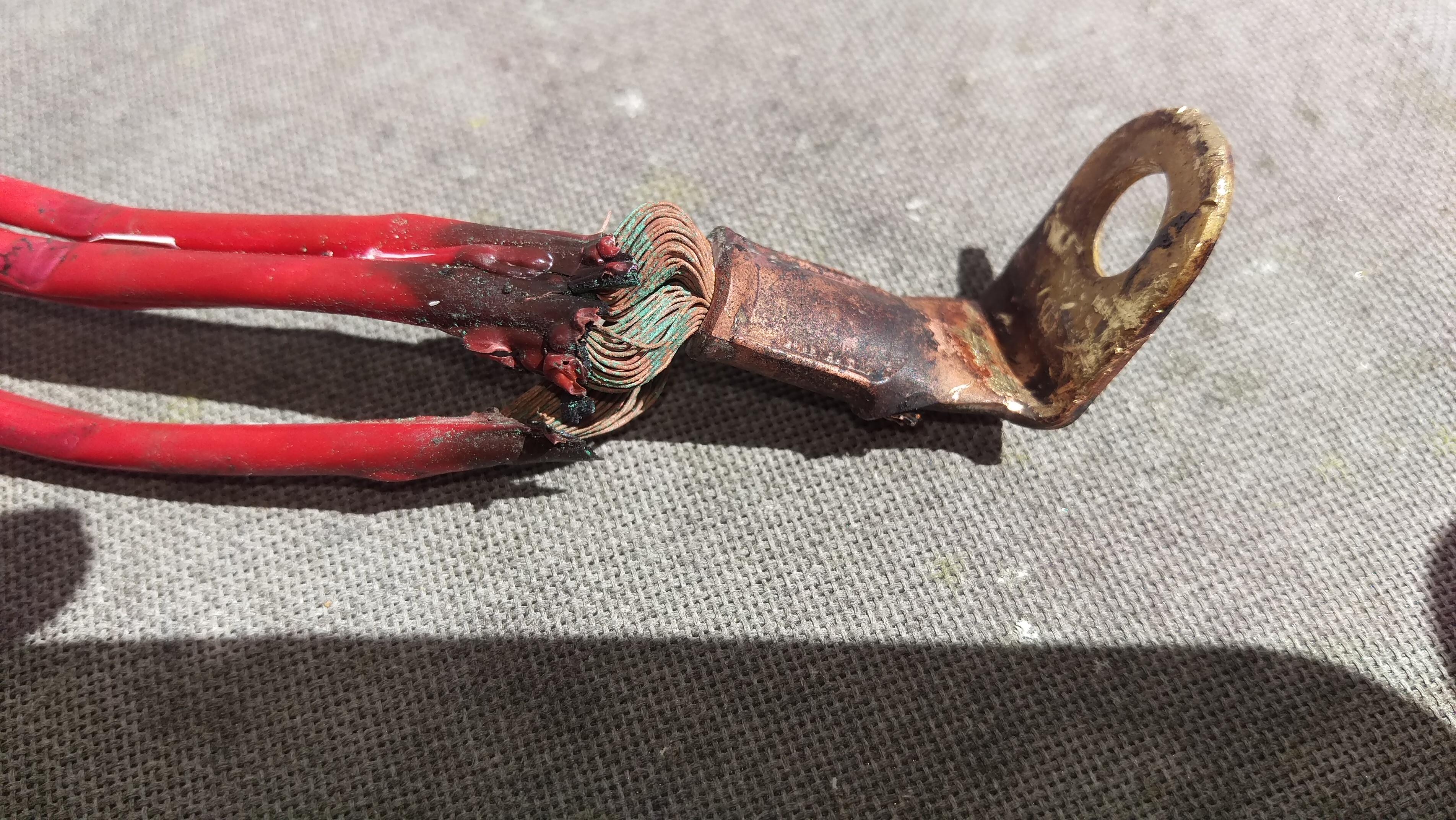

I replaced the B+ cable as the next step in diagnosis. Yup! That was it!!
Cable end in fuse box had green wires and insulation melted.
Evidently, the voltage drop from battery to fuse box was so great clutch could not be energized.
BTW, nut on B+ cable was only finger tight. My theory is heat/cool cycles loosened the nut and that led to arching which damaged the wiring by overheating. B+ cable was replaced in 2013 by a guy I really trust. I am 99% sure, that nut was tight when he installed the new cable in 2013.
Check ever 6,000 miles or so to be sure nut is tight and use dielectric grease on both ends.

That is exactly what my 'B' cable looked like. For some reason it affects the 99-00 more than earlier cars, although earlier ones should also be carefully checked. Biggest issue is you cannot really see the affected area without dismantling the main fuse box. One tell-tale sign is the top flange end of the cable under the nut discolours from shiny copper to a dull matte finish.
