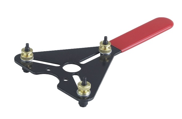

A Puller 'plate' must be used to remove the clutch plate, and even with this puller it isn't fun, as mentioned above. If you force on the clutch with a screw driver or alike, the clutch plate springs will bend and may become unusable.

The clutch plate is removed with three 4mm bolts, not this this tool. I changed the whole clutch/pulley/coil assembly, comes as one unit. If the bearing is shot, you may as well change the whole assembly. If the compressor is shot, buy the entire unit, pulley and all.oragex wrote: 25 Jan 2018, 06:54A Puller 'plate' must be used to remove the clutch plate, and even with this puller it isn't fun, as mentioned above. If you force on the clutch with a screw driver or alike, the clutch plate springs will bend and may become unusable.
