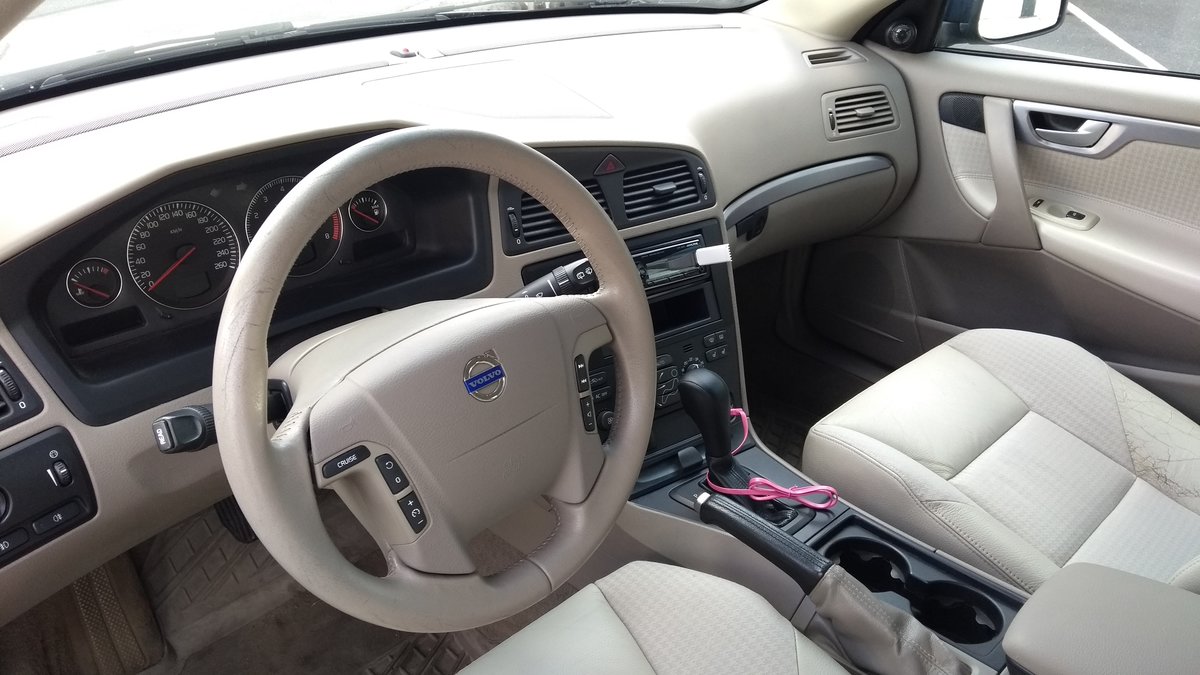

I've fitted a standard single DIN Alpine head unit in my car. The stock HU-603 together with the door speakers were broken. No steering wheel buttons but otherwise it works fine. The bluetooth handsfree microphone isn't top of the line but it works. You can see some of it in the picture below. I run two amps beneath the floor in the boot from it. A 4-channel for the doros and one that feeds a stock subwoofer. Tried feeding the stock amp under the seat at first but that didn't sound too well.
When I need navigation I clip my phone onto one of the vents just above.
