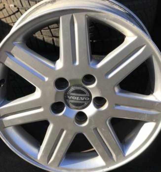

I saw an ad for some used volvo rims that I couldn't find on that page.
They looked like this:

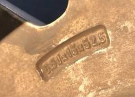

but the size is apparently 6.5x15x52.5
I've found several references that point to a lot of volvo models (850, S70, s60, s80 etc) having a max offset of ~43.
So I'm assuming those rims I've pictured with a 52.5 offset will NOT fit my 1999 s70 properly. Correct?

Look closer, the size is 6.5x16x52.5 not 6.5x15x52.5. Look at the bottom .. loops all the way around .. it is s Six not a Five.
The style is called "Caligo" and was used on the C30, S40, V40, V50. It is a Silver painted, Aluminum Alloy Wheel.
The Volvo part number is 86982204.
I've found several references that point to a lot of Volvo models (850, S70, S60, S80 etc) having a max offset of ~43.
For your 1999 S70, depends on who you ask. Some say 35 to 50 mm others 34 to 45mm. I would not chance 52.5 mm.

Thanks for the quick reply. I thought it was a 15 because the top of the number didn't look like the top of the 6 in 6.5.
At least it didn't when I first looked at it. The longer I stare at it the more it's turning into a very clear 16 in my mind. :-)
