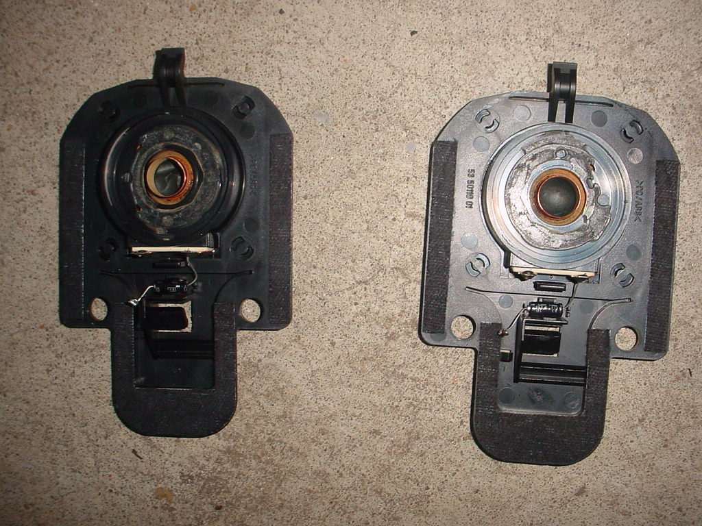

The rear deck speakers for an 850 sedan are unique in the speaker world and their tweeter magnet glue isn’t any better than the front tweeters. I had no sound whatsoever coming from the rear deck speakers and once I popped them apart I found out why.
DIY replace speakers
Even the main cone won’t move when the tweeter magnet falls off and sucks itself into the woofer cone.
Both of my rear deck speakers had the tweeter magnet that had fallen off.

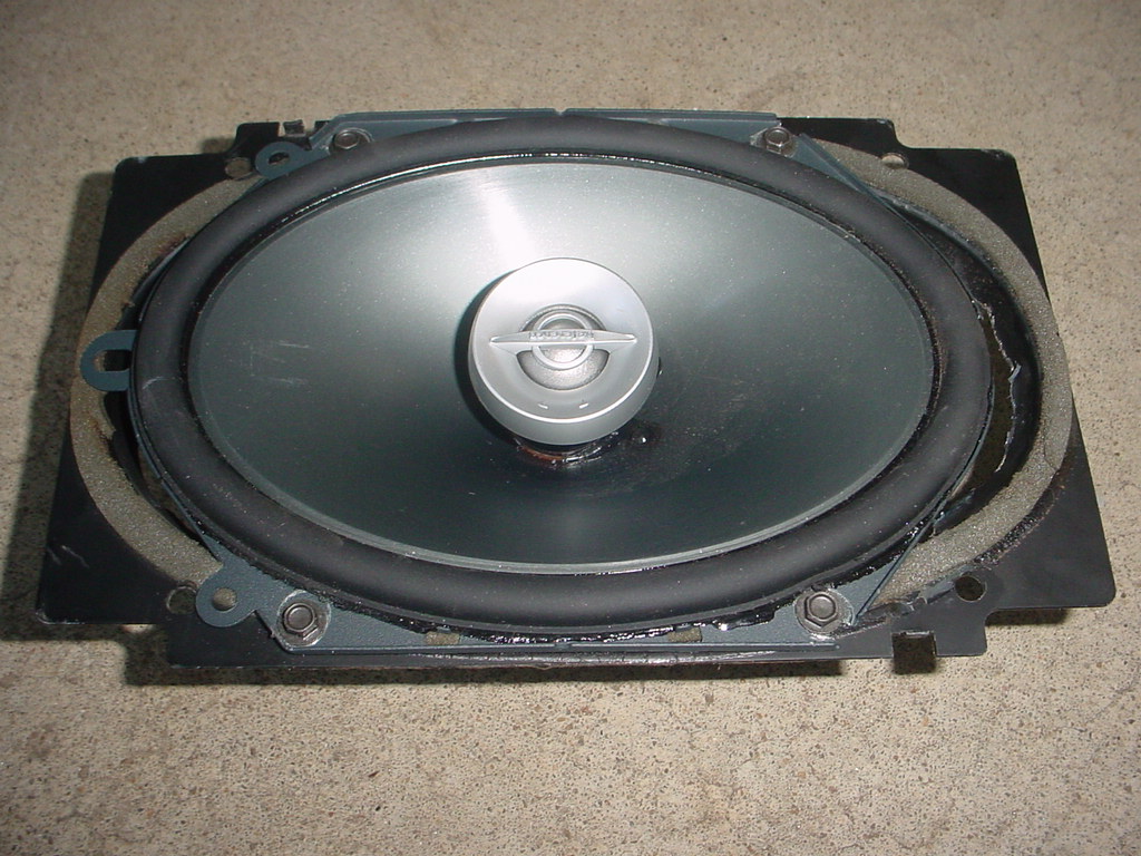

After buying the wrong (6×9) speakers the first time I measured the Volvo factory speakers and they are sorta 5 ish by 8 ish. Standard 5×7 speakers will fit in the hole but no aftermarket speaker that I can find will screw into the plastic base plate on the factory mount. I purchased a set of Infinity 6812i’s. Since my factory speakers were trash I figured I would use their factory metalwork to fabricate some mounts.

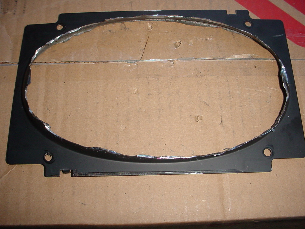

In order to save the mounts I took an angle grinder and sawed through the webbing at the back of the woofer cone until all of the webs were severed. (If you don’t have an angle grinder you can use the hack saw blade that is left over from fixing your glovebox.) Unfortunately I can’t take a picture and angle grind at the same time but sparks fly and metal cuts. On my speakers the tweeter was suspended over the woofer on a metal bracket. It only takes a pair of pliers to straighten the tabs and remove the tweeter bracket. After cutting through the metal webbing I took a utility knife and cut the foam from the outer edge of the old speaker. I now had the old speaker top plates without the bad speakers. I dressed them up a little bit with the angle grinder to get rid of the rough edges.
The old Volvo speaker top plate with the original speaker sawed off.
The next step I took was to center the 5×7 speaker in the old hole on the factory top plate and secure it. I’m lazy so I went to Lowes and picked up a pack of self drilling screws. I placed the speaker – more or less centered – on the old factory plate and secured it on all four corners.
The new speaker from the bottom side.
The new speaker from the top side.
The next step I took was to solder the factory wiring harness to the new speaker. As unintuitive as it was, every wiring diagram I found showed the black wire as the positive wire. Since the wire with the red collar was negative on the front door speakers I guess it makes sense?.
From this point installation is the reverse of disassembly. Plug in the speaker to the wiring harness, secure the four aircraft nuts, and crank the tunes.
