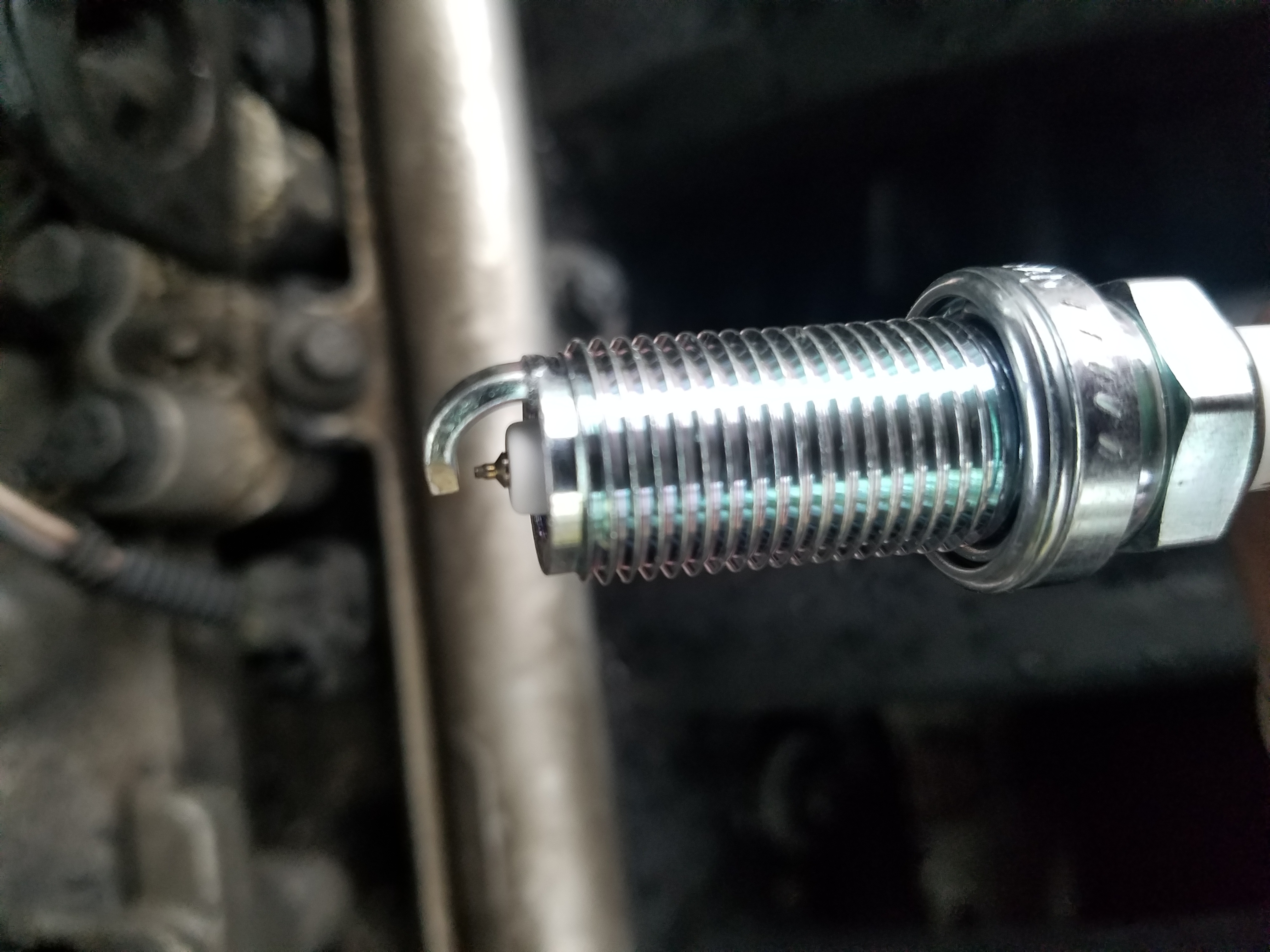

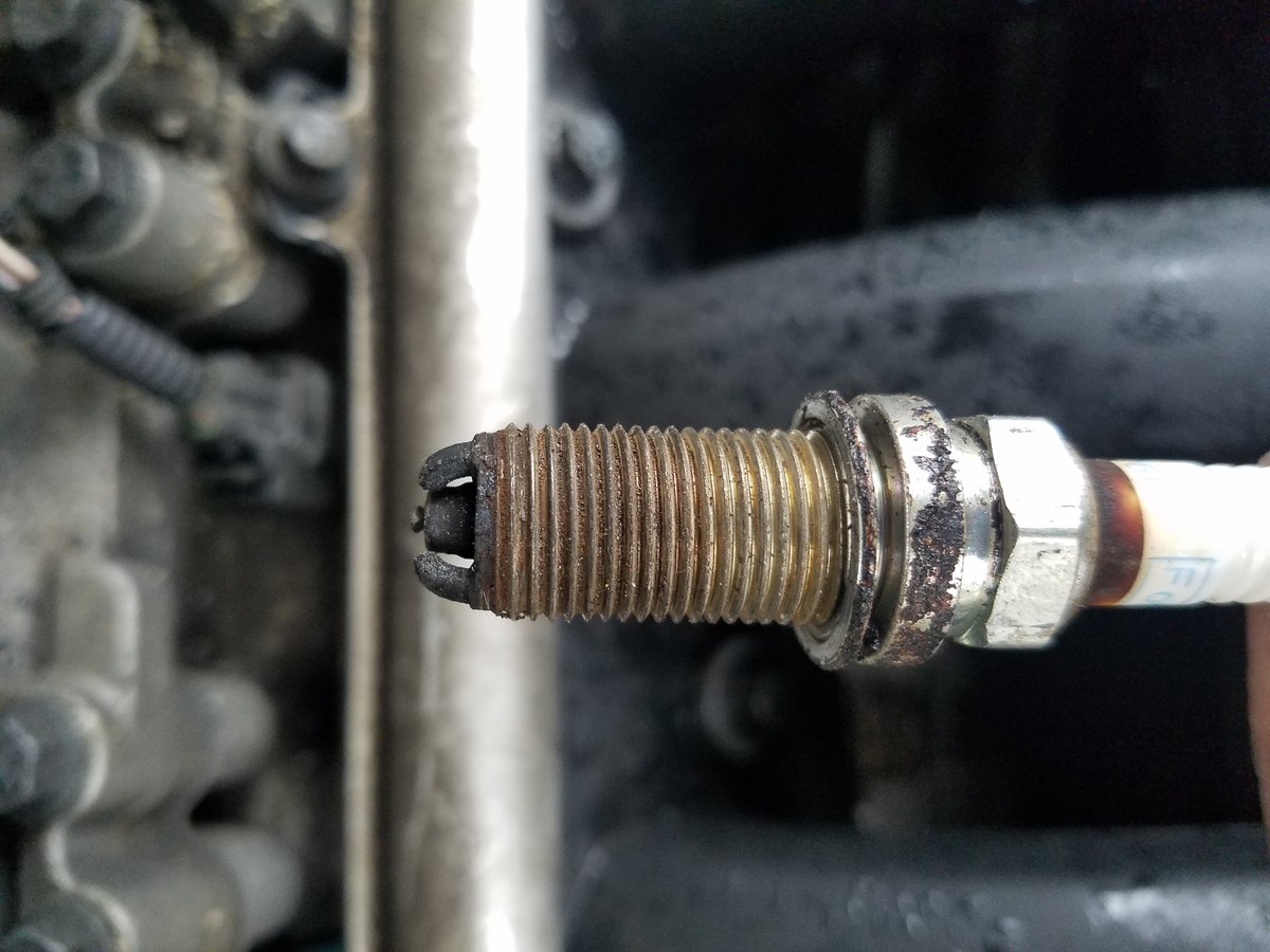

Post by ChillPhillyPhil »
They are supposed to be gapped to .028 according to NGK Spark plug website and another forum I read said .032 to .028.
I gapped mine to .032 they came out the box at .040
I was being cautious because I read .028 to .032.
I used NGK Iridium IX.
