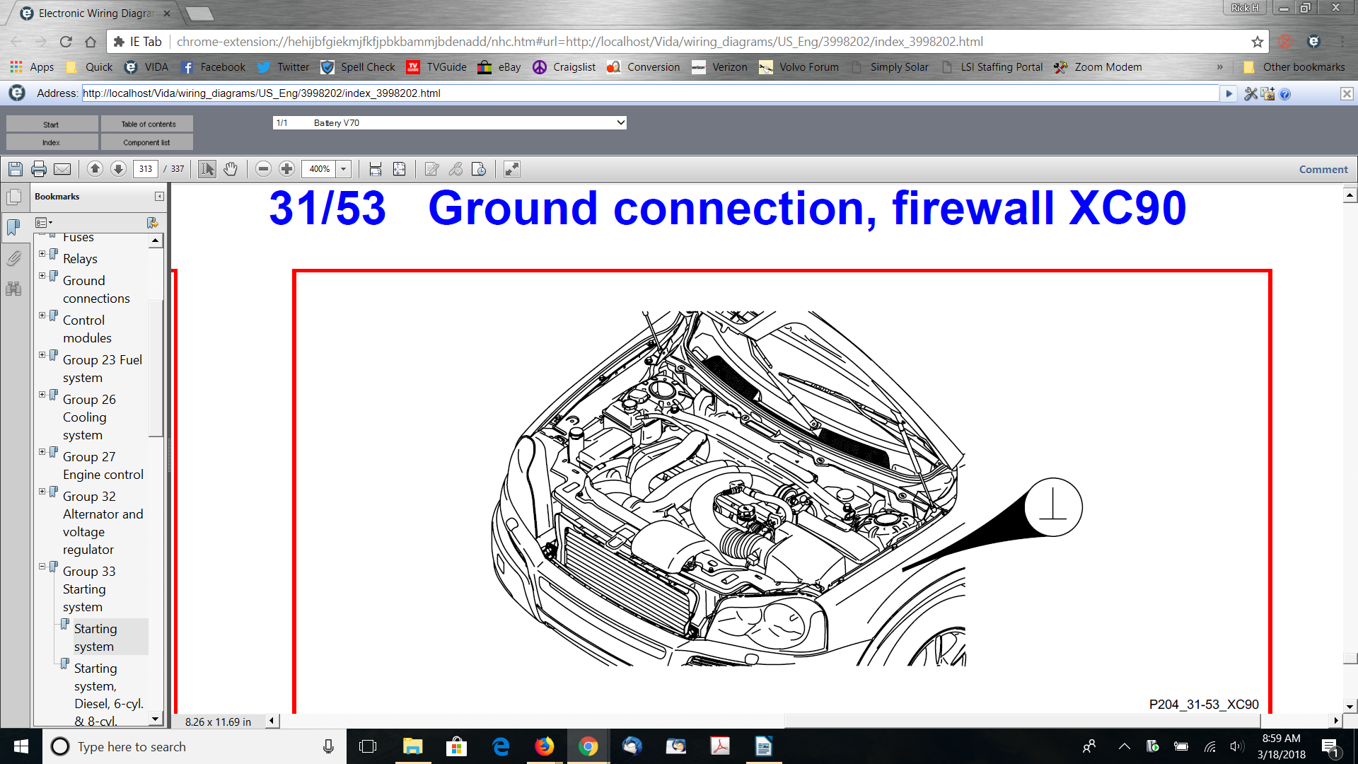

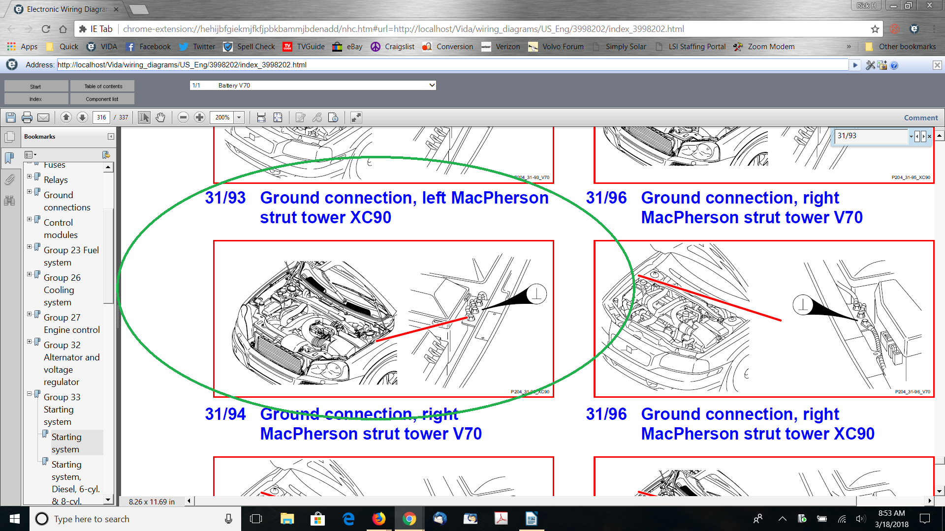

From what I can see in the wiring diagrams.
Coming of the negative battery cable, the cable runs all the way to the firewall (31/53) without interruptions or electrical junctions. So the one on the firewall (31/53) would be the root "earth" as you call it. From that point the secondary "earths" branch off.
The only other "earth" that might effect the starting system is the one at the left strut tower (31/93).

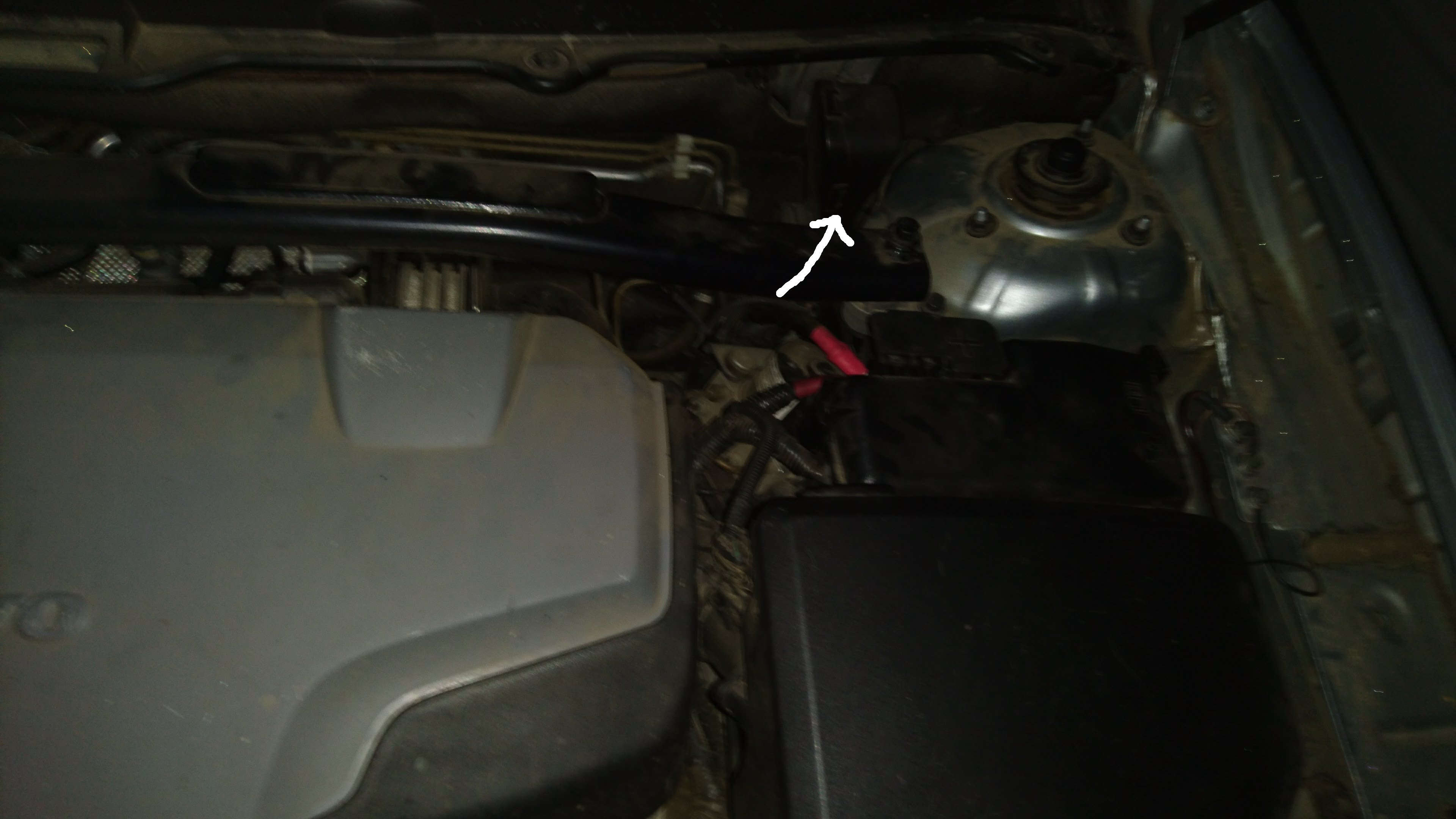

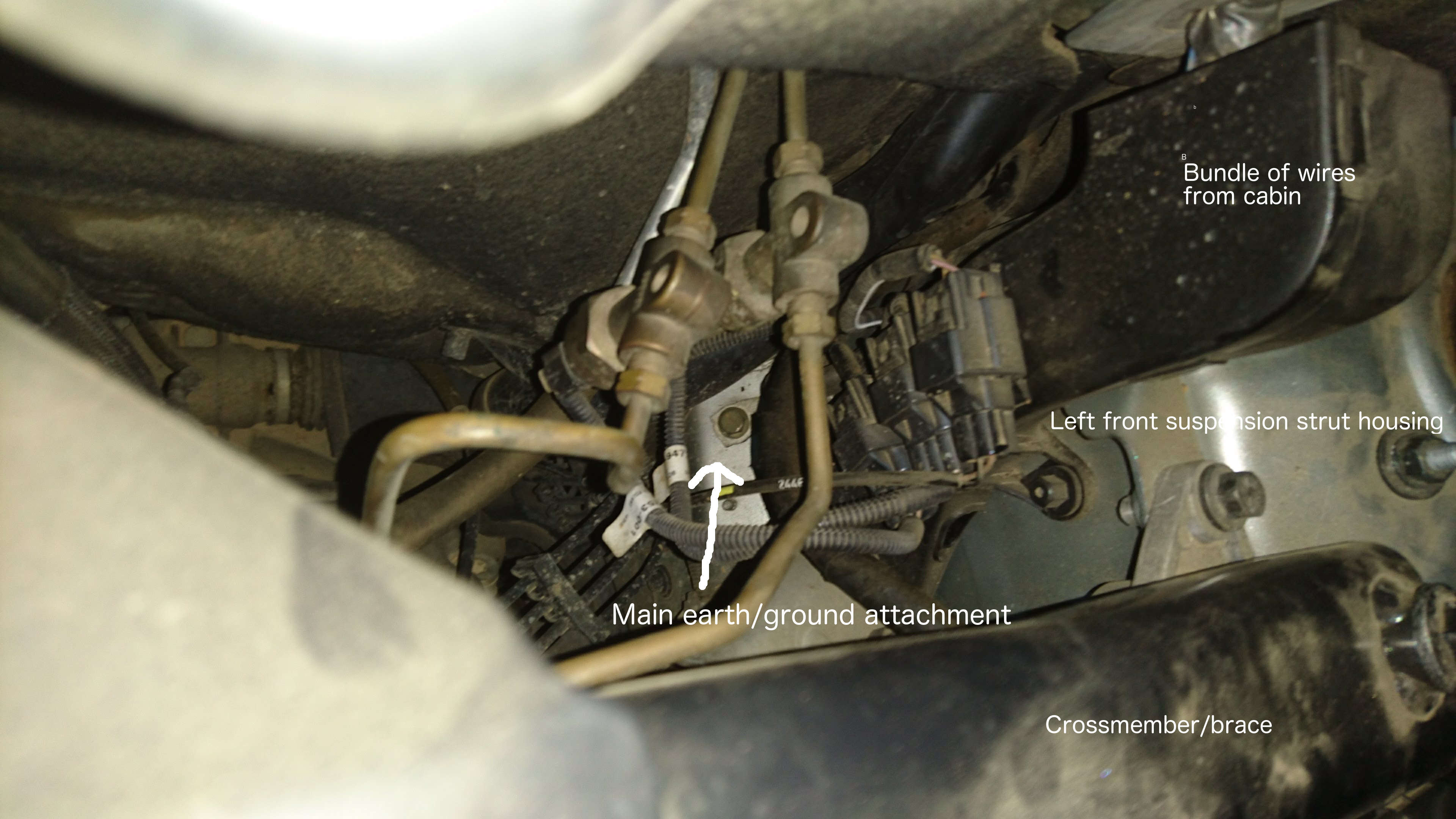

Okay, so thanks to Rick's diagram that was an easy find. Not quite on the firewall, it's kind of at a junction between the left suspension strut housing and the firewall, directly below a plastic box that shields a bundle of cabin wiring. Hopefully these two photos are helpful. I'll have a go at cleaning it up tomorrow.

That bolt is easy enough to see, and getting a socket on to is easy enough, but getting your hand down there to pull it out isn't that easy! The bolt has about 20mm of thread, but only the top 3-4mm is engaged with the bodywork, and these threads were full of white corrosion powder. And yes, the face of the bodywork that the big metal tab on the end of the earth lead is pressed onto was well and truly painted. Even the bolt was somewhat painted!
So I replaced the bolt with a stainless one, cleaned out the female threads in the bodywork, ground the paint off the bodywork with a Dremel with a conical grindstone, and cleaned up the tab too. Put it all back together and (after leaving it unstarted for 24h when symptoms are usually worst) hey presto - no difference! [long, slow, pained groan]
