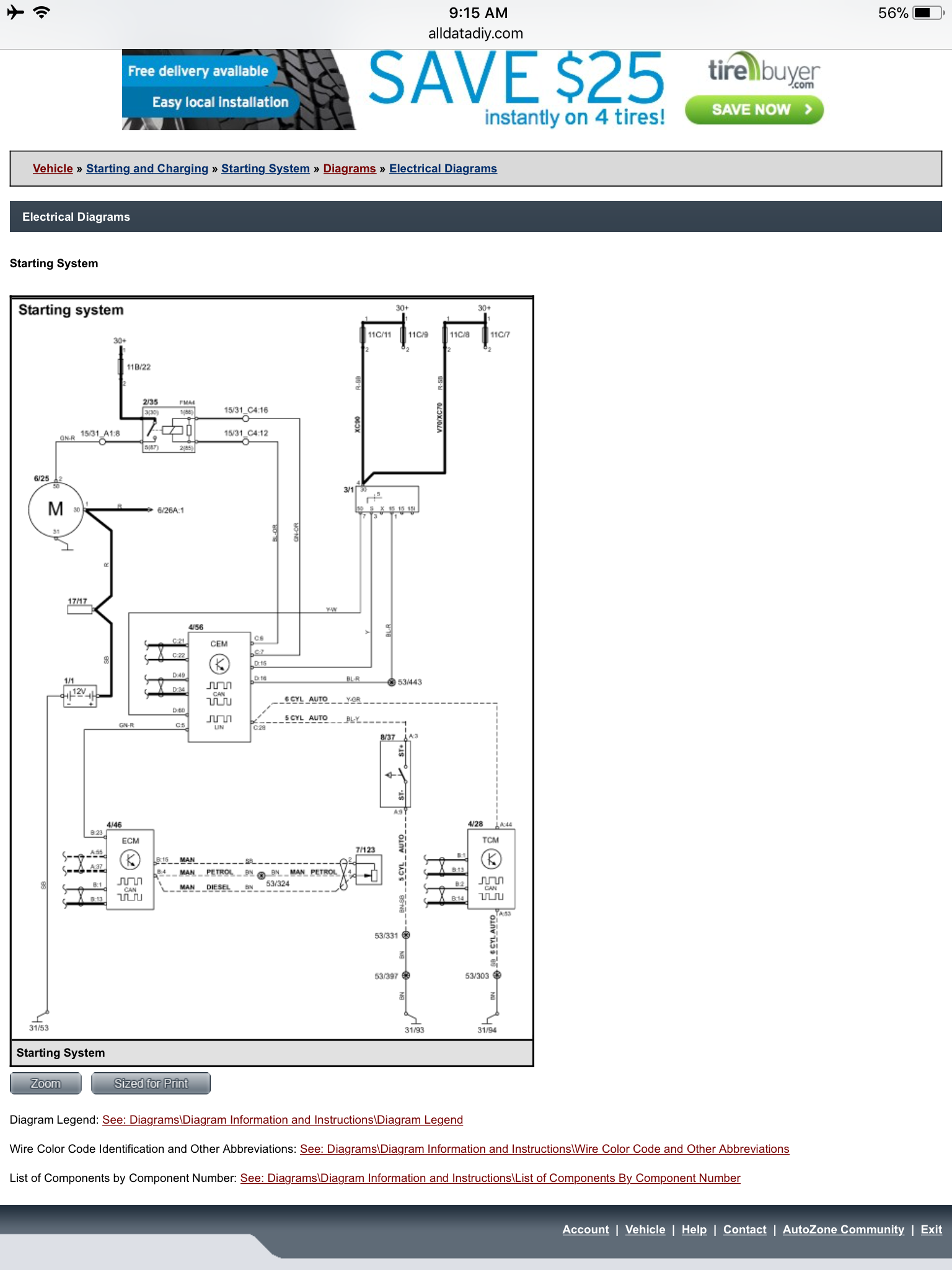

Very reliable. If you search for ‘starter bypass , in this forum you can find the wire that lets you bypass the immobilized system for cranking , I think your 2001 has the same wire?
Ah, no. You don’t get it on a P2 car as it’s controlled by the CEM
If you know electricity you could pull the starter relay and apply 12v to the terminal 5 at relay 2/37 2/35 per the above, with car in park and hand brake set.

Thanks for the diagram. Is that relay 2/35? I see no 2/37 and 2/35 - 5 goes to the motor.

Sorry, fixed it above. 2/35 is the relayBladeRider wrote: 08 Apr 2018, 13:27 Thanks for the diagram. Is that relay 2/35? I see no 2/37 and 2/35 - 5 goes to the motor.
