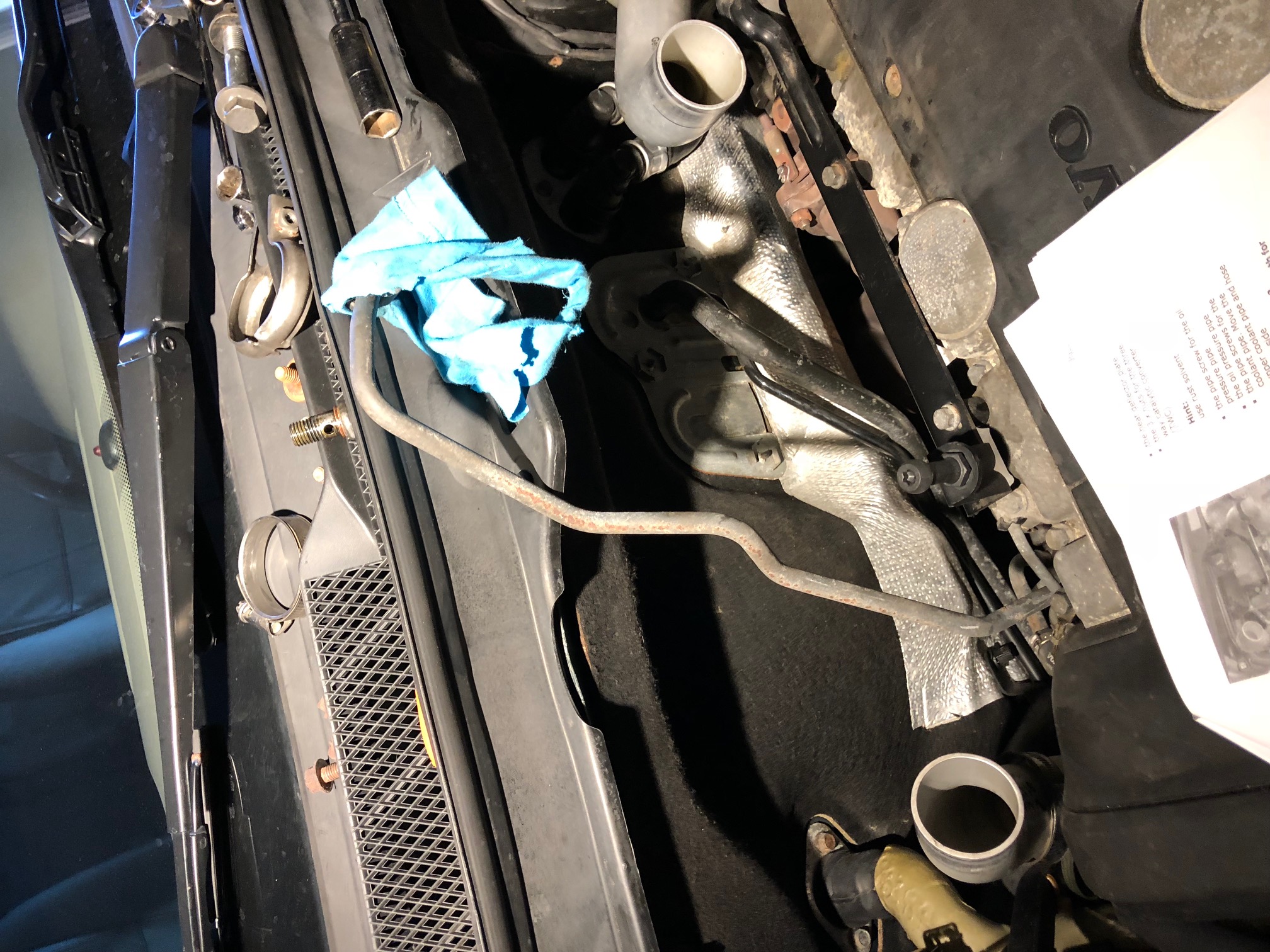

First you have to take off all the plastic plumbing and air filter box. Take out the two O2 sensors (mark them Bank 1 and Bank 2 for reassembly – tip during reassembly spin the O2 sensor wires counter clockwise before starting to tighten so that when tightened the wires end up straight or disconnect them from their harness) I would recommend using a Sharpie or other marking device to draw a mark line on the Al plumbing/to plastic so that when you reassemble you know where things sit alignment wise and how deep the Al (Al=aluminum) pipes have to be seated in to the plastic runner. You could do the same where the AL pipes mate to the turbos. This will aid in making sure the Al pipes are properly positioned when the clamps are tightened during reassembly. Recall that the AL pipes have to go back into the plastic runners – if they are not aligned they will not go in. You can final tighten the Al pipe to turbo connections once the plastic pipes are refitted. This will help in alignment of the Al pipes.
Start by taking out the lower coolant pipe (line) going into the back of the turbo, it is a T50 (the bottom one). The line faces the firewall and I used an 8mm fixed spanner on my 3/8” T50 as space is limited. This should be done first as it allows the heat shield to be removed without bending it. If you drained the coolant you will have minimal coolant loss (drops). Have a rag handy. The coolant line can then by flipped up vertical and held in place with the VIN tag that is notched out. Then take off the heat shield and remove.
Here you can see the coolant line flipped up and the heat shield removed. Bank 2 Inlet pipe is still attached, the two Al outlet pipes are removed. I never removed Bank 1 inlet pipe as my problem was with the Bank 2 turbo.

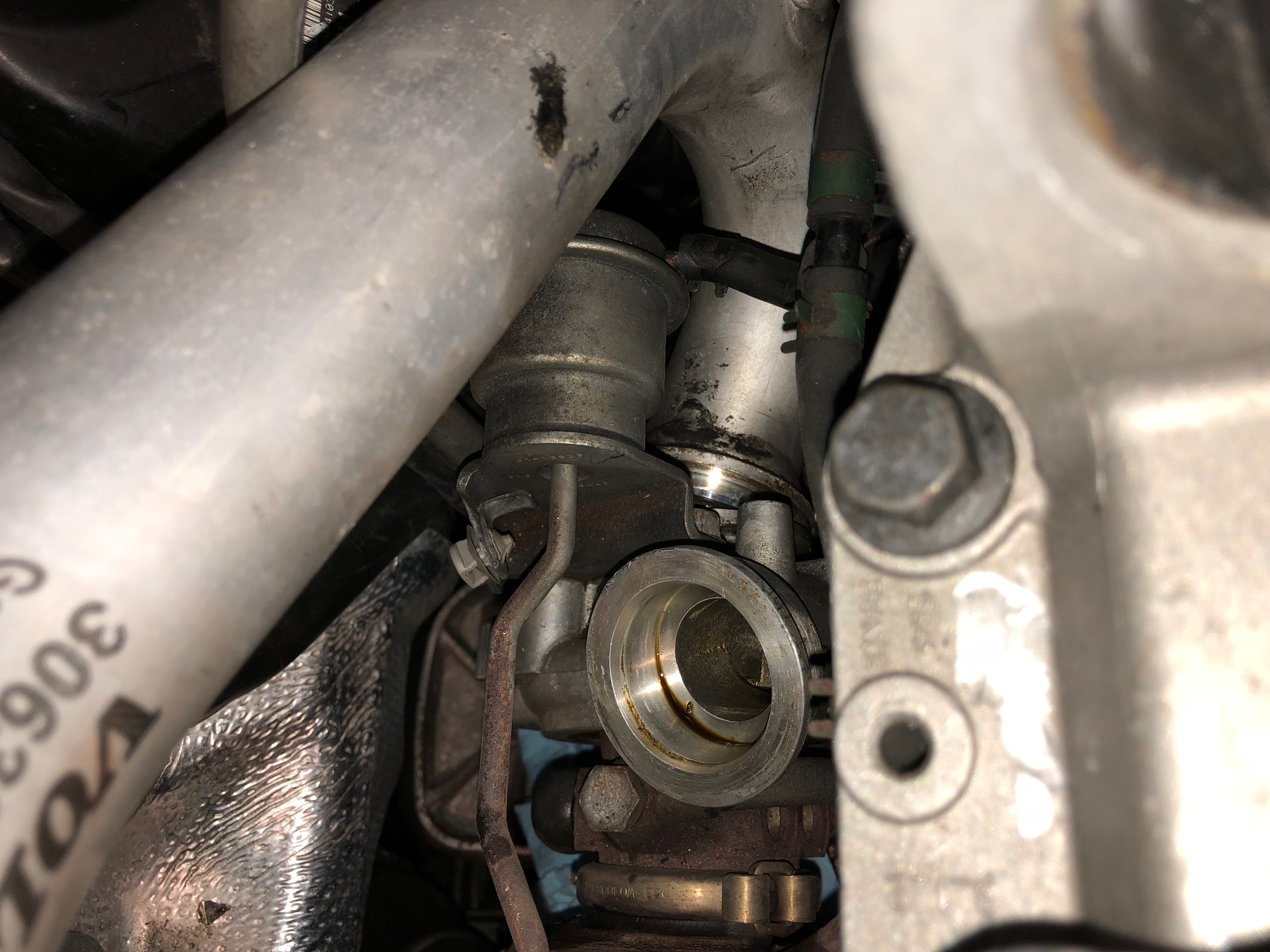

On the Bank 2 Al inlet pipe I was not able to remove it as the turbo waste gate diaphragm assembly was in the way. I found it easiest to move said pipe aside, remove the two turbo waste gate diaphragm assembly bolts, pull the cotter pin for the waste gate and take out said assembly. I removed these by using the space opened up by removing the air-box and using a swivel 10mm and some extensions coming in near the ABS block. The small rubber hose going into said assembly also has to be removed before pulling out said assembly. You can start with this or do it at the end. After this the Bank 2 Al inlet pipe will come out easy. It is entirely possible that the clamps and hoses on your car are positioned so access is easy – on mine they were not. Again if they are – mark them so you can put it back together with the same ease.
Here you can see how I have Bank 2 inlet pipe partially off so that I can move it to gain access to the waste gate diaphragm. You can also see the small hose that goes into the waste gate diaphragm that needs to be removed. The diaphragm is attached to the turbo with two 12mm bolts if I recall the size correctly. Swivel and extension is what I used to remove them.

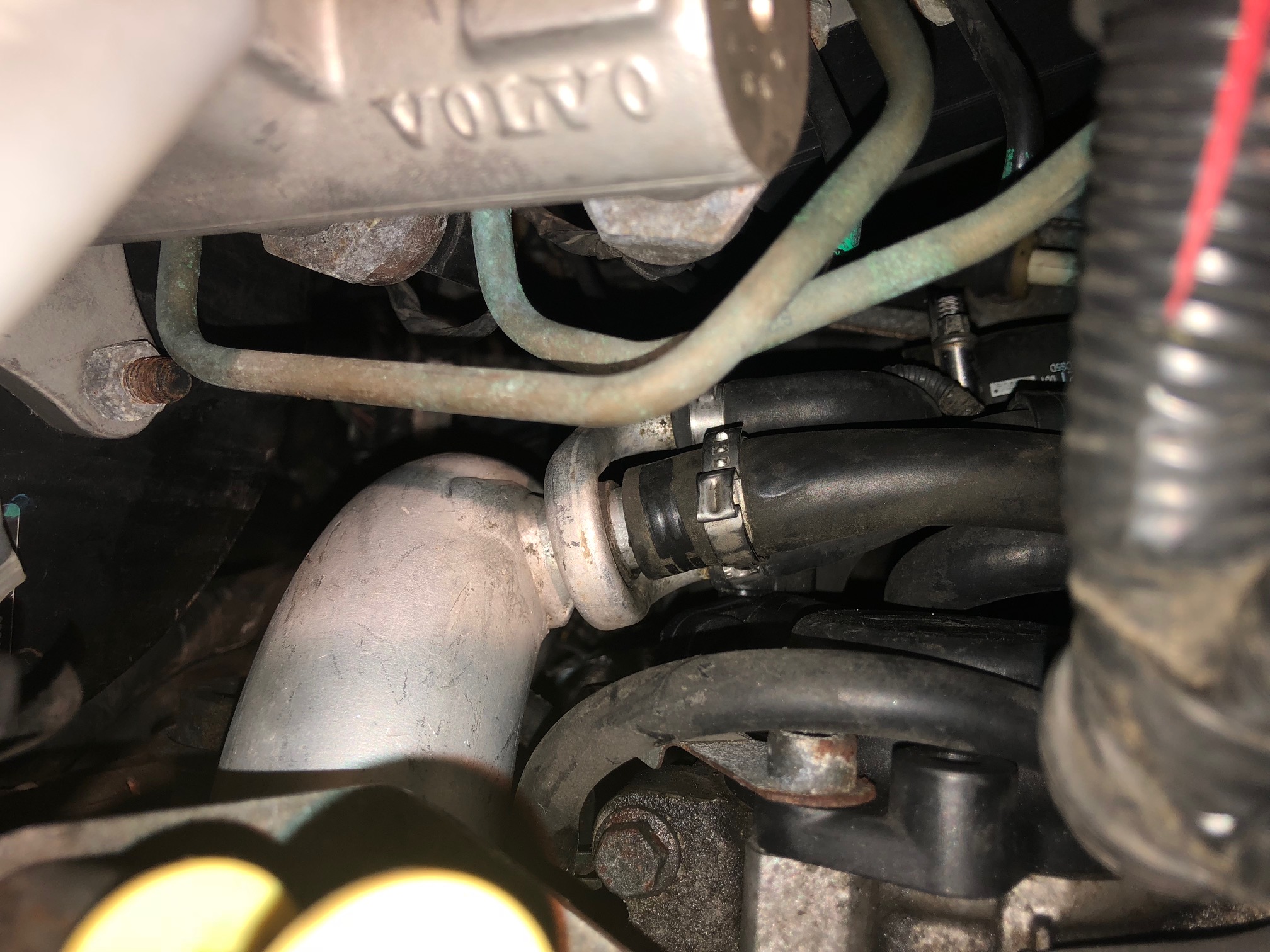

Note here – I was confused on this Bank 2 Al inlet pipe. I had to pull up pictures on the internet to see what I was attacking. It is a bundle of hoses and an Al horseshoe shaped pipe that looks to be part of it. This is not the case. The horse shoe Al slides over a port on the Bank 2 Al inlet pipe. To removal start by taking off off the hose clamp on the port, pull it back, and then the horseshoe is free to slide off. You can see this in the picture.
Here you can see the Bank 2 port, rubber hose and clamp that has to be undone.

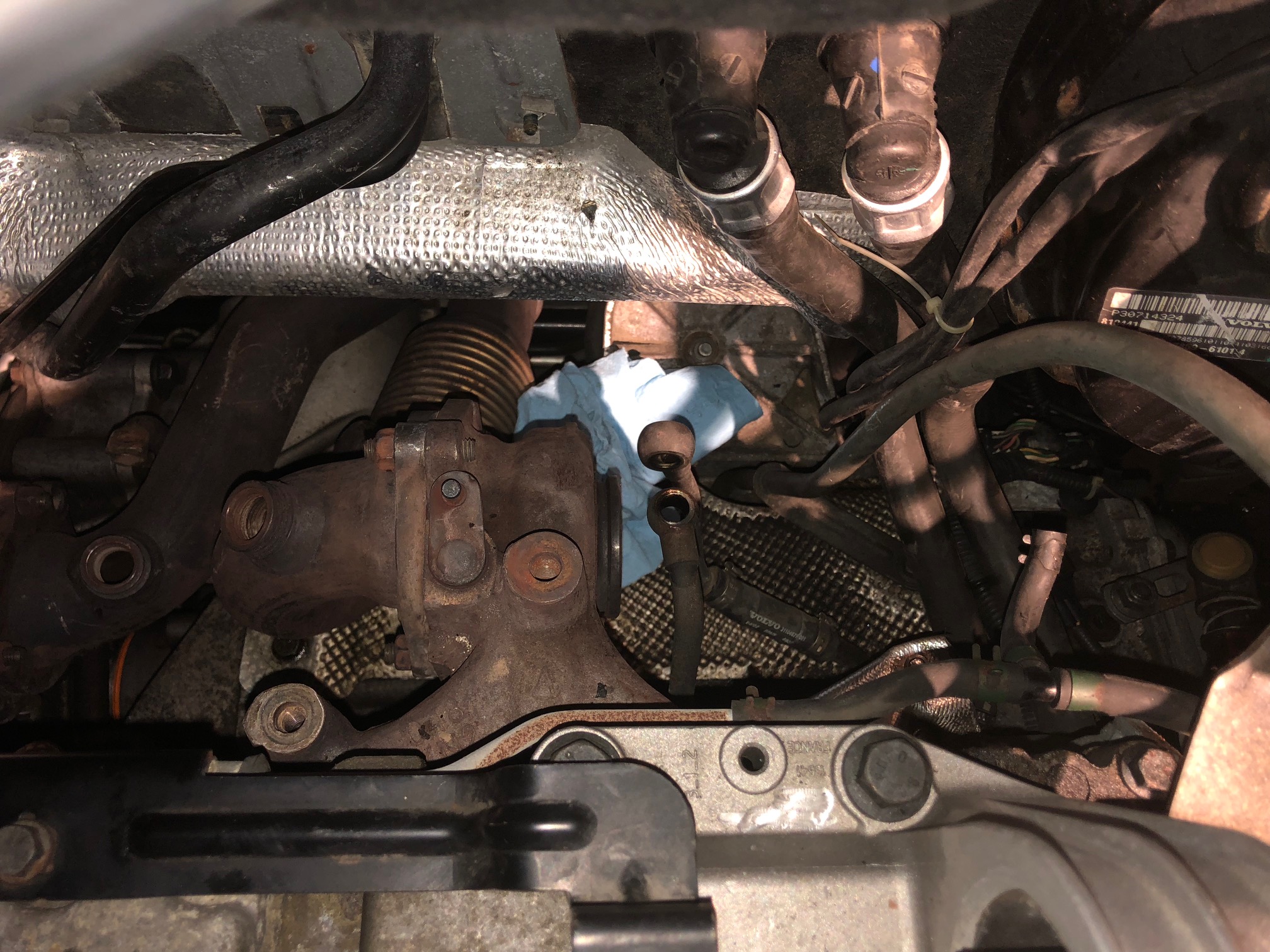

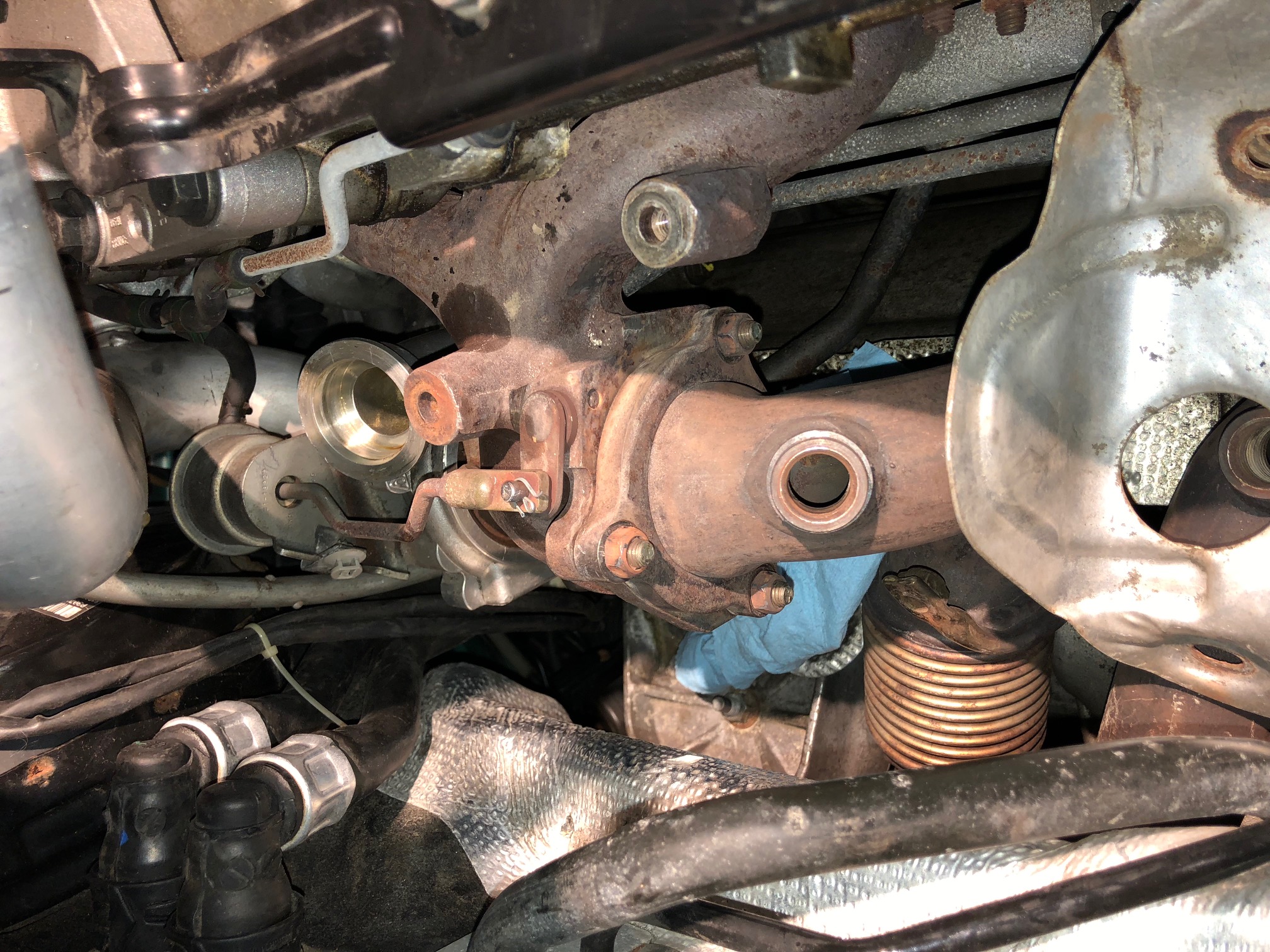

At this point you should just have the remaining lines going into the turbo to remove. The banjo bolts are T50 and the oil top oil line is 12mm. I left the lower turbo oil return line attached for removal, but not for reattachment. Remove the 8mm turbo clamp. After removal of the clamp I used a crowbar and gently pried the turbo out. I only placed the crowbar on hard iron and worked from front to back – gently and slowly. It came out with little effort. Once it is free carefully work it with your hands (up/down, left/right), remember the lower pipe is still attached and you don't want to damage the turbo fins. Once it is free you can maneuver the turbo out. The turbo oil return pipe has an oring that goes into the block – if it is not on the bottom of the pipe it is still in the block. Fish it out and if reusing put it on the pipe. To reinstall the pipe, the o-ring has to be on the pipe not in the block.
Here you can see what everything looks like when everything is removed.
Here is a view of reassembly, just before I reattached the heat shields. The coolant lines are not connected. You don't have to secure the heat shield, just put it in and slide it around. You should put the Bank 2 Al output pipe on, semi tightened before the heat shield and secure it before finally securing the heat shield.
