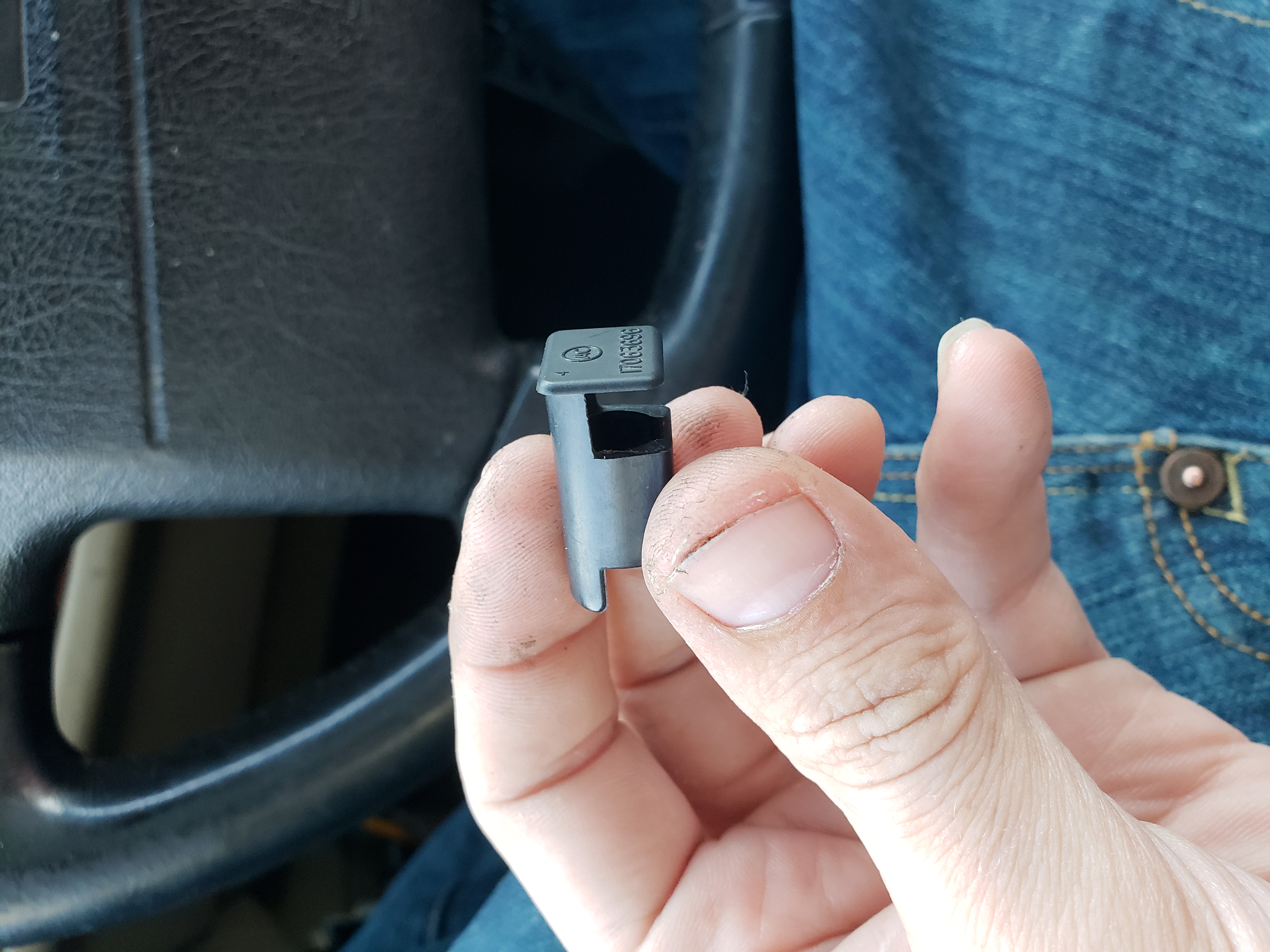

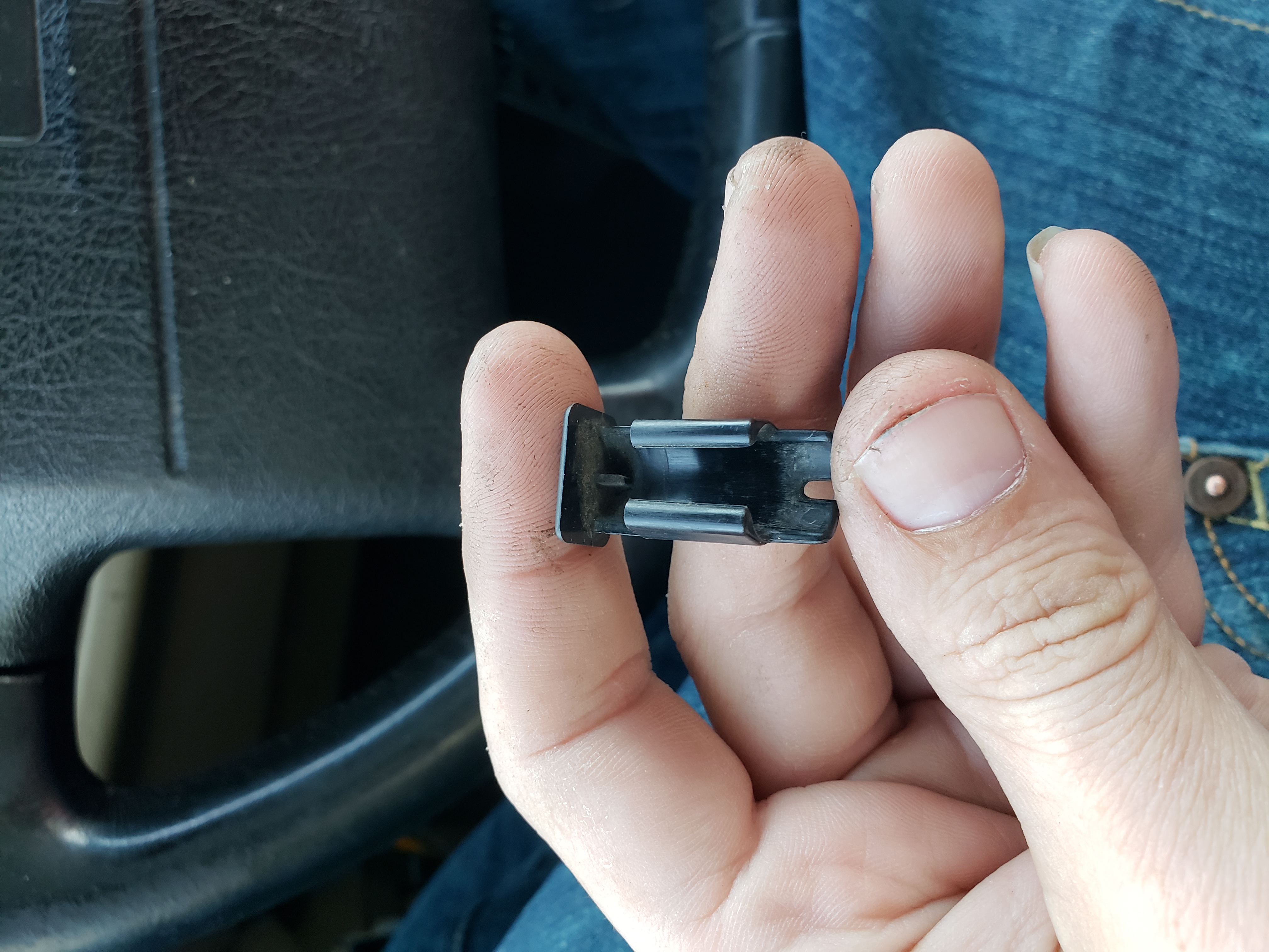

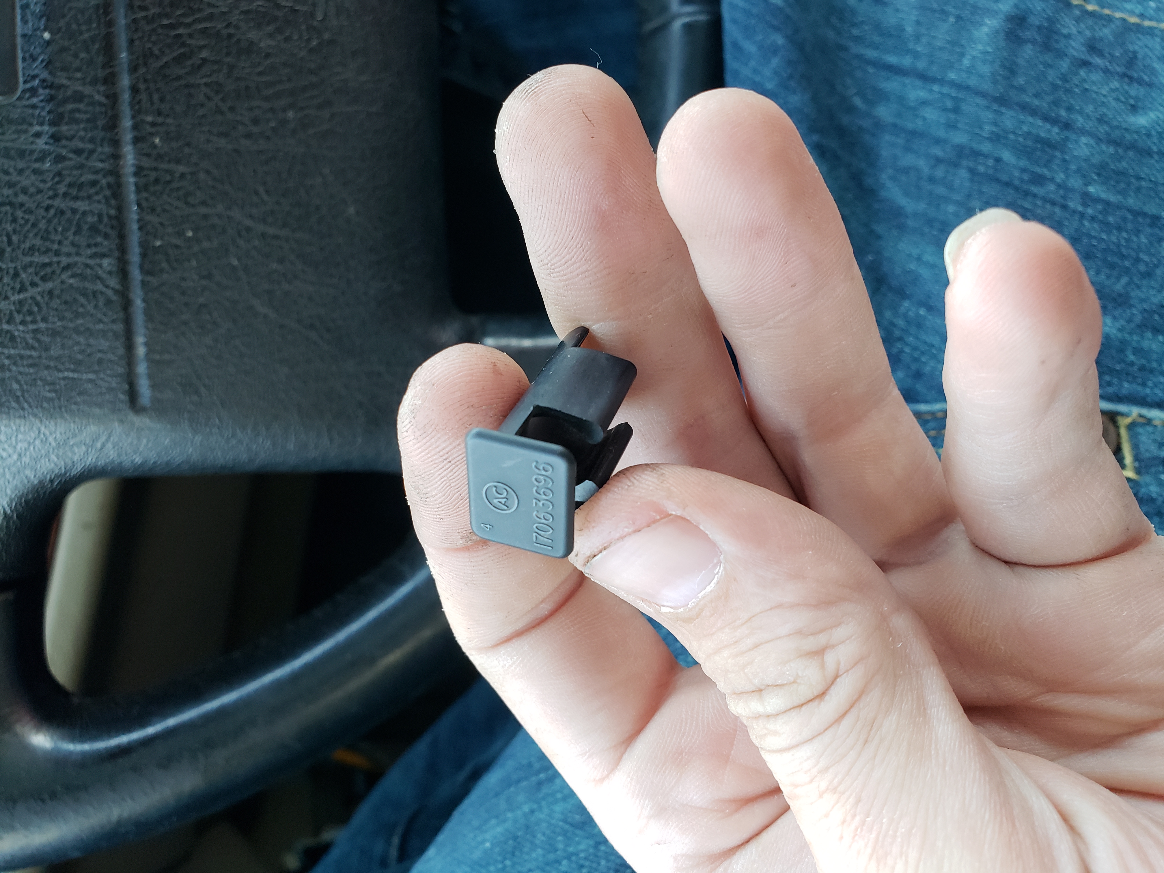

I got a 94 volvo 850 turbo and getting evap and fuel trim code. my question is this clip supposed to be letting air in or is it supposed to block it of Completely. I capped it off completely and the code hasn't returned yet. This is the cap that lets in air in the picture below, or its a vent. Does Anyone Know. And when I capped it you can see the bottom of the canister raise up and stay raised. Some kinda valve.

I put it the cap back in so now the cel is back on. I'm thinking maybe its the purge valve but the vacuum hose going from manifold to valve is really crappy but I'm not sure if its leaking I don't see any holes. Just weird how I block the nipple for the fresh air and the cel stays off.

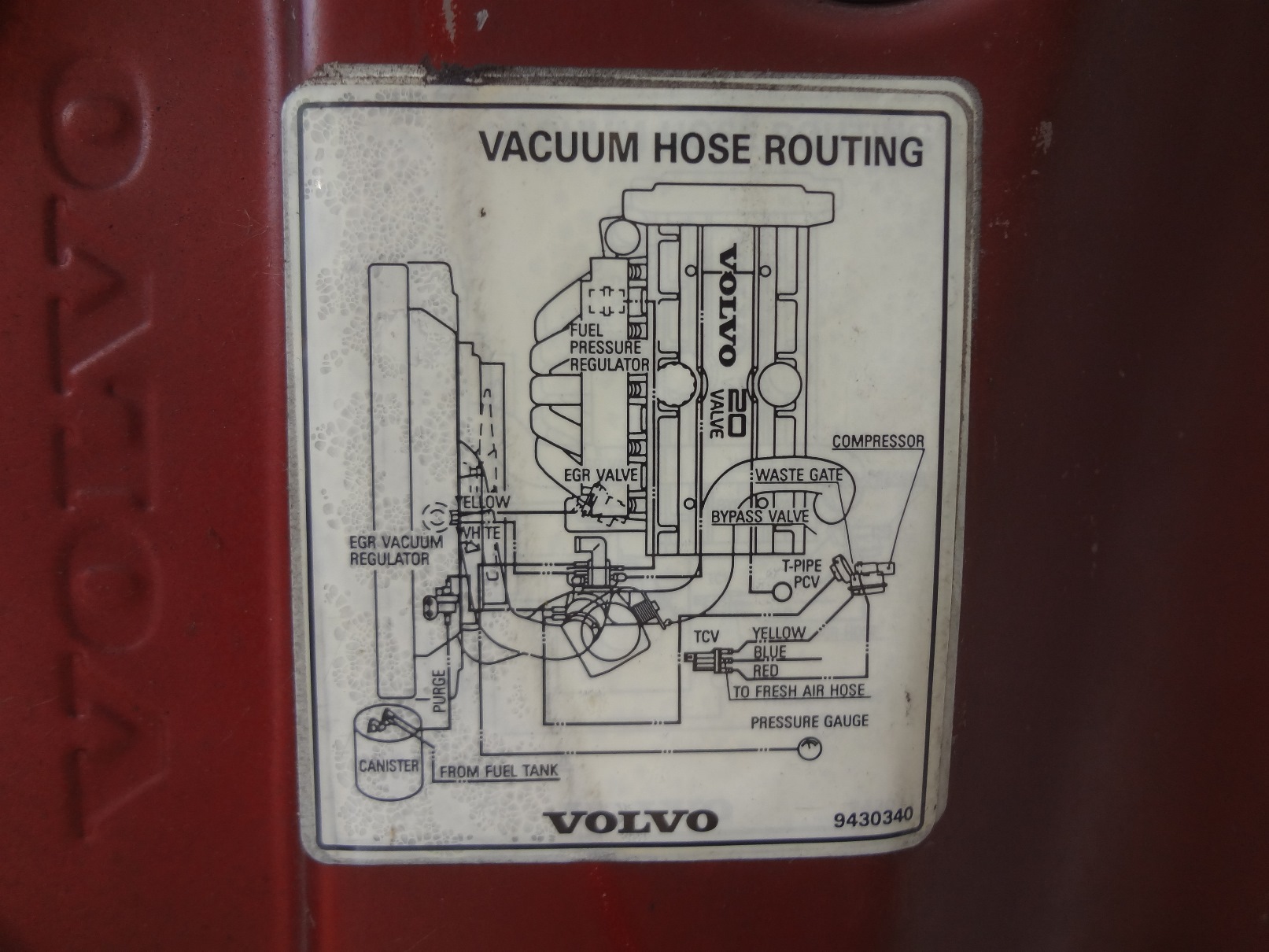

The vacuum diagram shows it with the cap on. So I guess that's the way its supposed to be. So I'll have to check the Hoses and the purge valve. The hoses are old and crappy but it could be the purge valve cause it was running fine, but then again I did just replace the radiator, so maybe I hit the lines and cracked one or something. If the canister is fine the next step would be the purge valve and the vacuum line's correct?
