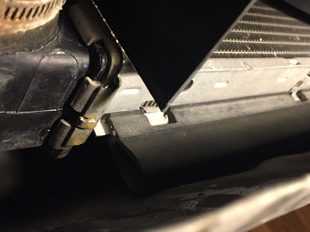

Found the source of coolant loss. Is this radiator related or hose?

I took the overhaul approach and replaced the radiator, connected hoses, cooler line o'ring and snap lock. Cleansed the system with distilled water, and then refilled with new Volvo fluid (blackburn method).
cn90 design 6" wooden ramps gave ample clearance for the rad to download and then upload. Volvo rerouted condenser fittings, it made the fan + radiators move in and out with relative ease.
The impact member mounted to the subframe takes some gentle wiggle to remove after the bolts are off. I used pry bar and let it rest over the subframe while freeing the other side -- heavy. Install method is like inserting mouthguard -- from front.
I like Volvo's guide pin-screw feature for radiator's upright positioning. A fun, no-rush weekend task.
ONLY VOLVO PARTS WERE USED.
Thank you!
