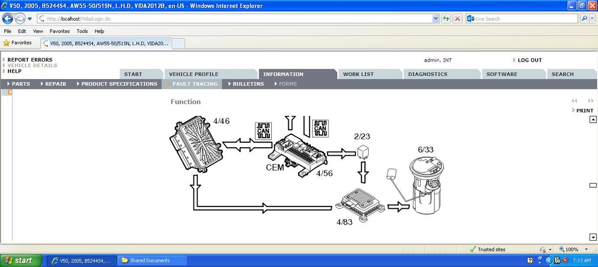

From Vida: "The central electronic module (CEM) (4/56) receives a request from the engine control module (ECM) (4/46) via the control area network (CAN) to start the fuel pump (FP). The central electronic module (CEM) then activates the relay (2/23) which supplies the fuel pump unit (4/83) with power, which in turn powers the fuel pump (FP) (6/33)."

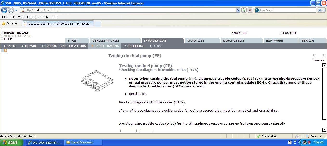

Get a copy of Vida and work through the test procedures as below (this is only the 1st screenshot)

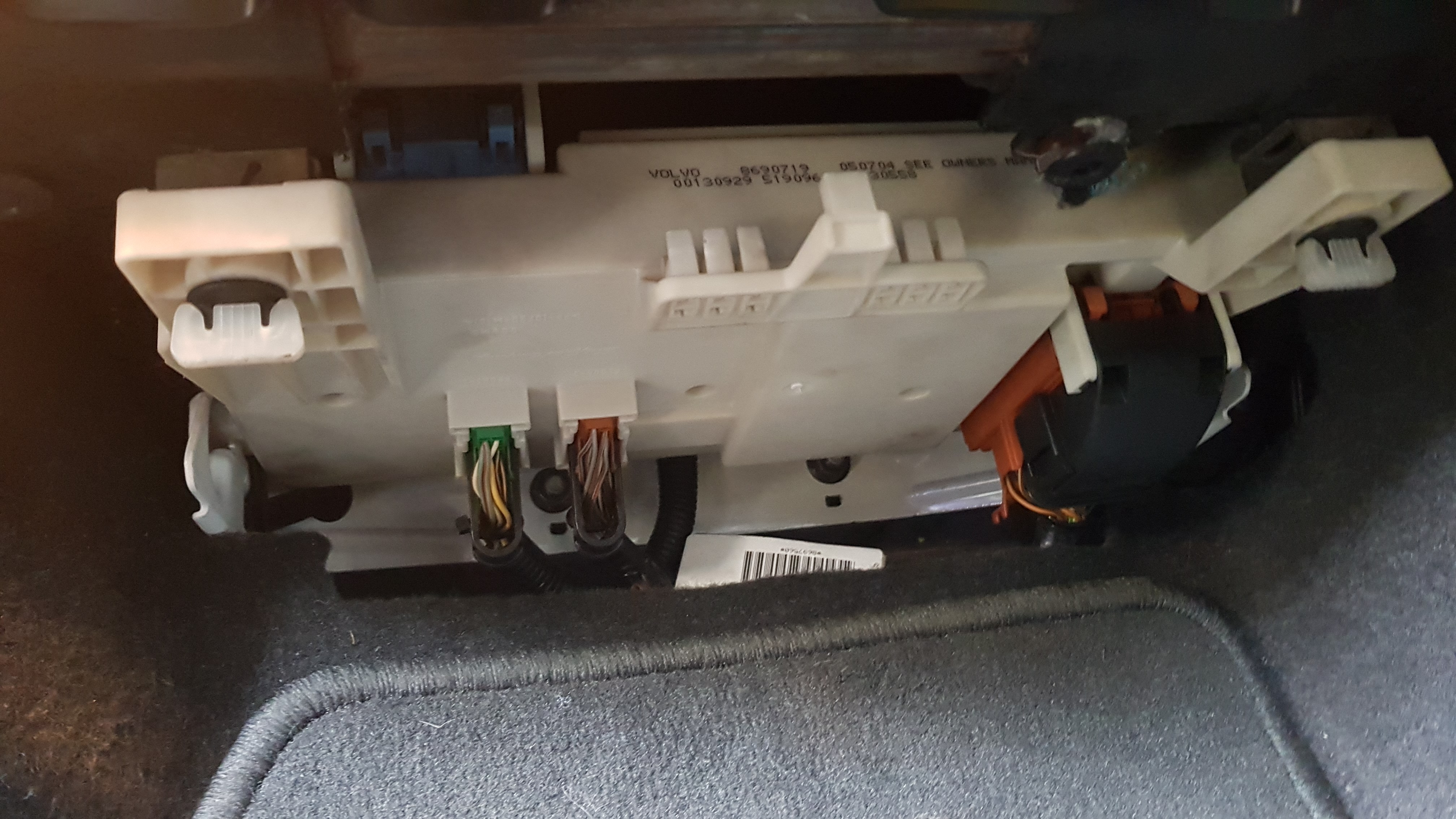

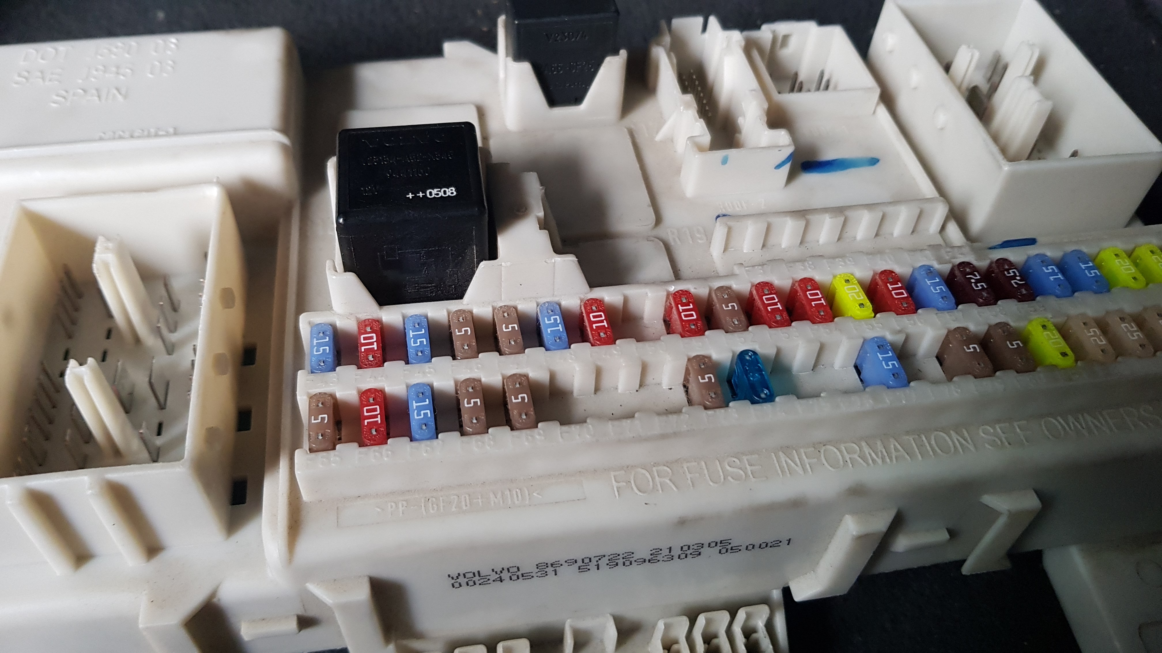

On the CEM under the glovebox (you can remove a felt cover to acess it) is a fuel pump relay. Swap it with one of the other black relays in the engine bay.
On the other side of the pictured CEM is the fuel relay. You can jump pin 30 and 87 where they plug in on the CEM to see if the fuel system regains pressure
Yagger and I just swapped out a CEM on a V50 and chased afew gremlins down.....lots of fun :D

Hey precopster... I appreciate the photos.. helps a lot. I was under the impression that the cem was under the hood and the panel under the glove box was a relay/ fuse box.( Unless they are both called that) I'll try your suggestions and let you know what I come up with.... thanks again...MDK

Post by precopster »
No some relays and fuses under the "hood" near the battery and CEM under the glovebox.
The white plastic encases quite a complex piece of circuitry worth around $500 at dealers. BTW if it is the CEM or cemetery?? as you call it that's faulty you'll need to have one programmed at the dealer or cloned by an independant.
The photo I took of the side with the fuel relay has vacant connectors because that's the CEM we removed from the car.
