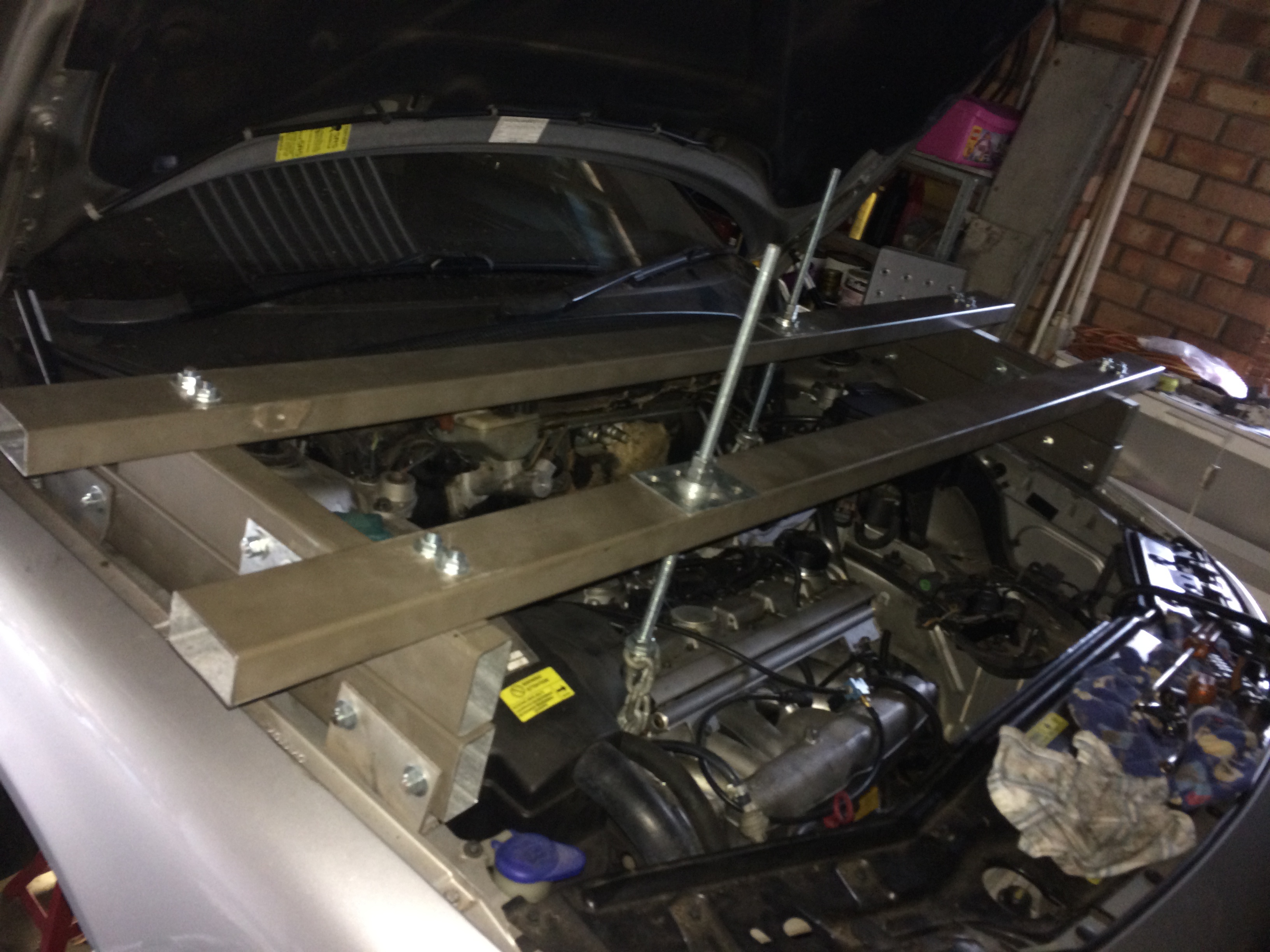

The easiest way short of removing the engine would be to get an engine support brace that straddles the strut towers (or an engine crane). Support the engine/transmission from above. Lower the subframe. Remove the pan.
I haven't done it yet, but I can't see you having to lower the subframe enough to require anything more than undoing the ball joints. Even then, that might not be required either.

2000 S80 T6
Nice rig - thanks for the photo! It helps.
